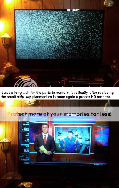

So, over the past few days, I gained a few more dots for a total of 5. My DMD chip was replaced today for free. Looks great. Everything in focus.
Checked original lamp hours: 8337! This TV was purchased exactly 3yrs ago this month. I have been babying the lamp by minimizing on/off cycles, or periods of ON time less than 30/60mins. Also, I never turn the lamp back on until the fan stops cooling it after shutdown, and usually at least 5 mins past that. Of course, I have my trusty APC BR800BLK Back-UPS to ensure that the lamp never gets abruptly powered down without proper cooling down cycle.
