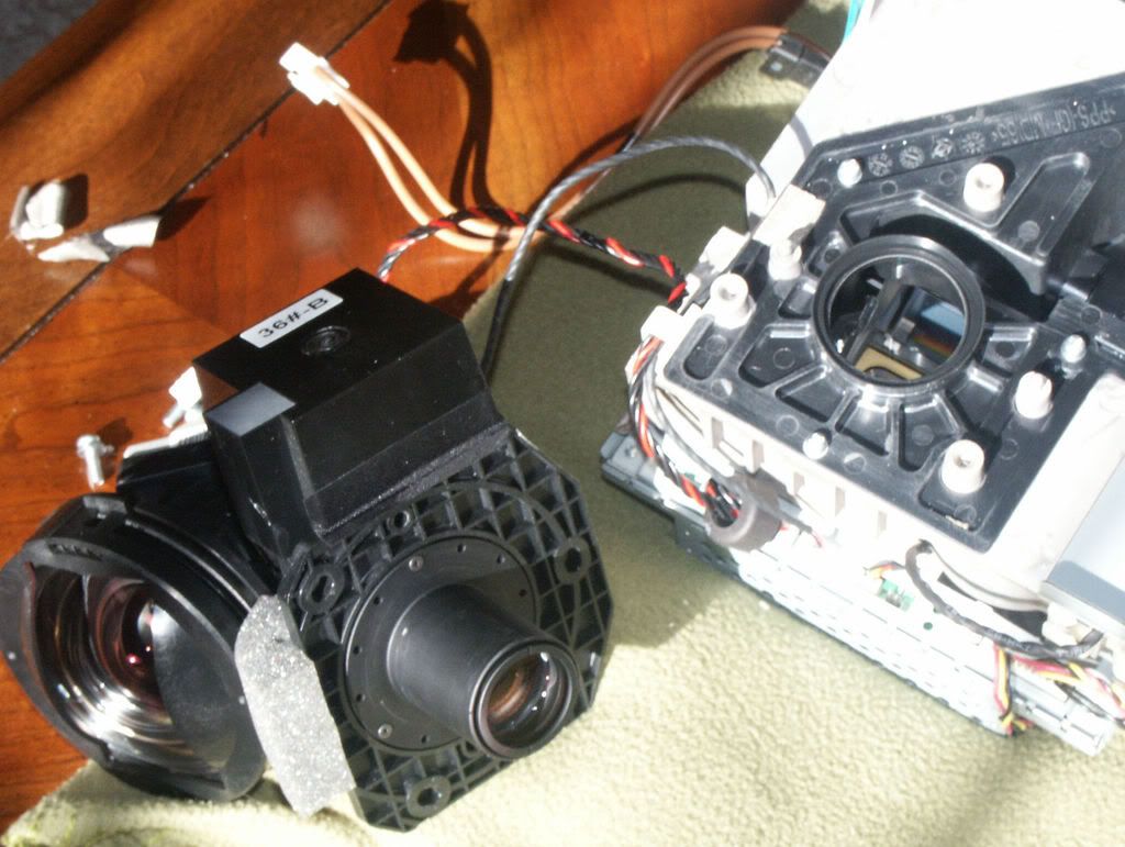

Thanks all the way VideoBruce,
I have one more problem.
I used a compressed air cleaner duster to blow on the Dlp chip and the Prism Lance over it (has also small mirror in it), In case if I have got some dust particuls in it during the process. But now I see some big particals on the inner portion of the Lance that I cannot access withour openning it and taking the lance out.
I tried the top 4-5 screws to unscrew them but cannot take off the cover assembly (Black color Plastic) which is over that Lance, may be it looks like glued or some thing. Any idea or suggestions on how to take off that cover assembly or clean that Prism lance.
Your instruction post #7 second pic.
The very next post (in bold & italics) stated not to use compressed air.
To answer your question, I would have no idea. Anyone else want to venture a guess?

Are you referring to this part of the assembly (on the right)?

[quote=videobruce;19151132]Are you referring to this part of the assembly (on the right)?
Yes! exactly the same, the one on the right (black color cover)
http://i242.photobucket.com/albums/f...ruce/16DMD.jpg
thanks

I really wouldn't think of opening that up. Try another quick shot of compressed air. I guess it wouldn't hurt.
(You don't need to use the quote function, especially w/ a image that was just above your post)
