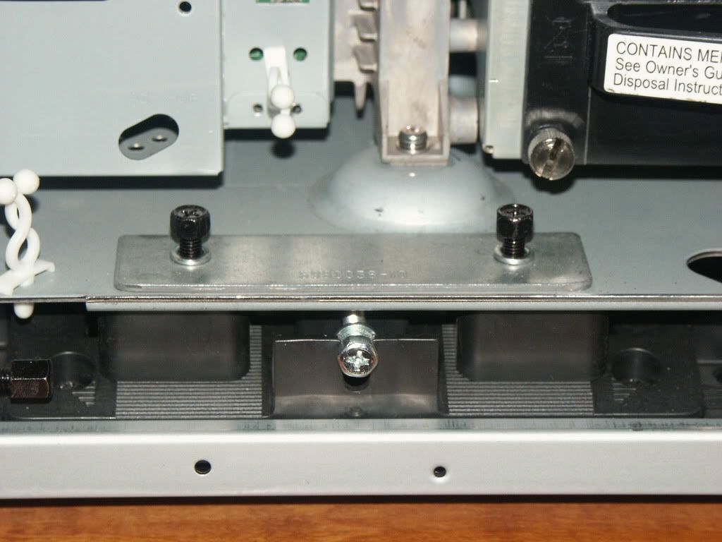

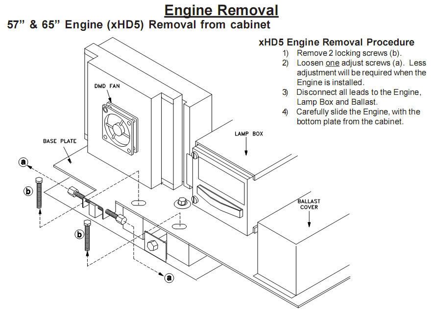

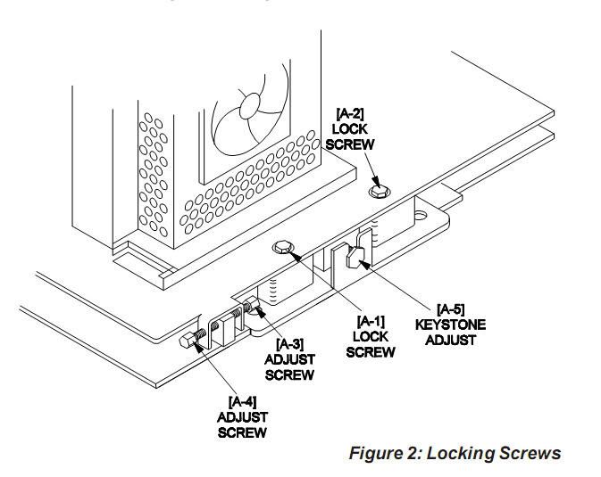

6. Remove two bolts holding base plate and remove plate, do not loosen or remove lower silver screw,
7. Loosen right side adjustment bolt below base plate, do not loosen left side,
8. Watching cables on both sides, especially the left side, slide base out from chassis,
9. Move LE to a flat, clean, well lit surface. Place a towel on the surface to prevent scratches,
Free, abundant OTA television separates this country from many others. ATSC1 has only been in force since 2009. The wireless industry has enough spectrum. Enough of 'planned obsolesce'.

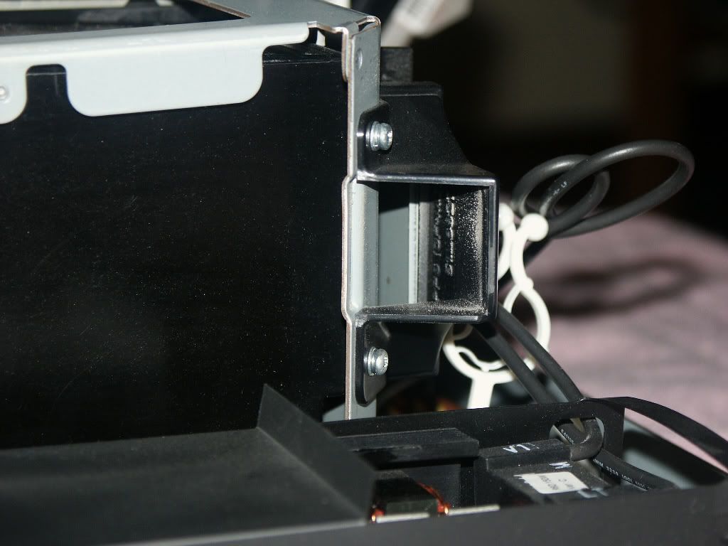

These are shots of the optical block from three sides. The problem area is deep inside this assembly. The plastic 'box' shown in the 2nd and 3rd photo is the 'iris'.

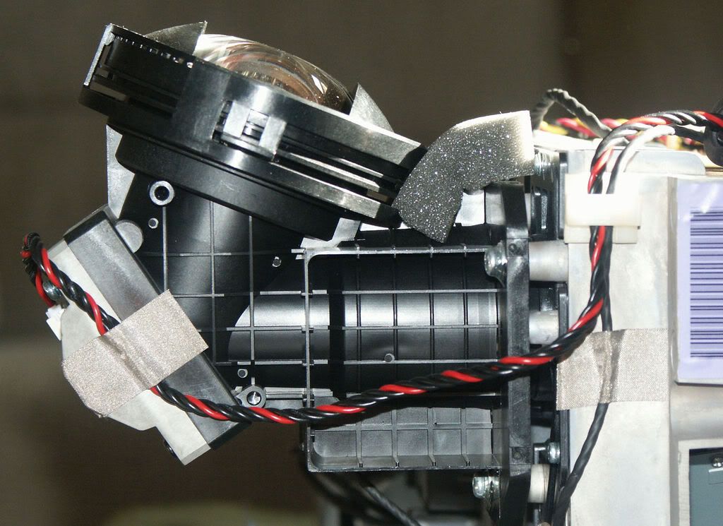

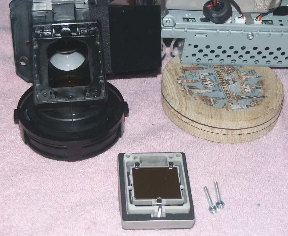

10. Rotate assembly so optical assembly is facing upwards,
11. Disconnect black & red cable. Use a small, flat screwdriver to release cable clip,
12. Remove three screws holding optical block and carefully lift straight up and out of the LE. Note, there is a long 'tube' that inserts into the base assembly,
13. Place removed assembly on table and remove the three small Philips screws (two shown) at base of this 'tube',
14. Twist and/or turn 'tube' to separate it from the rest of the assembly (jiggle if necessary). There is no gasket, it's just a tight fit. Place aside.
There is discussion regarding removing the internal mirror which I didn't do the 1st time. Below is a pic of the lens assembly & that mirror. Remove three sliver screws (not the three black) and pull the 'block' out after disconnecting the connector. I found the mirror clean and the surfaces of both lenses clean. I would advise skipping this unless you want to inspect, just in case.

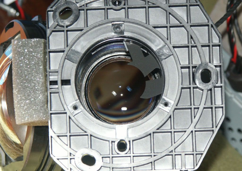

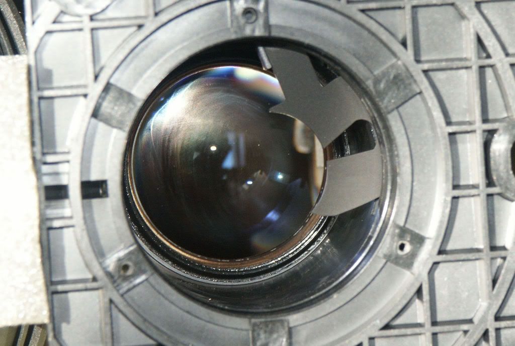

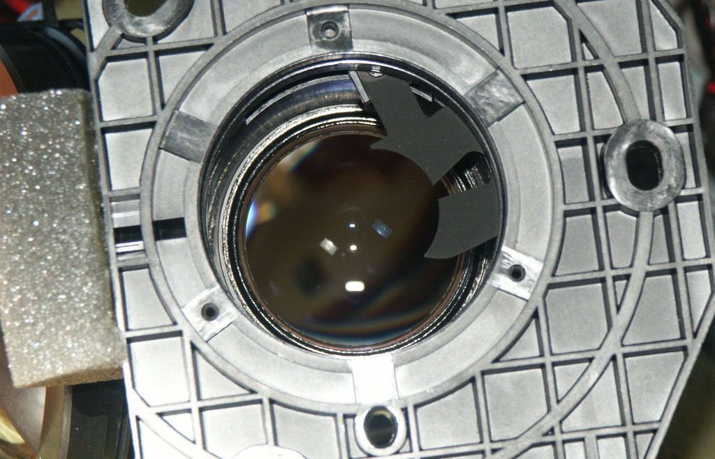

15. I used lens tissue and lens cleaning solution. I would suggest not using 'Windex' type of cleaner. Use circular motions, clean twice, let dry and look at the surface from different angles to be sure nothing is left or you didn't make new streaks. Another member suggested to remove the cover for the 'iris'. I didn't feel this was necessary. It's one more step and one more thing to go wrong. Just be aware, the 'iris' will protrude out into the opening you will have to use to clean the offending lens surface. Just be careful you don't bend or disturb this iris.
Depending on how 'bad' this surface is, this is where the problem is.
The first two shots is before and is what I saw. The haze you see at the top is not a reflection. (I was surprised how well the haze actually showed up in the photos.)
The next two shots are after:

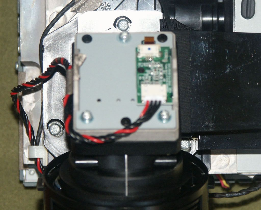

FWIW, here are a couple of side notes, First is a pic of that troublesome thermal sensor and second is the DMD chip inside the light engine.

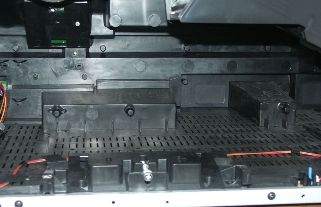

16. After your satisfied with the cleaning, reverse the steps taking note to replace the two sets of three screws holding the lens sub assemblies together,
17. Slide the LE base back into the set, noting those 'pins' at the front of the set and the location of the two bolts that hold that plate in place,
18. Reconnect all six cables and be sure they are secure and don't scrape against any metal edges or interfer with anything,

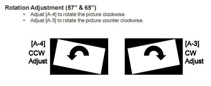

19. After your sure the base is where is is suppose to be, put a piece of tape over that switch under the right side of the base (blue lever) and power up the TV,

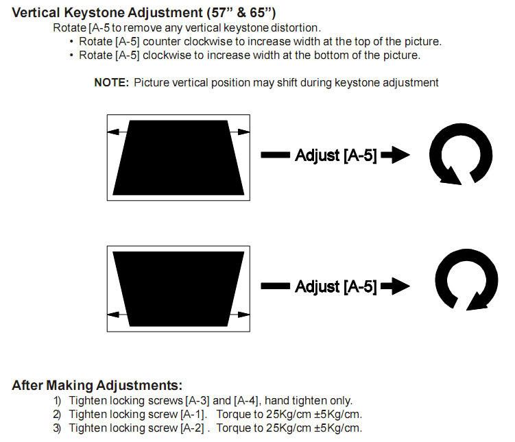

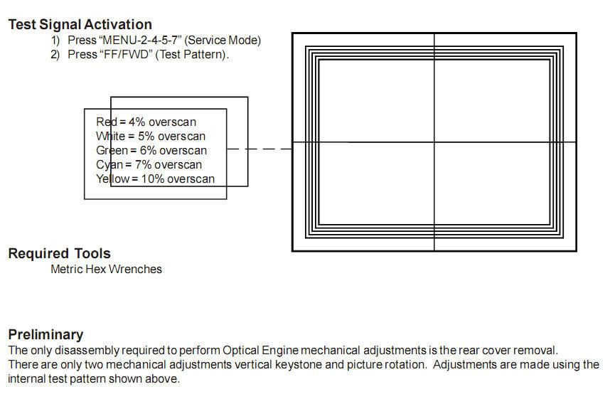

20. Check for rotation with the test pattern from the service menu: Menu-2457, then press the fast forward button (>>) on the remote. The two black adjustment screws (one of which you loosened) adjust for this,
21. If the screen is level, tighten those two bolts that hold the base in place,

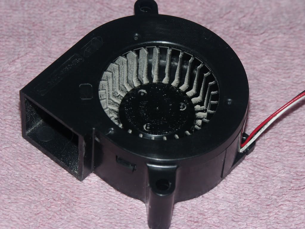

22. Now is the time to get some moistened cotton swabs and clean that rear fan. The blade tips, around the inner surface and the fins of the heat sink. You can also use a 'crevice' tool on a canister type of vaccumn cleaner if the dust buildup is excessive. Just don't use compressed air to blow the dust out.

Anyway, the amount of 'film' in my case was not that great. This was after 18 months and 2200 hours. No smokers, no kids, but three pets. TV is in a corner with a cold air return behind the set.

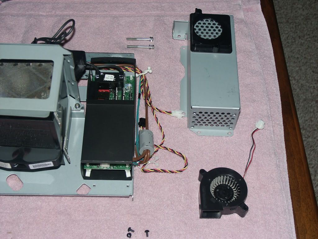

On a related subject, here are some additional; pics of the ballast assembly and fan. I found the cage fan for the ballast & lamp very dirty and removed it from the area and used a soft brush & canister vacuum to clean the dust out. I also used a wet swab and cleaned the intake to the lamp housing.
