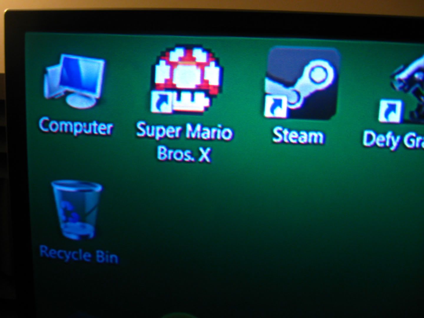

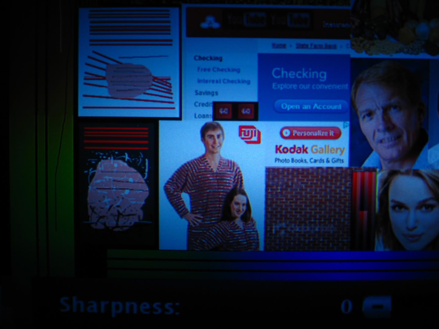

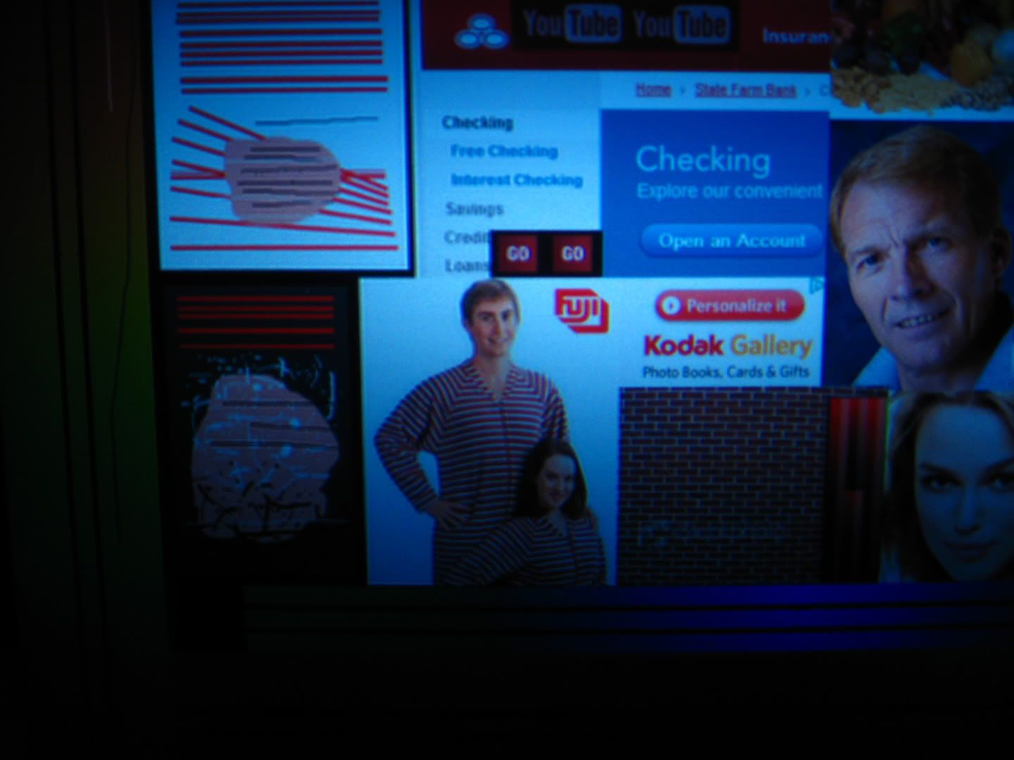

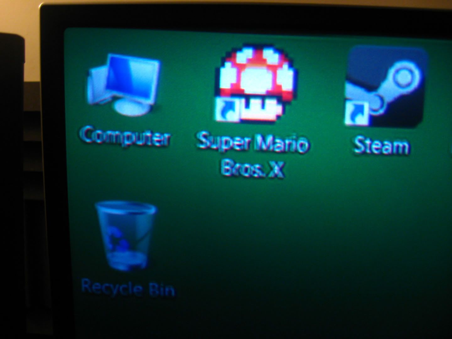

Firmware 13.06, released 3/19/2012, appears to address this issue directly.
IOW, using 13.06 appears to do the same as turning 3D Checkerboard Mode ON without some of the side effects.
More testing in progress...
For now, use these pictures to see what you are missing
without 13.06 (or 13.05 with 3D Checkerboard ON)
Originally Posted by JP32 View Post
Still image of the red/white defect... on ESPN, via HD Cox Cable box, 720p signal...
Originally Posted by jkeener71 View Post
Captain Taco,
I LOVE YOU!!!!
On my PC now, the text/fonts are clearer and sharp, the videos look better.
All by setting 3D mode with checkerboard. Why the heck didn't I ever try that!?!
Oh well I love this forum and right now, especially Captain of all Tacos!!!
Everyone, go do this now!
The defect. Sharpness at ZERO. Did you know Sharpness above 10 starts causing glowing edges? (Not shown here. The glowing edges you see here are different, and are the defect at work.)
With 3D Checkerboard ON - for a 2D picture. A clunky and dimmer workaround.
The normal picture with the defect. This is what you are seeing, though may not realize it. All sets have it.
With 3D Checkerboard ON - for a 2D picture. Boy does he look better. (Than the pic above, I mean.)
The normal picture with the defect. What you may not realize you are seeing on your set right now. All sets have the defect.
With 3D Checkerboard ON - for a 2D picture. A clunky and dimmer workaround. But boy does he look better.
