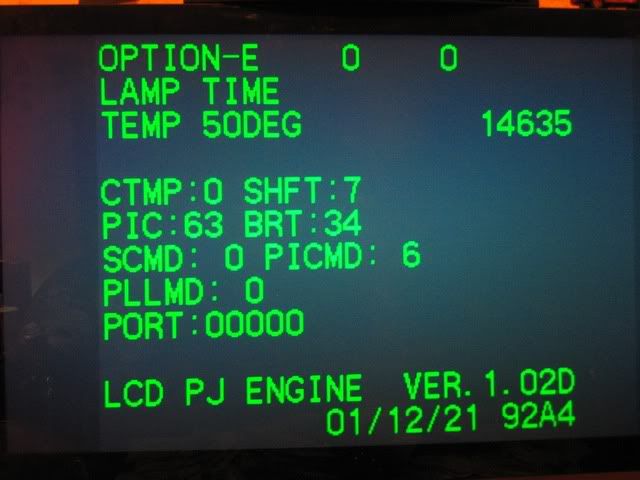

Hi fellow GWII owners. I had done the UMR tweaks long ago and about six months ago that same purple shadow to the left of black was seen on the display. It was not very noticeable until a few weeks ago. That's when I went searching. I had to change VPOS-D (under D-GMTG) from 30 to 31 and it went away. This is probably a coincident, but a few days later the lamp blew. Since I had just been in the service menu I had documented 6,848 hours. I had a replacement bulb on hand that I ordered probably 2 years ago. All I can say is WOW, the picture looks brand new again. I didn't notice how much dimmer it had gotten. It was still perfectly viewable even in daylight, but I'd say the picture is 20-30% brighter than it was just a few hours ago. Time to order a new backup bulb I suppose.
Thanks again for this thread. Without it I don't know how I would have figured out how to get rid of that reddish purple ghost from the image. (I had tried image revision in the user menu before the service menu change.)
Here's a picture of what I was seeing:

Cool, glad you found and cured the problem and thanks for documenting it here.

Right now I'm looking for
1: How to access and change V POS D. I read through several pages but cannot find a post with the total description. I may be not utilizing search correctly? I just get UMR's whole thread (50+ pages ) when I search that keyword.
2: How to access the bulb life screen (I just replaced one want to see how long the last lasted)
3: How to reset bulb hr counter.
Edit: I do not have enter SM either. I found [POWER], [DISPLAY], [5], [Vol+], [POWER]. all within 4 secs/seperatly. I just keep hot quitting my new bulb. EEK! regardless of the [POWER] fore or aft; I leave off.
I think I have found/ and printed post how to enter SM, but beyond that I cant' find details.
Thanks very much for any guidance!
Mary M S is offline
post #210 of 415 Old 03-31-2006, 05:01 PM
Couch Patato's Avatar
Location: Lakewood,Co.
Posts: 698
PM me with your e-mail addy & I'll send it to you.
As far as resetting the bulb timer here ya go.
http://www.avsforum.com/avs-vb/showt...&&#post4163950
