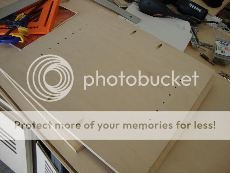

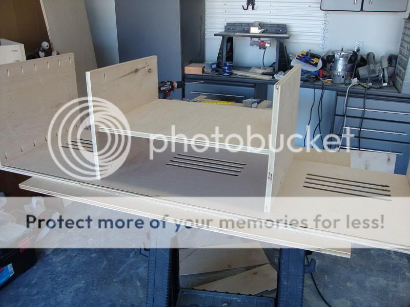

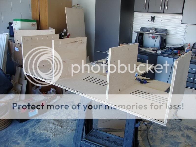

Here are some updated photos of my avion. I'll have to remake one of the adjustable shelves due to a ball bearing falling off my bit on my router when I was in the middle of using it as a template...I fixed the small problem it caused, but it's not perfect. At least you won't be able to see it and I have enough plywood to make another board quickly. I will be putting on the edging tomorrow and remake the adj shelf. After that I just gotta wait for the stain to come in the mail so I can go ahead and stain the unit before putting the top on; at least that's what sounds good to me anyways. What do you guys think? Install the top and then stain, or wait since I have everything open right now? Anyways, here are the pics.

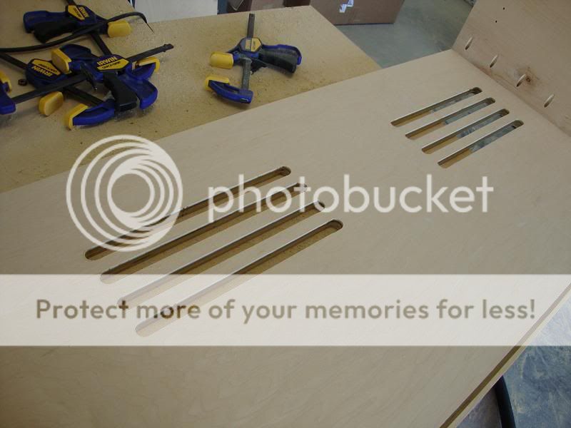

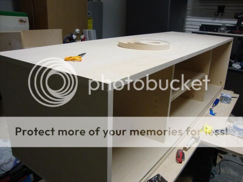

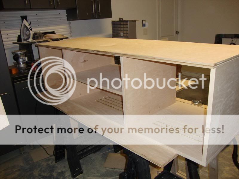

Just installed the top tonight and veneer edged 2 sides of the top. I only did 2 because I was exhausted work today and nervous about routing the groove on the top, which worked out great, but very nervous after the small problem I had with the bottom groove. I was able to get the groove exactly how I wanted and the sliding panels work great. Just need to smooth out the grooves and panels by hand with sand paper and it'll slide like silk.
Will veneer the other 2 sides tomorrow as well as the front doors. Well here are the pics so far.

Looking great, Rain.

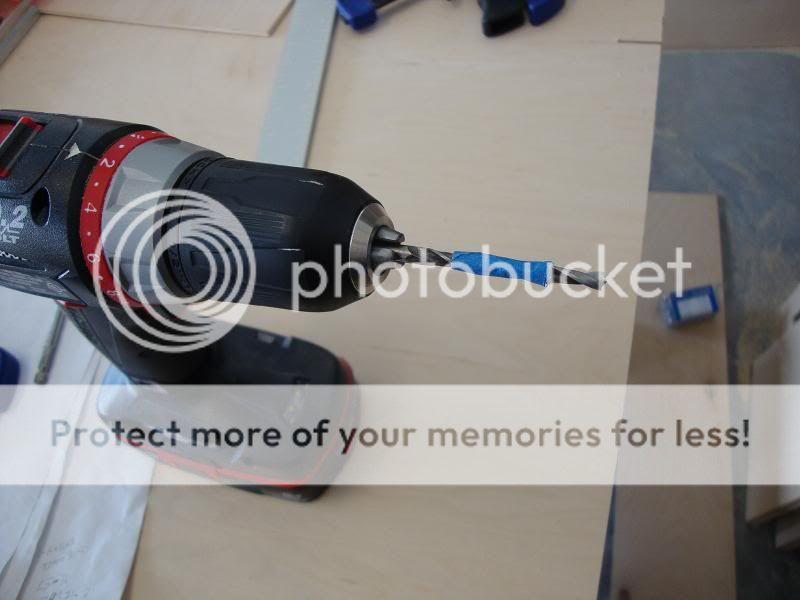

Hey all. Just an update today with no pictures. I have to vent a little because I made a mistake that I didn't know I made till it was too late. I didn't realize veneer edging could actually throw you mesaurements off enough to make you re-do the entire front panel doors... Since I'm trying to replicate the Avion, the bottom middle front door will be a drop down door. The complication is that the door has to be flush to the bottom of the unit so when you open the door, it'll actually be a flat surface. Well, the veneer actually threw off my measurements by 1/8" in total, which made it impossible to attach the top middle door to the actual drawer (it was hitting the top panel and wouldn't fit). (I couldn't trim either piece since they were already veneered and trimming it meant unbalanced look to the side doors, which are fine as is). So I spent the entire evening remaking both middle doors to accomodate the veneering difference.
Well, at least tonight I'll be pre-drilling all the holes for attaching the hinges and door hardware, veneer the 4 doors, and hopefully have enough time to test stain a test board to see what it could look like in the end.

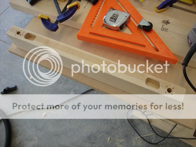

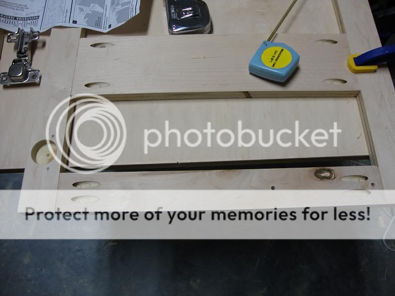

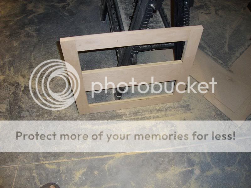

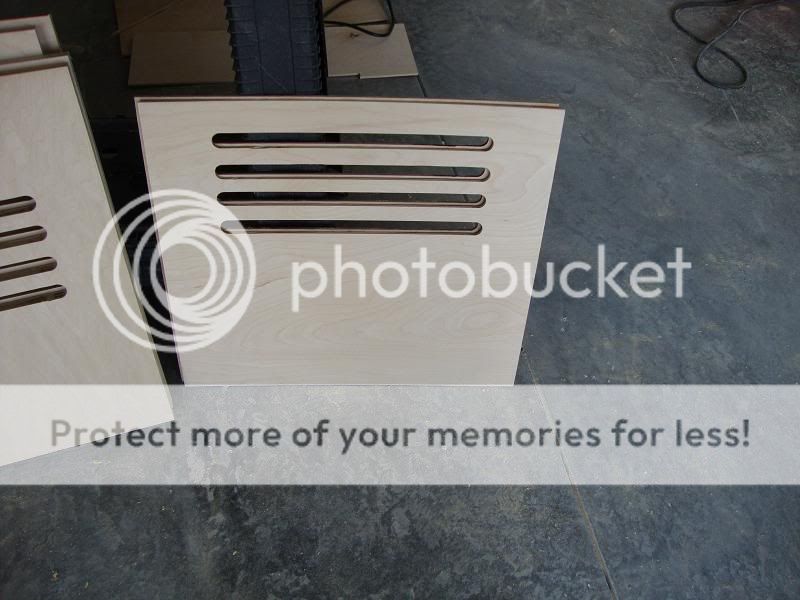

Hey all. I was able to finally make some progress. I finished the remake of the front middle doors and they fit perfectly now. I did have to trim 1/16" off both sides of the side-doors so I could veneer it and not stick out on the sides. I finally was able to begin pre-dilling the holes for the hinges and handles. As you can see, I was using a template to drill the holes and it worked great. Next objective is to finished pre-drilling the doors and cabinet for the hinges as well as the drop-flap hinge and soft-drop flap.

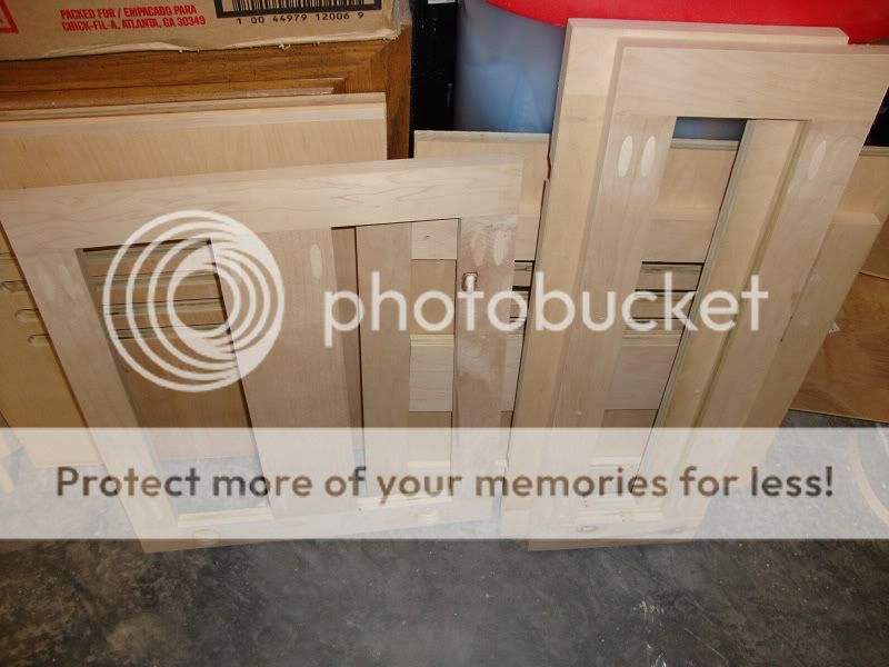

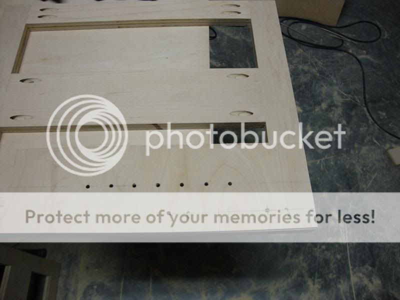

Hey all. It's been a few days, but I ran out of veneer due to my mistake earlier in the project and just realizing it near the end of the veneer. Well, I decided to make the legs and test stain a scrap panel and I need help! How do you get a flat, smooth spray paint on wood without the grain showing? Was I supposed to do something else? I definitely need help as you can see the legs didn't turn out so well. If i Just need to keep putting on multiple coats till its' smooth, then I'm o.k with that. I have time to keep putting on more. =) Now, as for the stain, I don't know if you can see it in the picture, but there's a rather LARGE round spot in the middle of the board; faint, but it's there. Do you call that splotching or is that something else? I followed the procedure of sanding my final grit, used distilled water to raise the grain, then stained after completely dry. (using Homestead Transfast Dye). If you could give me an idea of what that spot could be, I'd appreciate it. And so, here's my progress photos.

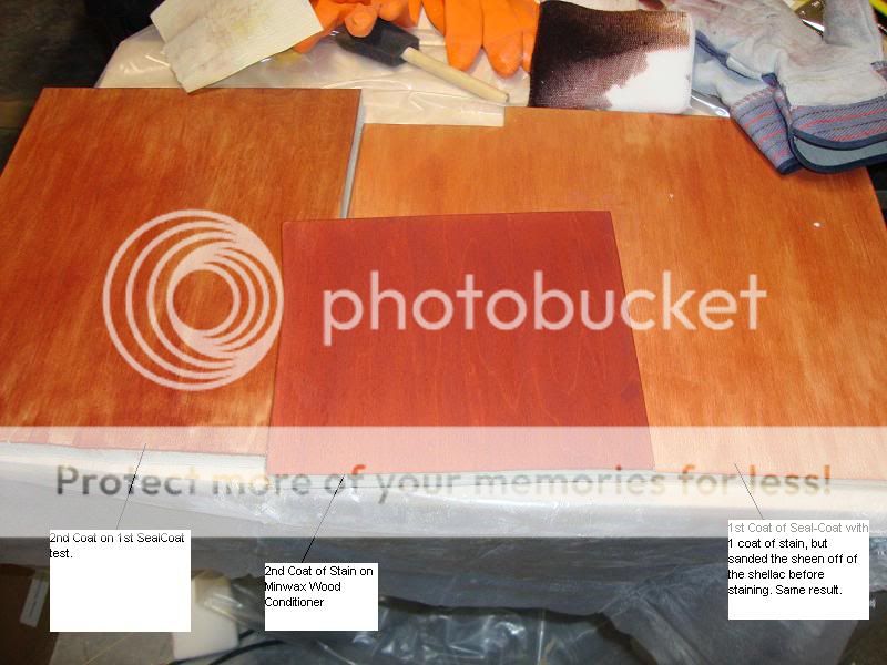

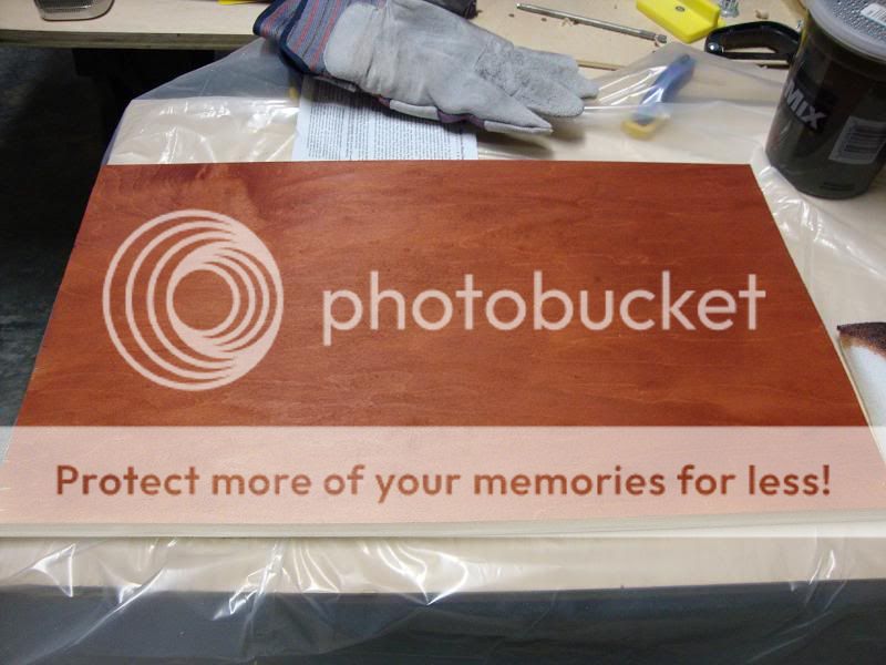

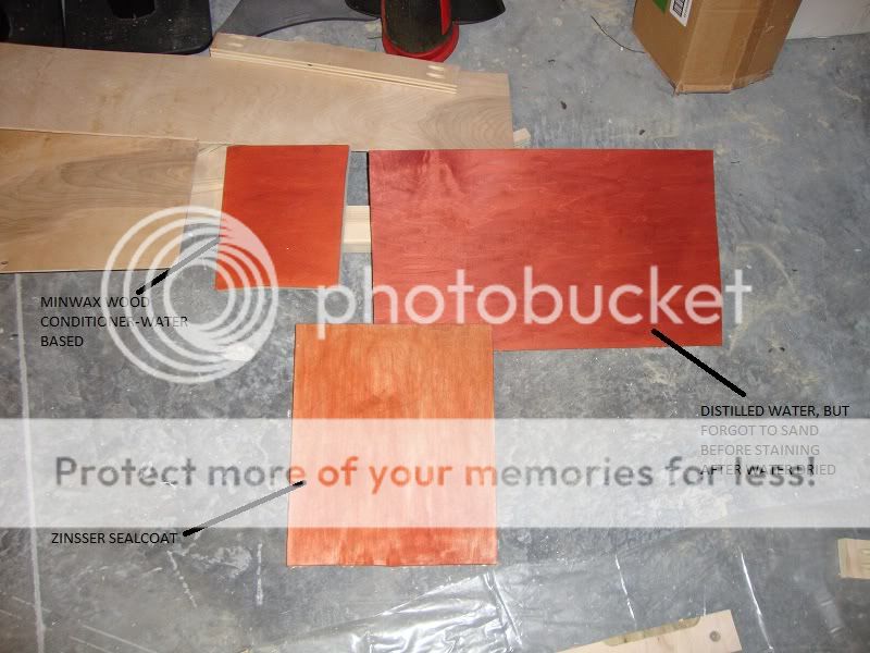

Here's another bad update on my BYO Avion. I just can't get the stain right. I bought the Zinsser Sealcoat as it is a 2# dewaxed shellac as stated in the link I got (well, not the full shellac, but it is 2# and recommended for a Polyurthane [spelling?] top-coat) and I got a very bad result as you can see. So far, it looks like the Minwax wood conditioner is doing a pretty good job, at least in photo; I can still see some blotching in the wood, but it is definitely smaller than the other 3 tests. What do you guys think? Am I doing something wrong? Am I not sanding well enough after applying the wood conditioner ? I'm using 320 grit paper after applying the seal-coat before staining. Any ideas? Or should I just go with the Minwax?
Well, beyond the staining, I was able to get the pocket holes filled with the maple pocket hole fillers. Takes a lot of work to get them to be smooth, but it looks very nice afterwards and will stain just the same after I'm done figuring out how to stain... =)
rain2 is offline

Good Morning all,
Just tried to do something different with the sealcoat this morning by sanding the sheen off of the shellac after the 15 minute drying time and then added the stain; didn't do any better than the first time around. Adding a 2nd coat of stain to the Minwax-conditioned board made it look pretty good; might put a top-coat on it to see the end-result, although it looks like it's blocking some of the grain of the wood, so I'm not sure, but we'll see.
I think I'll give the sealcoat one more shot by getting some Denatured Alchohol and follow the instructions on the can, instead of the website. It'll probably reduce the shellac to a 1# and maybe that'll help let the stain through the shellac a little better, but we'll see. I 'll try that tonight, but here's the results of my test this morning.

Are you using water or oil based stain over the shellac?

I'm using a water based Dye (Homestead Transfast Dye - Cherry).

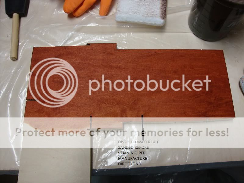

Well, I couldn't get too much done tonight, but I was able to test the 50:50 solution of denatured alchohol and Seal Coat. It definitely went on more smoothly, but still not perfect; it may be just because of the first coat, so we'll see in the morning when I put on the 2nd coat. And I also put on the top-coat on the other 3 test boards to see how they would turn out. Can't really tell right now since they aren't fully dry, so I'll find out in the morning. Hopefully all goes well, so I can finally begin staining....got a lot of work ahead of me tomorrow and hopefully I'll be to the point where all I need to do is stain. =) That would be nice. Will update then.

I may be wrong but if your using water based stain you can only use it with water based poly. I think you may want to try a base of shellac, sand, use an oil based stain(1 or more coats) then use shellac, tung oil(my choice, and I prefer satin wipe on) or poly(I prefer wipe on as well) as a finish.
Its a pain I know but when you get it right you'll realize it was worth the effort and you'll have a piece you'll be happy with for years to come. Don't get discouraged.

Well, I read in many places that using a water based poly will make the water-based stain "bleed", so all the sites I've visited stated to use an oil-based and even got recommendation from Woodcraft to use oil over water to protect the stain since they can't mix.
Now here's one thing I was thinking about on my way to work, since this is made out of plywood and the Maple portion is only 1/4" thick, will the shellac pretty much be covering the entire surface?? I know plywood and regular wood absorb stains at a much different rate with the plywood absoring much more to become darker (and possibly show more blotching)...just a thought.
As for this morning, I did add a 2nd and 3rd coat of stain on the 1:1 DNA and Seal-Coat test board. Looks 'o.k.' but still not as good as I was expecting. Maybe I'm not sanding well enough after it dries for 15 minutes? Should I be sanding as much as I was trying to sand the surface smooth before adding the shellac? I'm almost tempted to just tint the shellac with my dye (if I am able to mix) and let that be my stain, then coat with poly for top-coat. Another option is to go back to distilled water and sand VERY well after it dries, dilute my current dye to make it lighter and try that. I never imagined it would take this much work to get the stain right. It's actually worse than making the entire unit! Will try more and more tonight. Hopefully I have enough scrap wood to continue testing or I'm in trouble....

I would try an oil based stain I think that may be the problem. Sounds like your doing every other step well.
