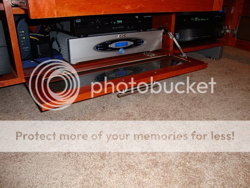

Yeah, you're telling me. =) I was giddy when I found out gravity was the culprit. =) Thanks for your suggestions.
I also just installed the soft-drop hinge this morning for the bottom-middle door so gravity can't have its' way and adds needed support when I install the glass. I didn't realize I needed vertical clearance above the actual hinge and the hinge was hitting the middle shelf, so I made an adjustment and works out nice now. Only consequence is that I have one screw hole open, but it's so small that it won't be bothersome.
Tonight, I just need to paint the door-window trim that will be visible and make the back panel and the unit should be complete.

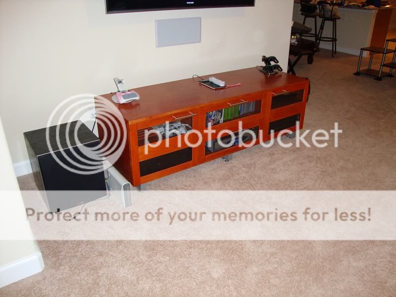

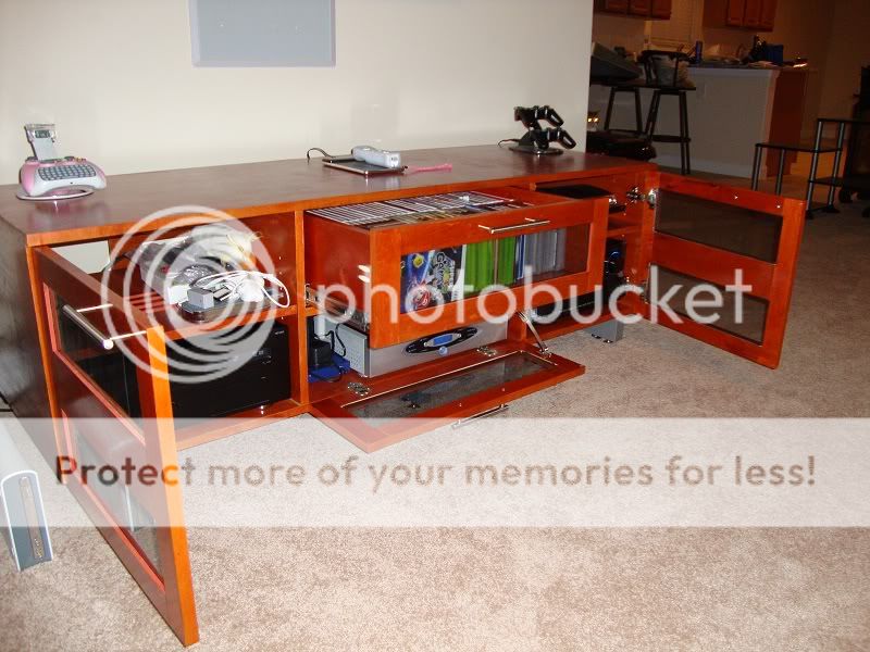

Good Morning All. I finally made the decision to move the Avion-unit to the living room and install all the equipment. So far everything seems to be working fine, but I did forget to connect the PC since I was doing this till 1 a.m. Looks like I barely had enough room for everything. The gigabit switch, cable modem, power conditioner and the cable box, along with an extra power strip all fit into the middle bottom opening. Wii and 360 gets to share a room together. Thank goodness the design called for vents since they do look cramped, but they do have enough airflow from the bottom, top, and back, so it should be good; and if all goes well, I won't need to add fans. Anyways, here are the pics of the setup. I am still missing the glass, which I hope to get next week and I will start on the back panel today, but isn't crucial to the unit since it can't be seen. Thanx for looking.
rain2 is offline
Old 06-27-2010, 10:41 AM
Servicetech571's Avatar
Posts: 4,733
Is anything going to go in the "windows" on the front or will they be left open?
Unless you live alone I wouldn't count on the top of the cabinet to stay clear very long. It's much too tempting to sit something there.

Hey all. thank you for the compliments. It was a lot of work. =) The glass did finally come in, so I did install them over the weekend and will take pictures of them tonight. I still have the back-middle panel to finish; I have it measured and ready to cut, but I've been busy with other house work that needed attention. I'll also post a reference picture as the top-middle 'window' is a drawer for storage / center speaker, if you so desire. For me, I'm using it for storage of Blu-Rays and Games. Like I said before, I tried to make it as close to the Avion design as I could, as it did everything that I want it do.
If anyone wants to build this, just let me know and I can help with the list of materials and where to get the parts.

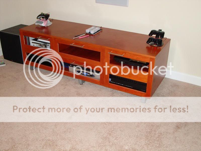

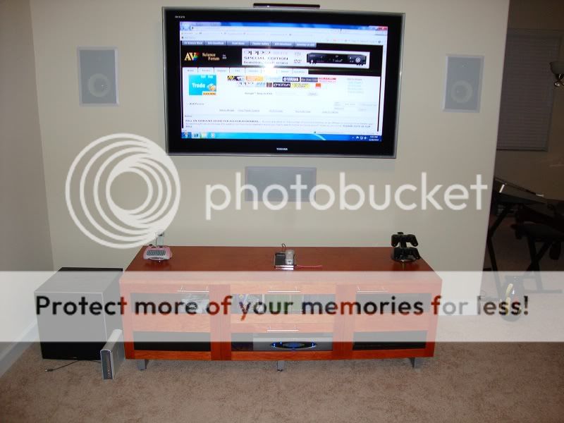

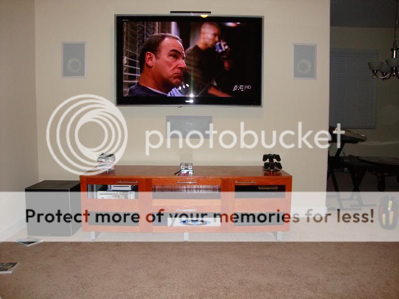

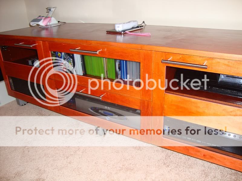

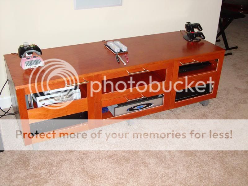

Good Evening. As promised, here are the photos of the finished unit. The first pic is the reference picture from the actual BDI Avion unit that usually goes for ~$1300 - $2000 (could be more now). The rest of the pics show the glass installed and stuff put into the drawer. =) PC working fine as you can see with the AVS Forum page on the T.V. I did find out that I can't have the Receiver and the PS3 on at the same time as the receiver heat goes directly on the PS3, so it increases the PS3's heat, which isn't good and makes the fan go crazy loud. I'll be getting an AV cooler for the receiver and possibly the PC, just for safety reasons, but we'll see. Thank you for following my first woodworking project ever and hope there will be many more. =) Now to figure out my next project....

Old 08-23-2010, 07:25 PM
fbalonis's Avatar
Posts: 7
Originally Posted by Stew4msu View Post
I don't particularly like those of you that can stain your stands.
I had to paint mine black to hide all the flaws.
Nice job.
Fortunately the flaws that weren't hidden by the stain is hidden by all the components.
My wife was behind me all the way on this build because, as you can see in picture 1 the legs of the folding table with a sheet over it that filled in as the TV stand until this was completed. She was ecstatic when I completed the stand.
fbalonis is offline
