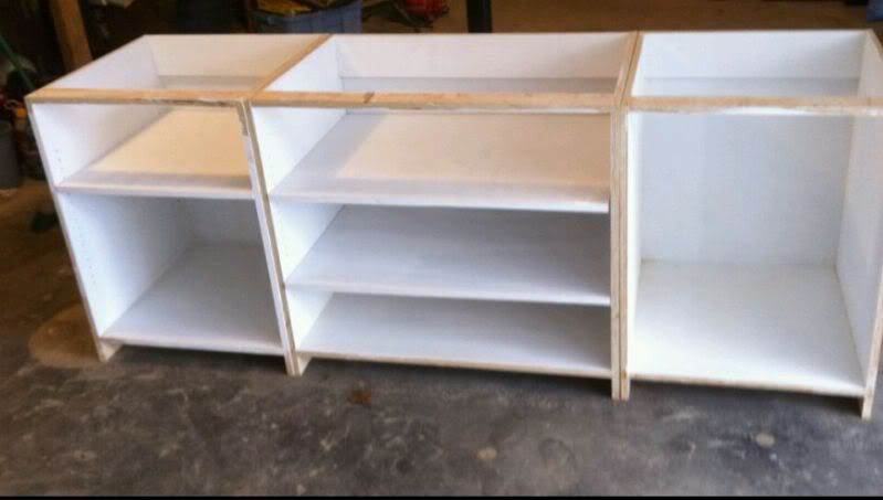

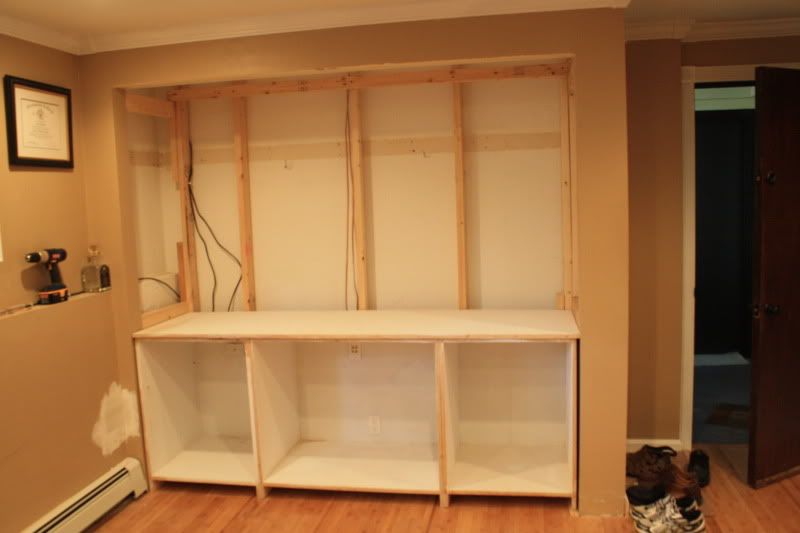

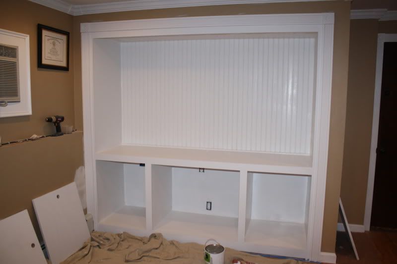

Last weekend I started on my own DIY entertainment center project it has been my first woodworking project ever I think it has turned out well so far. I was able to construct my base cabinets and give them a good prime. I plan to finish them up this weekend and start the install.
Here is a little background on my project:
I am going to be converting my closet into a built in Entertainment Center. Currently in the build stage but am planning on finishing the project over the next couple weeks.
The Entertainment center is going to be constructed of Cabinet Grade Birch plywood with a bead-board backing. I am going to use poplar for the facing and then trim it all out with some nice beaded trim so it looks built in (because I am converting a closet.
Now here is the good stuff I only took 1 pic last weekend after I finished because I didn't know about this thread but more will follow.

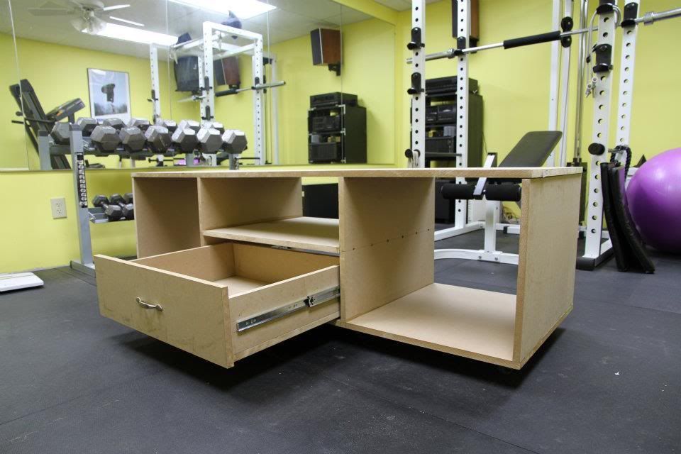

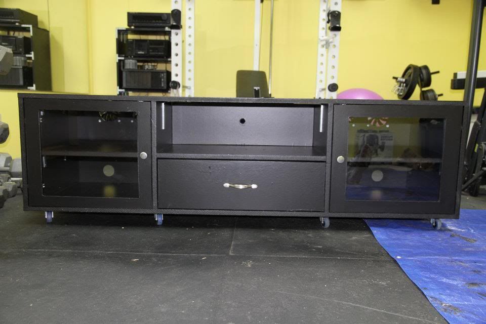

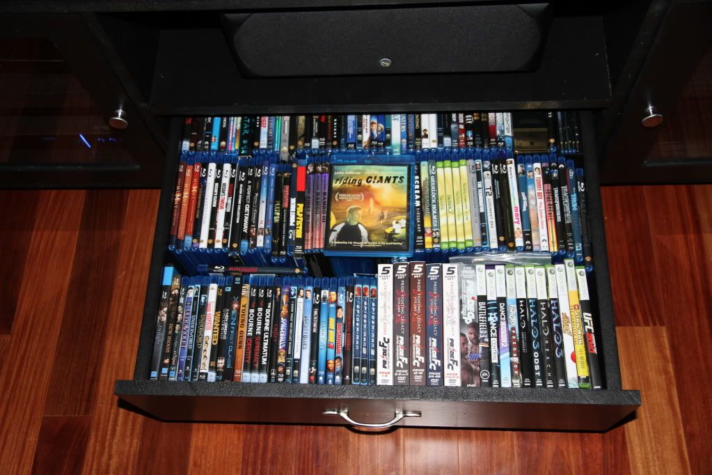

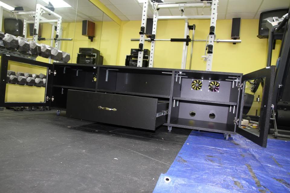

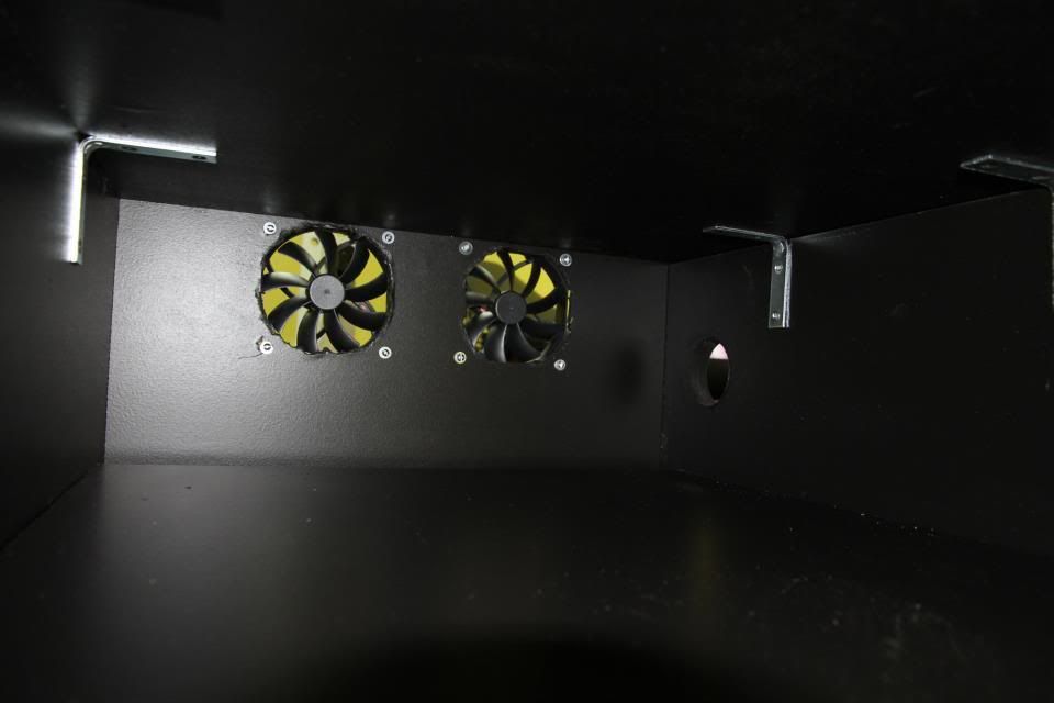

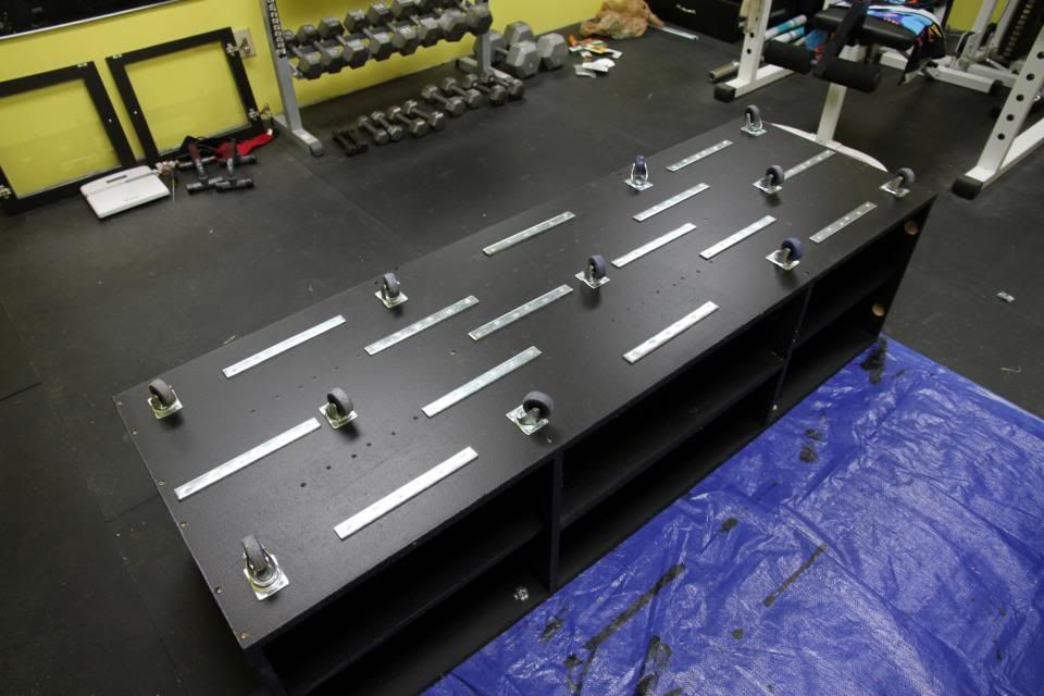

I've been lurking this thread for a while now and always looked for an excuse to build a stand...now I have a toddler that just started walking and he decided he enjoyed turning off everything under my existing tv stand, thus the justification for the project. Most important design criteria is cabinet doors.

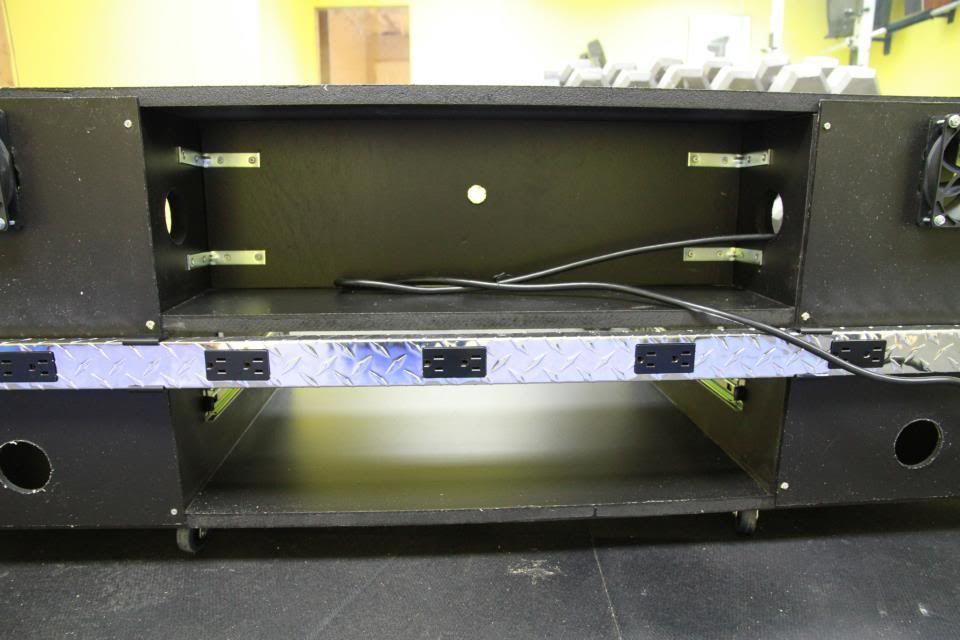

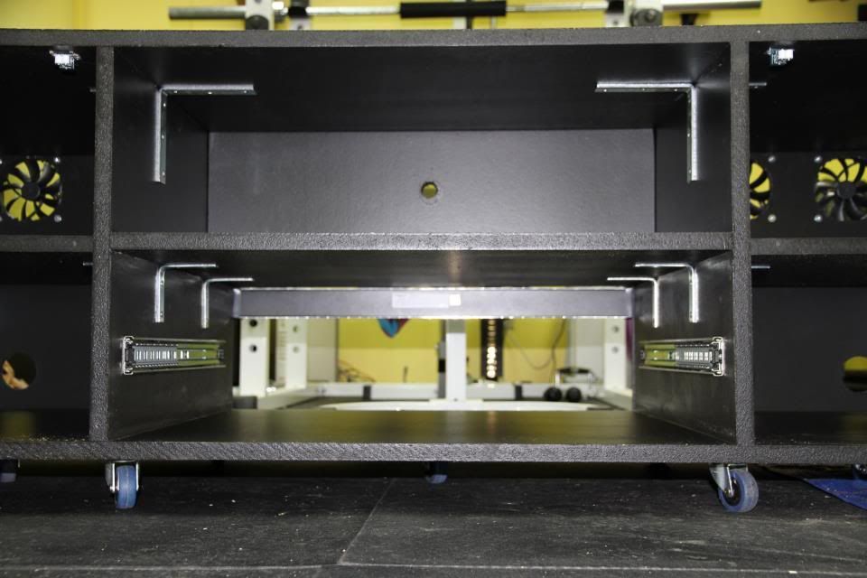

All major material purchased at a big box home improvement store. Case fans ordered from NewEgg. Drive out price on all items including a gallon of premium paint and "bomb proof" corner bracing is < $300. I used two full sheets of 4'x8' mdf on this project...and I really appreciate the big box stores that cut the pieces I need before I leave the store! This beast weighs in around 175 lbs!
I'm still amazed at the storage space size of the bottom drawer (28" wide x 24" deep x 8" tall. It weighs about 30 pounds and fits nicely on 18" slide rails and holds all my movies and game controllers and original remotes.
My secret compartment to hold wires and such...
Glass cut and mounted at a local glass shop for $20!
Scythe SY1225SL12L 120mm "Slipstream" Case Fans
Braced....LIKE A BOSS!

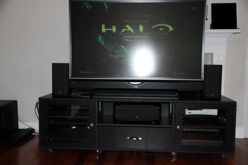

Holding up a JVC HD-56FN97 - The flash screwed up the image...Halo looks fantastic on this TV! You also see speakers from The Speaker Company (RIP)
Should have built a bigger drawer...
goodwad is offline

Nice work there, Goodwad!
Thanks moonhawk!
After coming through on some "bomb proof" IKEA like box pyramid shelving in the kids rooms, AV Rack for my bedroom, AV rack in my weight room (seen in the pictures), bookshelf storage for our closet, the TV stand wasn't a hard to sell to the wife...considering I can build it stronger than I can buy it at a fraction of the costs (assuming my time is worth nothing).
It's one of those projects you're bitter about for a couple of weeks...but then you get over it!! Besides....I needed an excuse to buy a plunge router.
Good luck to all of you considering building a stand. You will make mistakes..but just roll with it. My biggest mistakes came with running a plunge router for the first time (like my cabinet doors, cabinet glass, and even the bezels around the glass are different sizes on both doors. You don't have all the details worked out in the beginning...I sure didn't....just build the frame and figure the rest out later. I used cheap material (MDF), but prettied it up with black paint and "chromed out" corner bracing.
Have fun!

Originally Posted by DSF767 View Post
Hey All,
I just found this thread and WOW I must say some of you have built some great stands and Entertainment Centers!
Here is a little update to my project
Last weekend progress
This weekend progress, I just need 1 more coat of paint and it will be good to go.
vivatech likes this.
Looking good! How are you routing your cabling (for the TV area)?
I used a hole saw to put a hole in the top so I can feed the cords down is just hard to see in the picture because its white.
