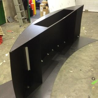

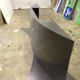

I put this together for my TV lift, made from 5mm foam pvc ..
TeflonSoul likes this.
Signs is offline
You make it sound like you slapped a few boards together in a few minutes. It looks very nice. Great job.
Cheers
The hardest part was working out the hight to allow for the TV lift and the radius .once that was done I cut a Vinyl template stuck it to the foam and cut the shape with a stanly knife .
A few struts and some sticky tape and bobs your uncle

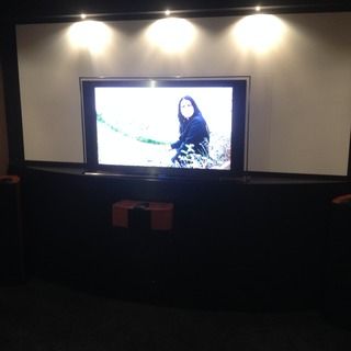

I never posted a final picture of my rack so for completeness, here we go.
TeflonSoul and climber07 like this.
