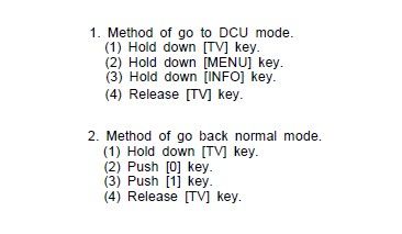

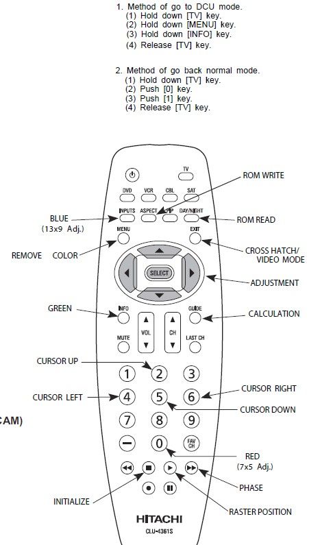

Here are the RC settings
- Adjustment mode
- DCU and how to get back to normal mode
And a picture of the remote.
Name:	DCU and Normal mode Hit.jpg
ID:	137177   Click image for larger version
Name:	adjustment mode Hit.jpg
ID:	137185   Click image for larger version

This link still works:
http://www.lbaileyht.com/HitachiDIYGuide.rtf

So should press all three remote buttons simultaneously or one by one? or press one then lift and press second and lift and then press third?
deltree86 is offline

Press and hold the menu button on the TV.
Press and hold the menu button on the remote, whilst (I love that, thanks!) pressing 8 then Select.
Open a beer with your third hand and have a blast.
