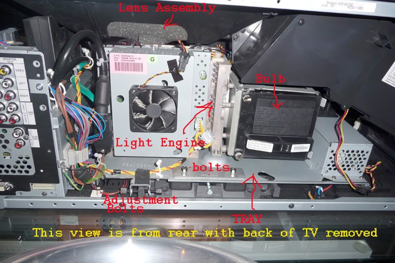

I have several photos taken during the lens-cleaning process.But I have no hosting site so I can't post them.I can email them to anyone willing to post the photos.Fred

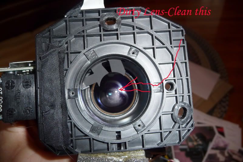

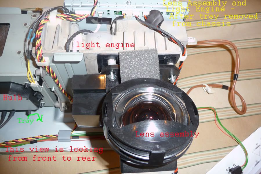

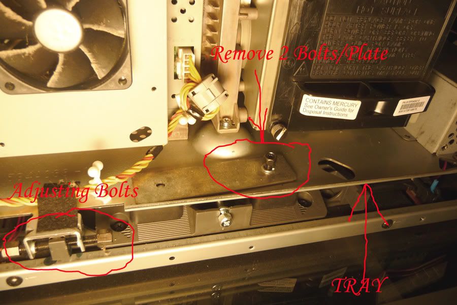

Hope this works!Here are some images taken during a cleaning of the lens:

Images e-mailed and uploaded...
Back panel removed
Bolts highlighted
Engine up close
Lens up close
allargon is offline

Allargon,
Uploaded photos are much better than my links!Thanks.
