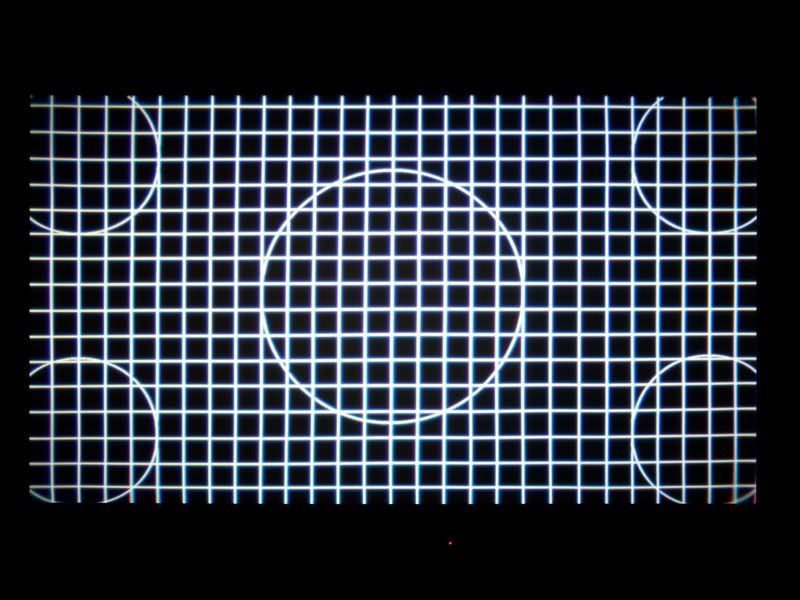

Can someone tell me what the cause of this could be? I have a mits ws-65819. I have cleaned the lenses, mirror, refocused the "focus" trimpots and did manual focus on the crt lenses. I reset the convergence and adjusted them in both 1080i and 480p modes. Now could this be a convergence problem? The tv has a few issues and i picked it up for free. Only the 1080/480i/480p input works and the sound is dead. Also the tv will not display anything in 480i mode, only 480p and 1080i.
There seems to be a ghosting effect. I have adjusted the contrast and brightness. Contrast is around 20 to 25%. I have played with the contrast up and down and there was no change. I have looked for "SVM" in the manual and there is no mention of it. I have done nothing in the service menu because i am confused in there and don't want to screw something up . I am very happy with the overall picture and this is just a bit of an annoyance because i know it shouldn't be there.
Thank you

Put up a pattern like this one and you'll be able to tell if its the convergence for sure. You'll see red or blue spilling outside the white lines.
If you look at the bottom right side you can see some red... something like this is what you'll be looking for.
