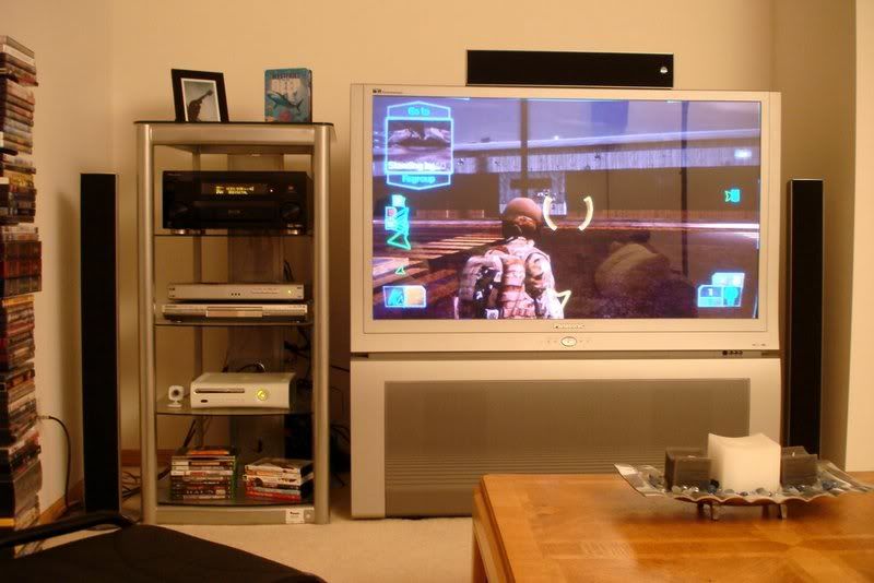

Fellow CRT'r chiming in. I have a Panny 53x54 set that I bought 2 years ago. 2nd Panny rpcrt for myself. I love it. Its only been calibrated by myself and it looks better than any digital I have seen out yet. It could be a tad sharper but the color, depth and blacks can't be beat.
Also, who said RPCRT's don't look good in the house?
(color is way off in this pic, the TV is silver not that tan color)
The only difference between digital projection and CRT is depth and weight. Ff you plan on keeping your components under the set in the stand. Then its going to be at least 20" deep anyways. My Elite 45tx is a good 19+". So, depth to me is a moot point. Picture quality comes before form. As far as weight, I don't know about many others here. But I haven't moved my TV since I got it where I want it for over a year. Plus, the delivery guys put it there so big deal.
Sadly, there was a Mits WS-65711 for sale in my area for $1500. Had to pass it up because there is no way I could get it in my basement But I could not be more happy with my set after 2 years.
It is better to ask for forgiveness, than it is to ask for permissision - the WAF factor
I hope you realize that the 65" and 73" Mits's separate into upper and lower halves -
If that helps -
If that helps -
Mr Bob
I do know. But I'm sure that even when split into two. It most likely will not get into my basement
