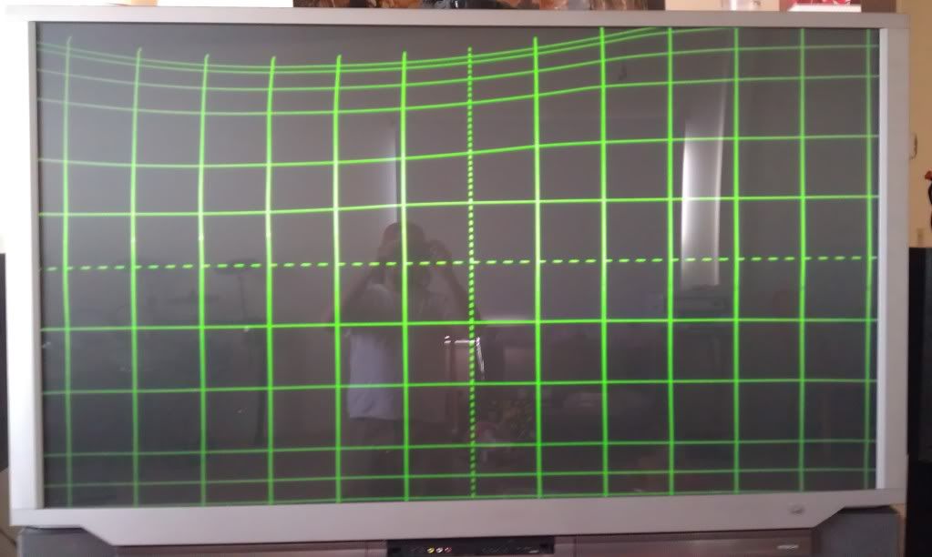

post #10710 of 13408 Old 05-10-2012, 04:14 PM
Hockeytown Fan's Avatar
Location: Hockeytown MI
Posts: 391
Help!!!!
I turned on my Hitachi 65swx20b and this is what I had...
I went to the DCAM and only have the green displaying so it was easier to show you guys. The red and blue are fine, its only the green. Is this fixable, err i mean is it Worth fixing? I love this TV but if this is expensive to fix I'm afraid I'm gonna have to give it a grand funeral.
Help a Family in need, Show Them We Care! Like it on Facebook and tweet it!
http://igg.me/p/171832?a=874546
Hockeytown Fan is offline
