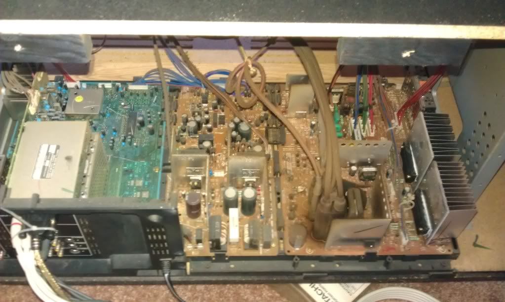

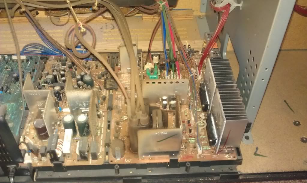

ok, I've attached a couple pictures of the inside on my set. I'm hoping that all of the wisdom in this thread keeps me from getting killed lol. I know TV's retain energy even after being unplugged, can someone point out the "Do Not Touch parts". I think I know all the areas but in case I've over looked something, I'd rather be safe and have someone else with experience take a look also.
I'm sure you guys know but I'll just point out in case, the IC's are on the far right side with those two big heat sinks attached and white paste between the chips and heat sinks.
Somthing is kinda on my mind about this though, could this be a domino effect going on? After replacing the IC's, could there be other resisters blown that caused this IC to go out? I mean anything is possible and I know its hard to speculate over the internet with just a bunch of pictures but any of your wisdom on this would be Huge!
my family LOVES this set, My kids grew up with it since they were toddlers and through all the advice I've received here, this set still Looks Amazing!
From what I understand, sometimes you can just re solder the existing ICs and fix the problem if it hasn't been run in the broken state too long, although upgraded ICs are supposed to help Picture quality.
- 2B
it only ran for a few moments after it happened. to be honest though, if I'm going to tear it a part, I might as well replace the parts. it'll cost less then 60 bucks when its all done.

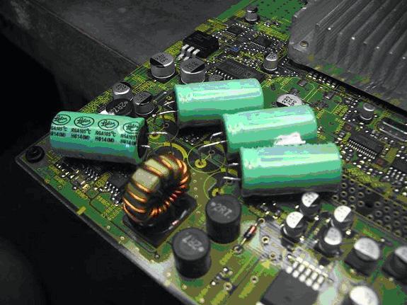

Is there a thread/link/how-to somewhere in hear on the Mitsubishi Capacitor Replacement to solve the Blinking Power Light problem? And yes, I've searched and can't find anything definitive. Guidance would be appreciated!
You can try this guide....
http://www.techlore.com/article/2471...air-Procedure/
or this...
http://www.techlore.com/forum/thread...t-death-flash/
Not sure what your model # is but should be similar.
Hope this helps.

Liked: 69
Whenever you have the blinking green light of death and your DM Module contains 7 capacitors, you should replace all 7 of the 1000uf caps with 680uF each, all other specs remaining the same. Sometimes they will be bulged but most times they will not. You can check them, but if even 1 is bad you need to replace them all. This is straight from Mit. Rather than even checking them, simply replacing them is easiest. If your has only 4 caps in there it would be from a different model year, but probably the same issue. I would replace all those exactly the same way, same specs.
This should remedy your issue. I have direct from a tech who has done a lot more of these than I have, that this always fixes it for him. Has fixed it for me as well. Yes it could also be other things like the 9v regulator possibly going out, but we always go with the most likely suspects first.
You do have to be careful of the polarity and have a hot enough soldering iron, as you are dealing with a dual layer board, with lots of plating on it.
b
This should remedy your issue. I have direct from a tech who has done a lot more of these than I have, that this always fixes it.
b
Is the procedure described in this link accurate? It's saying to go with a higher voltage radial cap. Should I just use exactly what's in the set except for the use of 680uF caps instead of 1000? Link to Fix Also, is the addition of a fan necessary to prevent a reoccurrence? Finally, any good sources for the Radial Caps? Mouser can't ship until mid June. I'm new to the Houston area and don't have my old reliable sources I developed in Jacksonville.
Bullitt5094 is offline

Good write up, yes looks accurate and should apply also to sets with 7 caps rather than that write up's 4. All except that they don't pass on the directives of the manufacturer on changing the value of the caps from 1000 to 680 instead. Factory mod. They may not have direct access to Mit technical assistance like I do.
I always try to upgrade the voltage capacity on caps like this, yes, if possible. Fit is an issue tho, your caps can only be so tall and so wide before they will not fit. If you go to 1000uF caps and 35v, chances are they won't fit. Not only might they be too tall, they are almost pressed up against each other in there, so fatness is an issue as well.
If you go to 680uF caps like Mit directs they will be shorter and thinner, so going over the 16v prescribed voltage may not be an issue. If you can get 25v versions of the 680uF caps, that should pretty much solve any size problems. At 680uF, 35v caps may work as well.
MCM, Union Electronics, Andrews and East Coast will have such caps. Remember, don't order 1000uF caps! Get 680's. And make them board mountable, with both legs coming out the same side, beside each other.
b

post #10736 of 12837 Old 05-14-2012, 10:51 AM
Bullitt5094's Avatar
Location: Houston, TX
Posts: 292
In the replies to that thread on Techlore someone posted they were using105c 50v caps and installing them sideways like this...
Is that a good idea? If so, think you could put 7 in that way?
I'm assuming my WS-65813 uses 7 caps, correct?
Do you recommend installing a fan? Looks like a pain I would rather not deal with unless it's really necessary.

Posts: 355
No you do not need to install a fan, that was just for added cooling but is not necessary.
Shouldn't be an issue with the caps sideways as long as the leads don't touch anything. You can pick caps up at radio shack or a frys store. The radio shack caps are just a bit fatter but should fit. And as also stated earlier make sure you have the polarity going correct direction.
splatee is offline
Good idea but overkill, you don't need 50v caps, which are a LOT bigger than 16v caps. Nobody is really sure why they go out, but since 680uF does not involve as much filtering work as 1000, the voltage was probably not it. As such chances are they can probably stay the same at 16v with no deleterious effects and no repeats of the going out phenom, as long as they are changed to 680uF.
b
