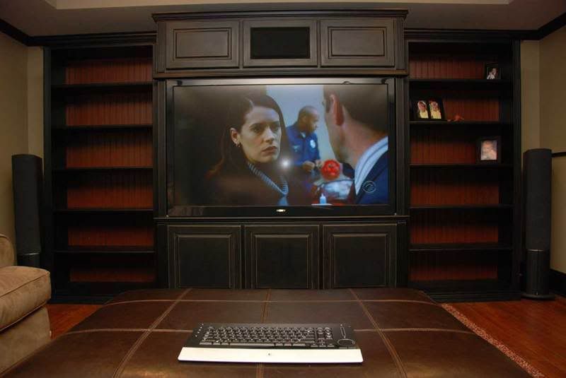

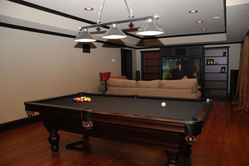

post #6808 of 12125 Old 08-31-2007, 01:40 PM
tkbr0wn's Avatar
Posts: 9
I finally got my Entertainment center for my 70" xbr2 built. I thought I would show it off to you guys.... Let me know what you think...
tkbr0wn is offline
post #6809 of 12125 Old 08-31-2007, 02:07 PM
Dinomon's Avatar
Posts: 664
It's very nice.. Did u build that by yourself?
Dinomon is offline
post #6810 of 12125 Old 08-31-2007, 02:15 PM
tkbr0wn's Avatar
Posts: 9
Yeah, it took about a month.
tkbr0wn is offline
