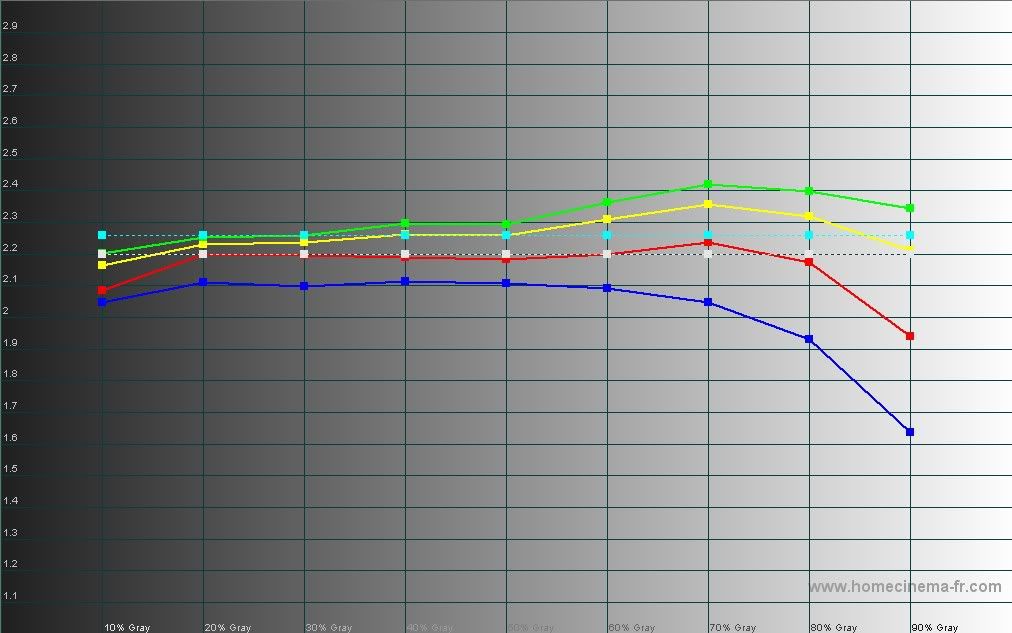

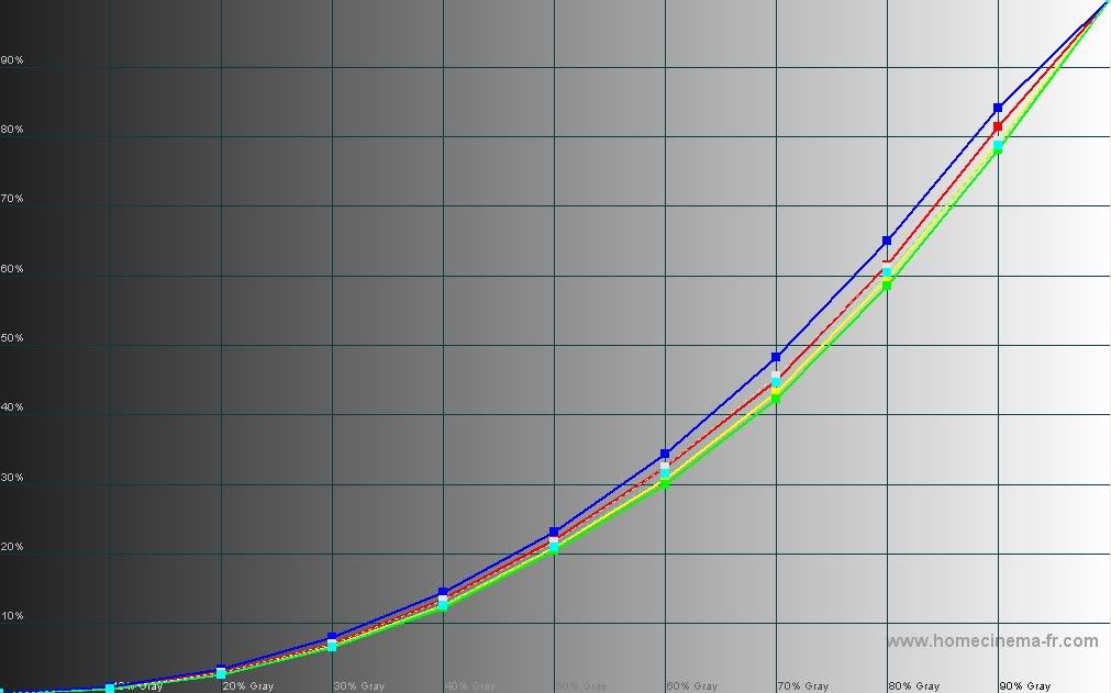

When we got our signal board replaced the image was put very far out of whack. Even convergence was affected even though they soldered in the original DCU. It took a while to get it back into sorts, but the color freakouts and random on/off behavior went away completely. It ended up to be worthwhile, but a labor of love.
With bright stuff too bright, dark stuff too dark and no shadow detail, you are likely fighting with screen gamma, or the transition from dark-->light. Don't worry too much about the brightness control near the top and contrast near the bottom. Contrast is better set low anyway. Ours is that way now, but I did changes in the SM that also affect these settings.
Keep in mind brightness, contrast, Gamma controls, and source device(DVD, cable, etc) all affect the screen gamma.
Decreasing brightness or decreasing contrast tend to increase gamma.
Increasing brightness or increasing contrast tend to decrease gamma.
The service menu gamma controls have their own affect on gamma and there are two gamma controls in the SM in this, and many other Hitachi RPCRT.
Without a meter gamma is not easy to visualize and adjust. I don't think the gamma images in the test DVDs are worthwhile because there's too much subjectivity involved with them to do adjustments. But maybe if you have a test disk take a look at the gamma squares pattern just for grins.

Besides the scheimufledge (?) I'm planning on doing a REDO! Against every recommendation of not touching the SCREEN POTS, I'll reset them for all three colors, and then of course will have to re do grayscale, color, electro focus and mechanical focus.
Since you may ask why... last time I took a reading my blue wasn't tracing where is suppose to be, not that it really makes a real viewing difference, but since I'll have some time I'll get the set as close as perfect. Then if I still have time left will try to get the Lumagen set.
RPCRT-TV Overscan Reduction
Reference Blu-Ray Demo Disc
superleo is offline
Before you touch the screen pots, what meter are you using, and how old is it?
If blue is falling short, you should bring the other 2 colors down instead, in the grayscale high end. That will effectively bring blue up.
Lee Bailey is offline
Nice surprise Lee seeing you on this side of the forums!
I'm not talking about, grayscale that is with in norm regarding deltas, although due to blue not tracking correctly 100 IRE is suffering.
with the Luminance graph you can better see whats happening.
Like I mentioned earlier, I don't think that this is a must do adjustment, but the tv will have some down time and that is my only time other than late nights to play with it, plus it wouldn't be fun if I just watch movies and TV!?!
Hello,
By the looks of the graph the contrast is set too high. If you want to run an experiment run the contrast down and take new readings. The gamma graph shows a falloff at starting around 90% white. So lowering the contrast will enable better luminance tracking and consistent gamma.
Specifically, record the existing contrast and brightness settings. Then try setting the new full scale white reading (FtL at 100%) to the current 90% value using the contrast control, then check brightness. If satisfied then take new readings. If you must have the contrast set that high for viewing conditions then you'll have compromises in gamma and grayscale. Actually if you have a grayscale error it's best placed in the 100% white area as opposed to 0%...
Joe
