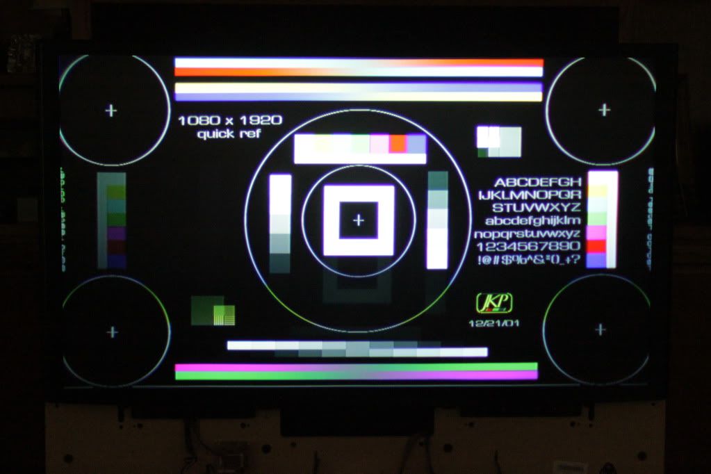

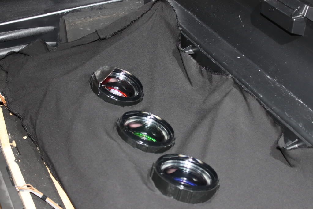

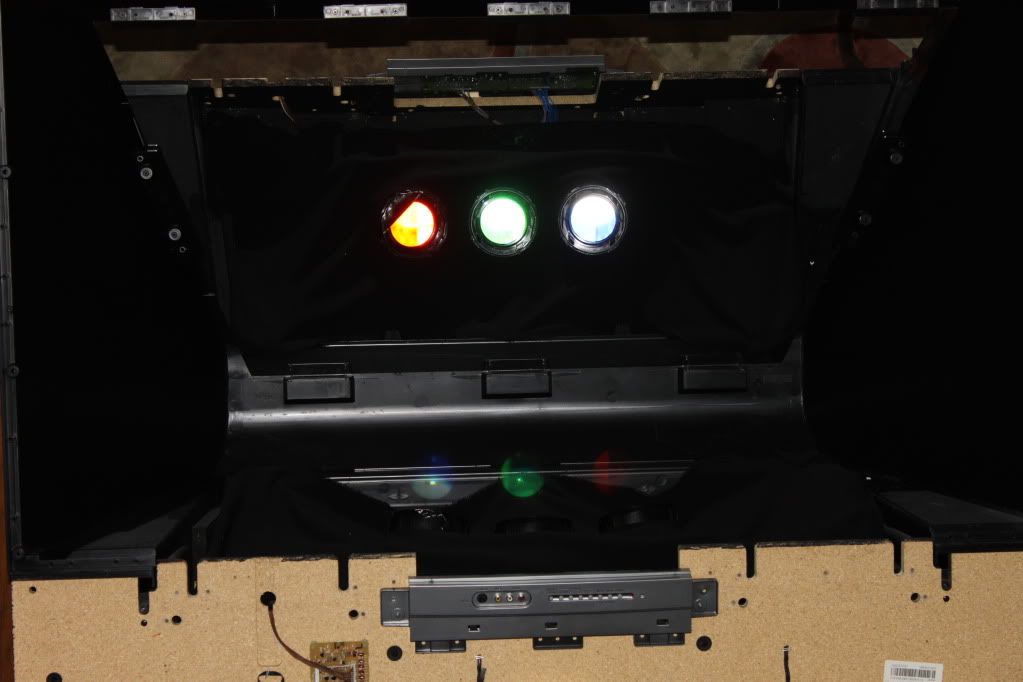

As Bob mentions, it is very important to keep the optics clean. Also, I did the schemuglage op on my set that in turn left some more work to do. I'm still working on having the best picture possible.
So next time you come by Texas Bob you know what we will be working on.
Clean Optics.
Tape Stripping.
Results

Awesome results Leo! Can't wait to get back to your area again!

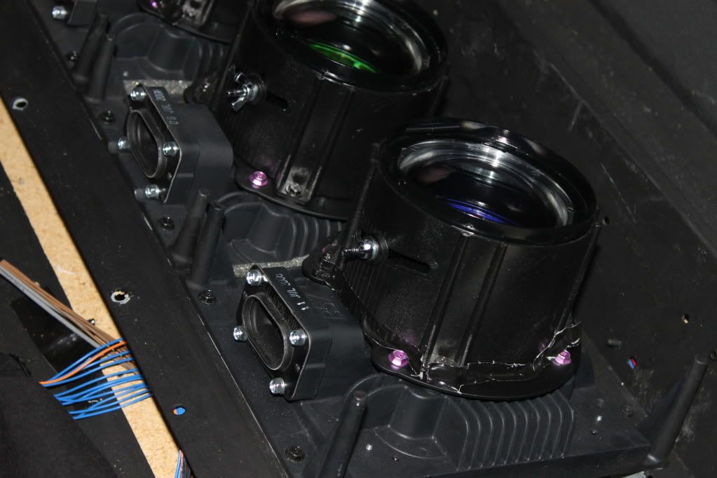

Originally Posted by Mustang68 View Post
Hey I did that Shempterpflug thing too. However I put washers under one end and kinda manually aligned it that way. whats up with the tape on the red. Is that another way of doing it cause mine is better but not perfect.
By changing the angle in which the light hits the screen (putting the washers under the guns) we improve the capability of the light to be better focus... however, it is not uniform through out the screen. In my case I have razor sharp focus in two thirds of the screen for red and blue, and of course green is perfect all around since it is in the middle. You have to adjust the focus so the opposite side is not very noticeable, or tolerable to you.
The tape is used to give that color more uniformity through out the screen. In my case I also moved the red trimpot... and NO, this is not recommended, I had to dialed it down just a tad because after the schemuflag op red was blooming more than I would tolerate... I did not have this problem with blue, although I've been wanting to boost blue just a tad, and this is only based on calibration readings.

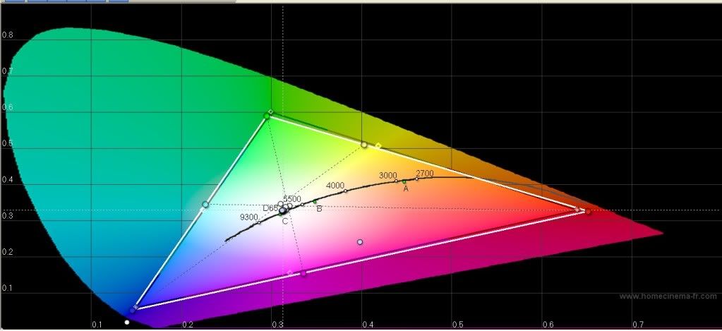

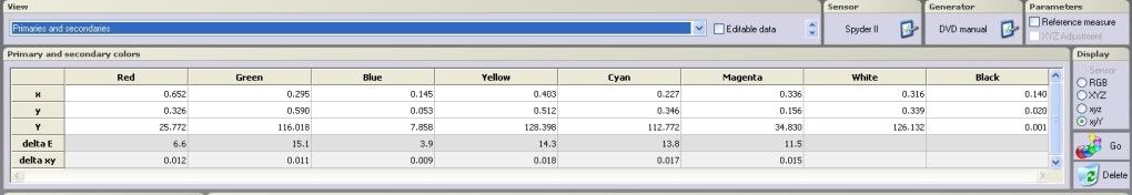

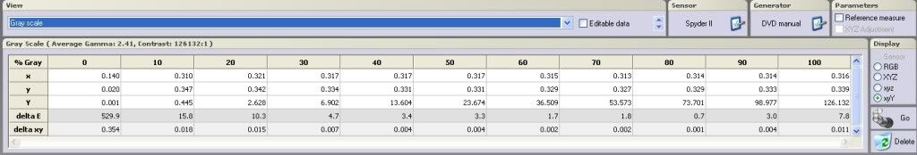

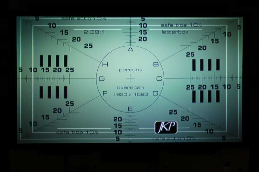

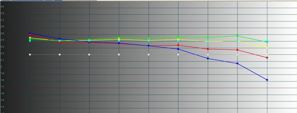

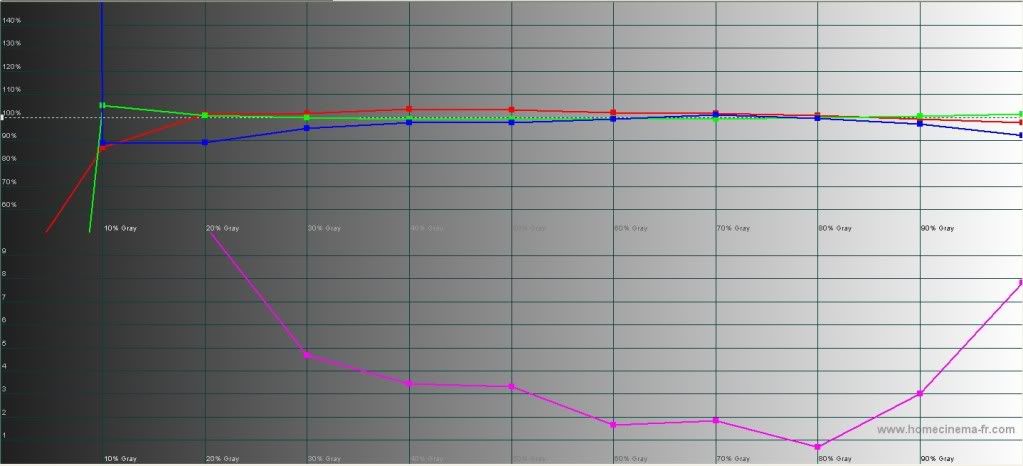

Here are the numbers after the schemuflag op.
RPCRT-TV Overscan Reduction
Reference Blu-Ray Demo Disc
superleo is offline
Old 12-01-2011, 07:42 AM
superleo's Avatar
Posts: 2,255
Mentioned: 12 Post(s)
Quoted: 71 Post(s)
Liked: 277
superleo is offline

good day everybody! I am new to this forum and started an account because of the following story…
On the way home yesterday I saw an older “bigscreen” tv on the road that said “works fine free”. I had previously been searching for one of these to use as a old school gaming tv for the basement; you know Nintendo, ps, etc. I am a nut for hdtv and blu-ray movies which I use on the upstairs lcd tv and my ps3; so I was not very particular about picking up one of these old tv’s for the basement. Upon looking at the tv up close, I noticed it was hd capable and even had an hdmi port! I started thinking that this might have big potential! It’s a Hitachi 51f59a with a manf. date of 2006.
Loaded it up in my jeep and brought it into the garage, powers up fine. Turned on, the 3 colors are out of sync. I had never had a crtrptv and was unaware of what was going on. Read the manual and tried “magic focus”, this helped but the red was still off on one side of the screen, tried the manual convergence too with no luck. It also appears that the convergence changes after every power off (or it could just be my eyes).
Long and behold the plethora of internet information and had spend the last 2 days reading the incredibly long posts about this sort of stuff. I had a good indication of things needed to be done (dcam adjustment, a cleaning, etc) but what I am asking today is there a specific order of things I should try? From easiest to hardest, general to technical? I figured I could have bumped a gun out of sync on the drive home. I still have to put it in the basement so I will try the convergence stuff after that. I do plan on reading the threads; just need a push in the right LOGICAL direction. It appears to be in good shape, defiantly dirty, screen is good, and I have the remote too!

Your convergence circuitry has failed. Anytime you can get the points to do your bidding in one section of the screen but not another, that needs to be remedied, which usually simply requires the replacement of the ICs in that section. Sometimes more.
Let me know if I can help you personally by repairing that for you.

So I will be buying a convergence repair kit with new ic's and resistors.
My order of fixes are:
Clean lens, mirror, mf sensors
Blackout interior with cloth
Ic and resistor repair
Dcam
Color adjustments etc with some sort of dve blu ray?
Is this a logical order?
I might want to get a perfect picture in the future but I mainly want to get it up and running and looking good enough to play blu rays on with my ps3.
Random questions:
What are the pots on the focus pack for? What type of parameter do they adjust?
Should I do the riser block tweak?
Should I do th lens striping technique?
Do any of these need super specialized equipment to get good results? Or can a lot be done by eye?
EDIT:
Took the board off with the ic's and resistors. Looks likei could have some cold solder joints on the ic's. I am going to grab my 15w iron at work and hit them tomorrow and see what happens.
