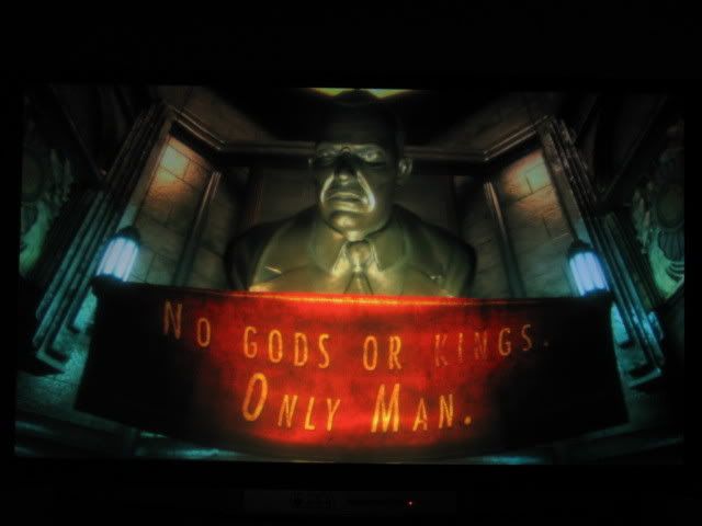

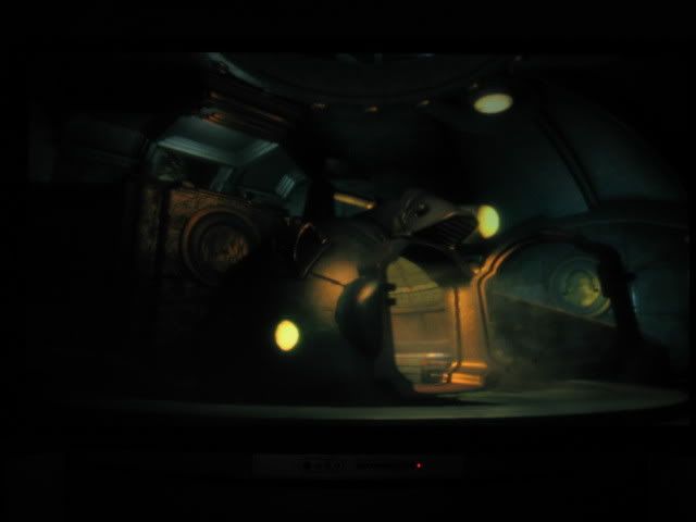

hey guys i had some time to take a few shots tonight, (parents are out of the house) and figgered i'd post them, yeah i know theyre small and a tad dark, but thats from the camera.
1080i over component
those were the best of the bunch. im going to get some bigger ones in a few minutes.
They look pretty dim, both on the Brightness setting and the overall light level/Contrast...
Sharp and clear, tho.
