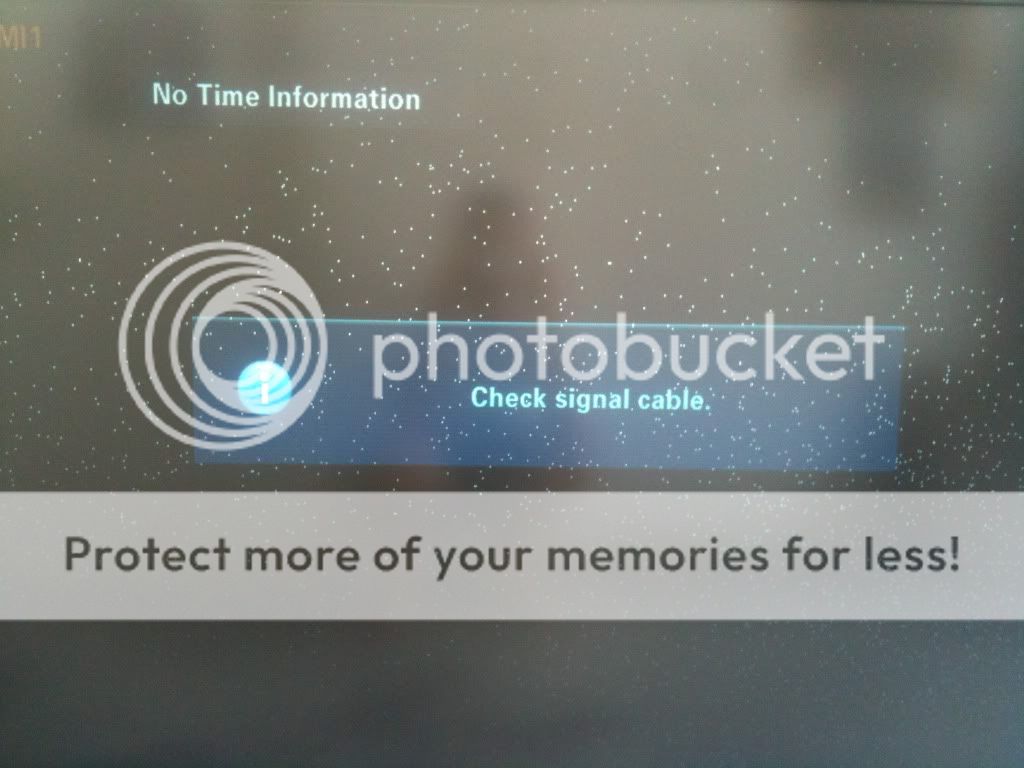

Hello everyone! I am having an issue with my HL-T7288W... it is the dreaded Samsung white dot issue. I was wondering if anyone else has had this issue with this particular set, and if so, was it just the DLP chip as it has been with other Samsung models? I don't really want to spend the money on replacing the chip (which I would be doing myself) it that isn't the problem. If anyone out there has had this issue with their set, can you confirm what part you used to fix the problem? Thank you SO much in advance! Attached is an image of the problem I am having...

wow, that's bad. The DMD chip is handled under a defective product recall. Call up Samsung and tell them what you're seeing. I had the same problem and they came out and replaced the chip with no charge.
Though check the video after they're done, when he was in there in mine I had an extra 'reflection' off the light engine somewhere so had to call them back out.
I called Samsung and was told that my model isn't covered and it's due to normal wear and tear... So you say they replaced the DMD chip? Is the DMD chip the same thing as the DLP chip? Does anyone have a part number for what I need to get? Thanks!

The DMD is the chip itself (mirrors) what you have there is that the mirrors are stuck and can't move. Normally this is due to heat from what I've gathered.

Shaaawn:
Starting about last June, I had white dots start to appear. They increased 2-4 per week, and by the time September rolled around it was bad, but not as bad as yours. I did quite a bit of internet research and decided it was the DMD. I bought Samsung 4719-001985 and it fixed the problem. When I replaced the chip I also took out the thermal blanket Samsung had behind the chip, and replaced it with a high grade thermal paste. One of the threads from other Samsung models had recommended this and it seemed a wise thing to do.
I either found or bought assembly/dis-assembly instructions and found them to be very cleaar and easy to follow. Using the instructions I had it dis-assembled, repaired, and re-assembled in under an hour, and 15 minutes of that was cleaned the old thermal blanket gunk off the board and applying the thermal paste. Note that the instructions talks about three alignment screws that shouldn't be touched (so don't).
When I turned the set back on, the alignment of perfect and no more white dots.
If you can't find the instructions on-line, email me and I'll send them to you, they are essential to doing it right.
I also spent 5 minutes on-line looking up prices and found the cheapest on Amazon, I bought mine from TVserviceparts.com which claimed they had the part in stock and then sent me an email saying it was back-ordered.
Hope this helps, John
