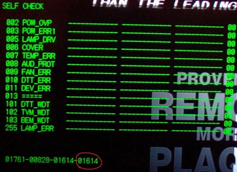

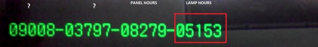

Anybody remember what all these numbers mean?
02/03/2012
The one on the right (5153) is supposed to be lamp hours. And the next to right (8279) is supposed to be panel hours. What are the others?
By the way, there will be some discrepancy between "panel hours" and "lamp hours". Takes some time for the TV to turn on completely and the lamp to warm up.
I've changed bulbs, at 3121 hours, and re-set the counter. My 2nd bulb has lasted over 5,000 hours, unlike the crappy Philips.
8279 (panel hours) - 5153 (2nd lamp hours) = 3126. But the panel hours should be at 8274 (3121, 1st lamp + 5153, 2nd lamp), if it matched exactly how long the lamp was on. So, ever since January 2008 until February 2012, the minute or so it takes the TV to turn on and the lamp to come has built up to a 5 hour discrepancy.
Looking here, at a previous post, the numbers (first bulb) almost matched between panel hours and lamp hours, but even then there was some difference.
http://www.avsforum.com/avs-vb/showt...4#post16981274
08/11/2009
This pic above was posted about two months before my Philips bulb gave out. Luckily I had a spare bulb -- not Philips -- on hand.
01/12/2009
Bought the TV 01/08/2008. This pic above was after one year.
____________________________
Here's how to find your numbers: http://www.avsforum.com/avs-vb/showt...4#post16981274
