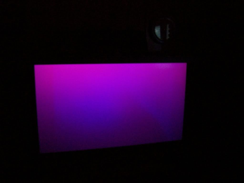

Here are some pics with an unused input. Any help would be appreciated.

Here ae some with Avia test paterns:
These are for UMR.

What color temp are you using ?
Try scrolling through them all and see if the blue spot changes color or has less color.
When I had the green blob on my 2020, it was worse on Warm1 and 2 and barely noticable on Neutral or Cool.

These pictures are hard to see. Except they look brightish near the center; unless that's your camera.
If you're saying a blue very softly defined blob, it's in optics block. It's something like a color diffractor that's used to separate light into red/green/blue, and it's maybe burned. Or possibly the first lense past lamp which diffuses light into a uniform brightness.

Is not the camera. The spot is on the center of the screen and is more white/blue than green.
