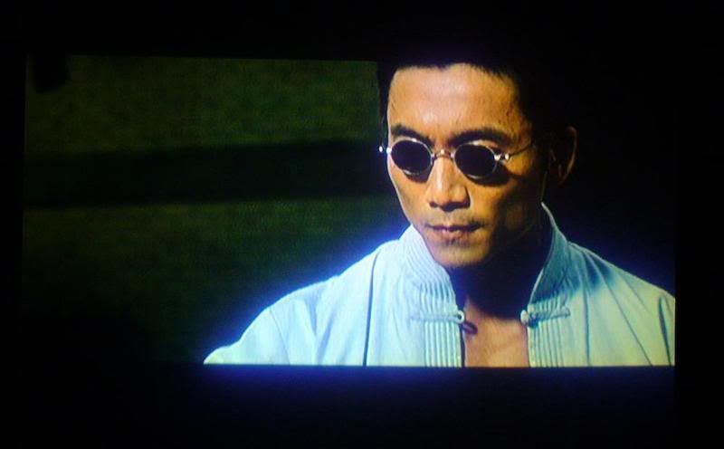

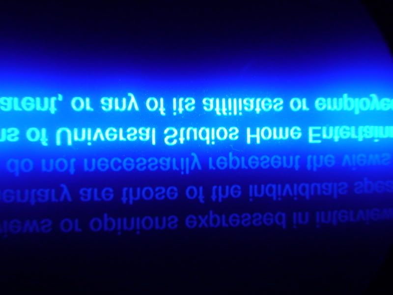

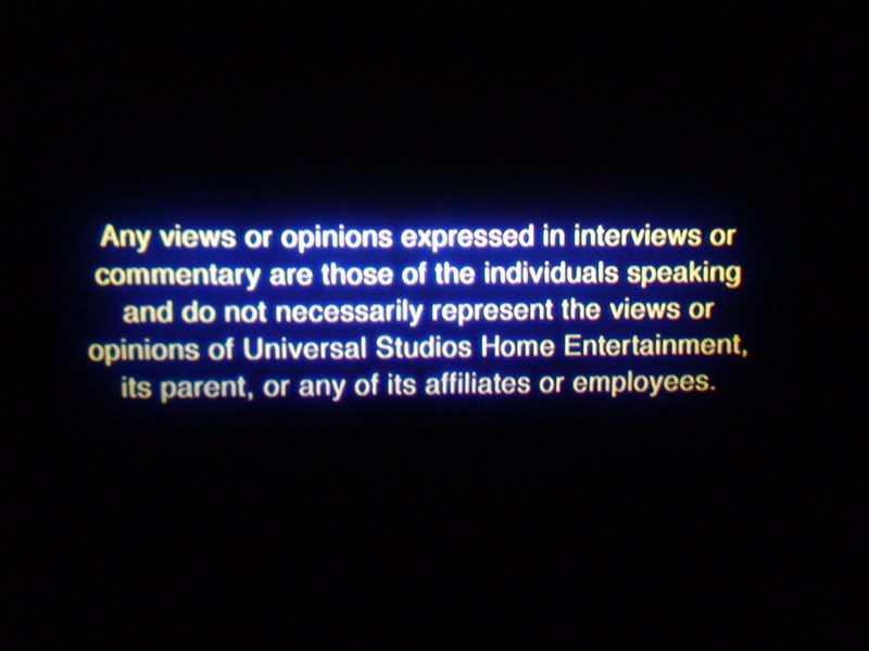

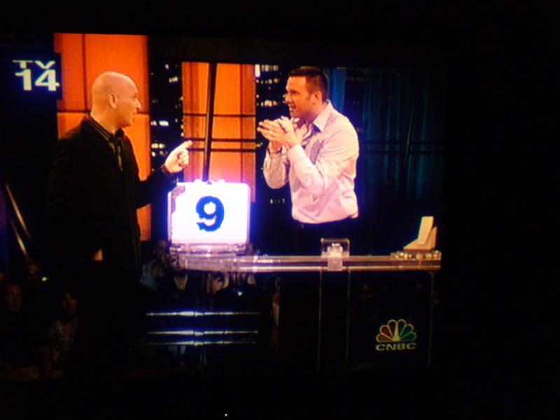

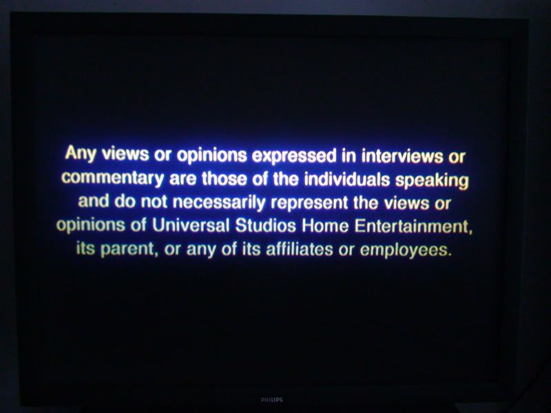

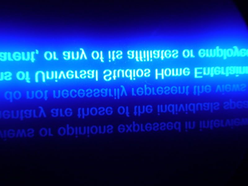

Hi John. No, I haven't looked down into the CRT's yet, but I've posted pics of my problem and everyone agrees it needs to be done. It's a 2001 TV and it's never been serviced since new.
What do you think?
Also, is there any way to prevent this from happening again? I remember reading somewhere about needing to use radiator paint on the aluminum frame to stop the problem. Any comments?
[IMG][/IMG]

No, don't agree! A fluid change for all tubes is a major job, a last step IMO. If that bluish outline is all you see, all other possibilities should be completely eliminated first. Although this link deals with FPs, some of the discussion and pictures about fluid replacement should apply in general.
Assume all test patterns (external or built-in convergence + signs) have a blue overlap, too, and that blue focus, which is deliberately fuzzy to compensate for lower blue sensitivity, isn't the issue. That blue outline presumably appears on all other images, too, and after all potential adjustments to eliminate it have been tried (electrical, mechanical focus per that Philips Keohi link), should appear as a cloudiness looking into the blue lens, and perhaps the others, with test patterns or other images being projected. The current thread about not throwing out your CRT RPTV (Mr. Bob) may have a post or two about how to confirm fluid contamination; (believe that's where I read about looking into CRT lenses). As you imply from your initial request, something like this needs full study and planning (such as marking tube positions before removing each CRT), plus all the turkey basters :-) and correct fluids lined up. Lots of posts, some very detailed, covering it in the archives, and a Google search with avsforum as the first term aids research. Philips service procedures outline a lengthy sequence for alignment after CRT replacement or removals; again, it might be at the Keohi site, since the beam alignment/astigmatism procedures there match those on my CDROM. Never done the exchange here, just read lots of posts describing it, and that FP link may have mentioned a cleaning procedure to help minimize a 2nd growth.-- John

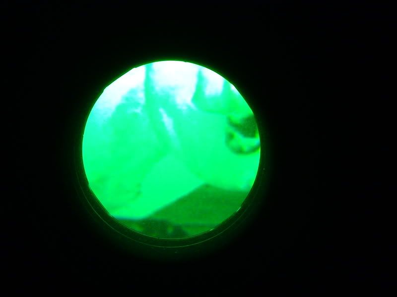

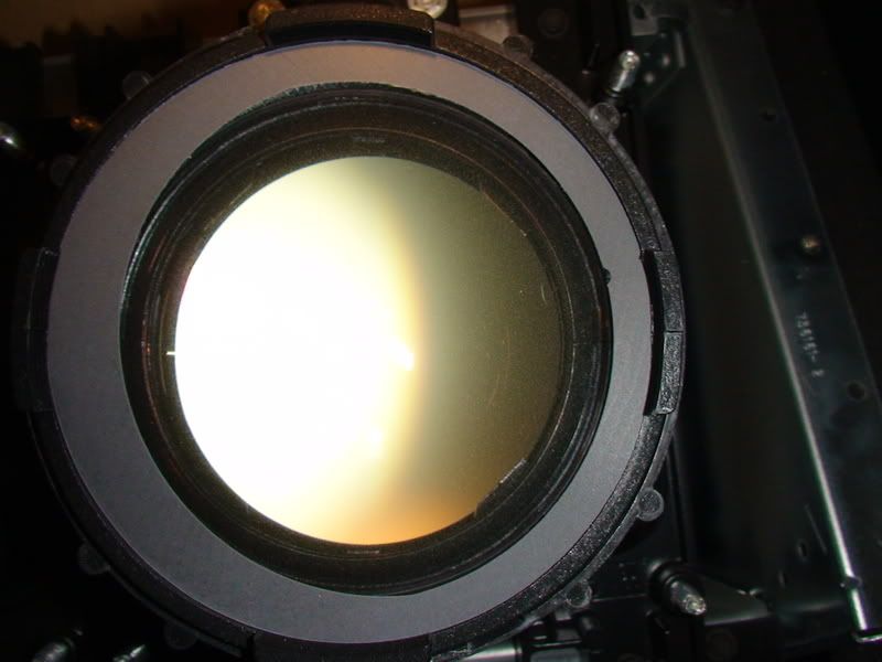

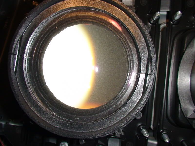

Well, I just opened up the TV and looked inside. I honestly can't tell if the fluid is dirty or not. All 3 look the same to me. There's a big mirror in the way of viewing directly down into the guns, but I can sneak my heads past and look in. I looked in with the TV on and with it off using a flashlight. I can't tell if there's stuff in there or not. There is a film of dust on the lenses though... maybe I should start by cleaning those? If yes, what's the safest stuff to use?
DanRC30 is offline
post #9 of 93 Old 12-26-2007, 04:41 PM - Thread Starter
DanRC30's Avatar
Posts: 39

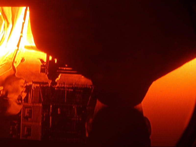

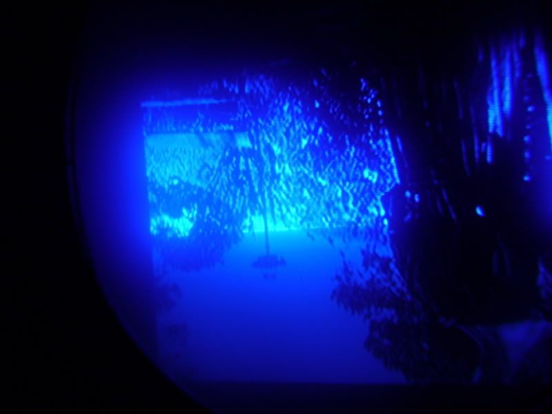

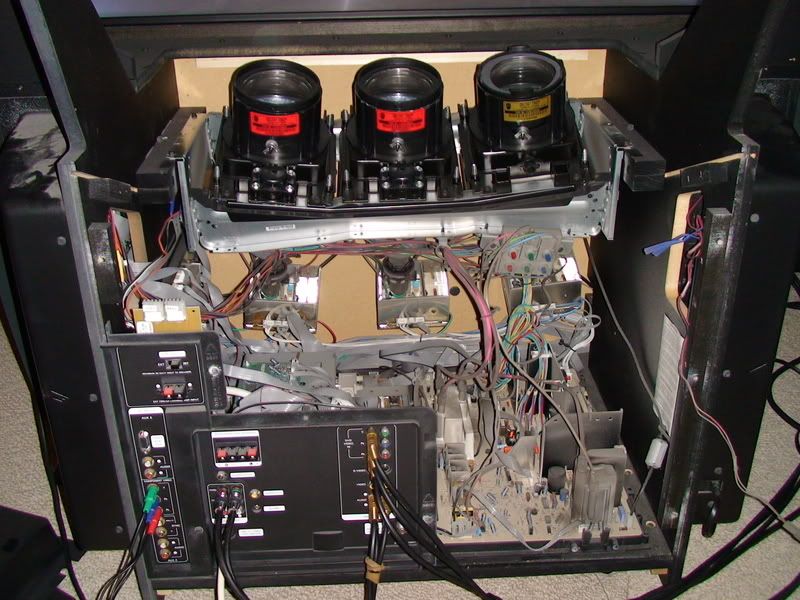

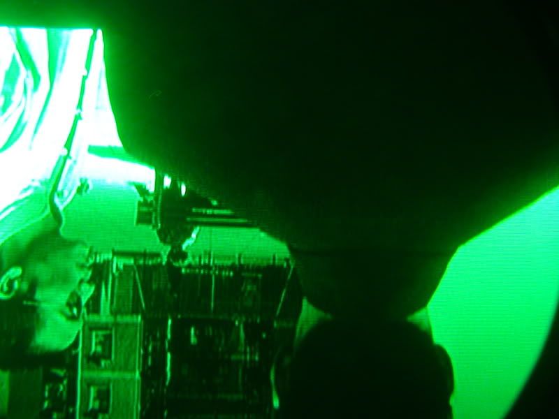

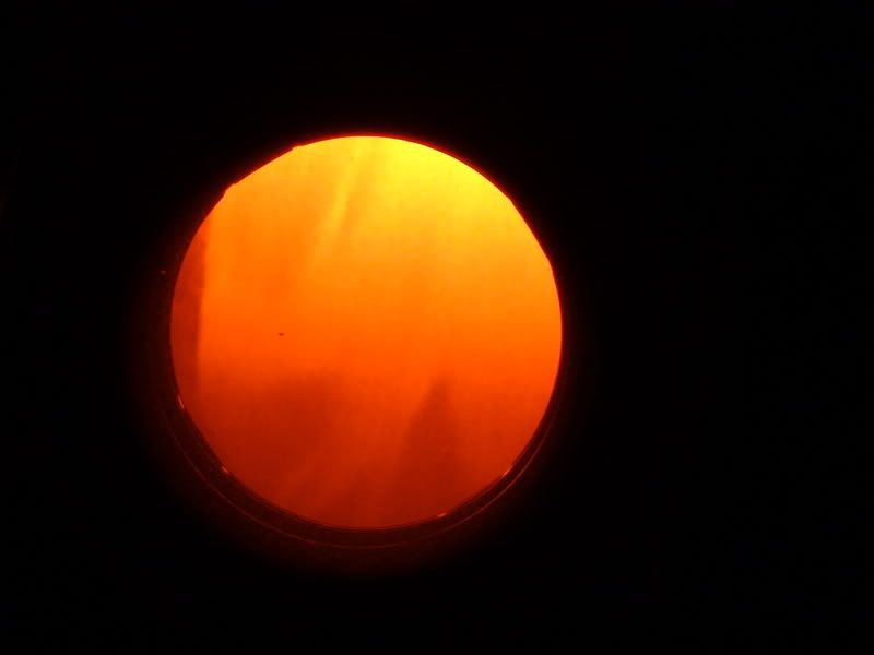

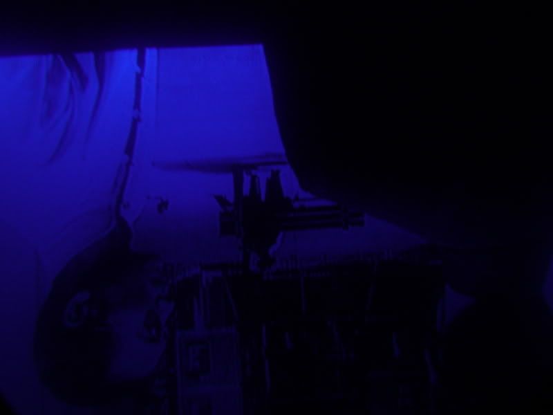

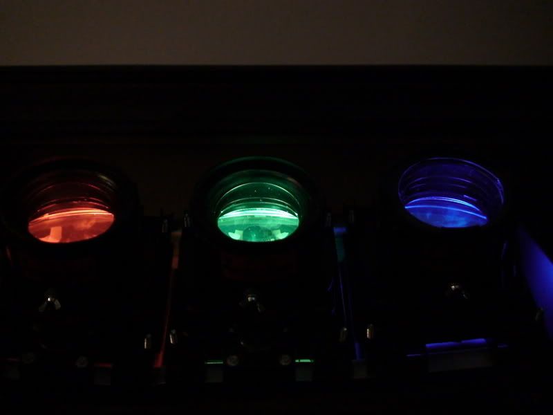

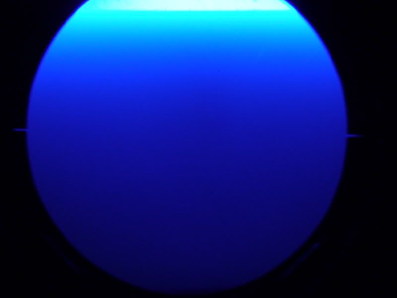

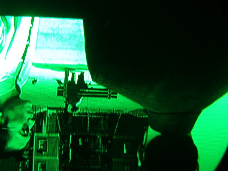

Ok, I just took it apart a bit more so I could see everything. Looks scarey...
Here's pics of the blue, green, and red respectively. First set is with tv off. Second set is with tv on. Hope someone can tell me something here...
And the "guts" shot:
If anyone needs a specific type of shot to help, let me know and I'll take it.

post #10 of 93 Old 12-26-2007, 05:34 PM
Mr Bob's Avatar
Join Date: Jan 2000
Location: San Francisco Bay Area/San Lorenzo, CA., USA
Posts: 9,906
Quoted: 166 Post(s)
Liked: 98
Getting the camera closer to the image inside the tubes would help. As far away as it is, it's hard to make out what's going on in there.
Make it close enough that the entire image inside shows up in the picture, on each gun. 3 pix.

post #11 of 93 Old 12-26-2007, 07:17 PM - Thread Starter
DanRC30's Avatar
Posts: 39

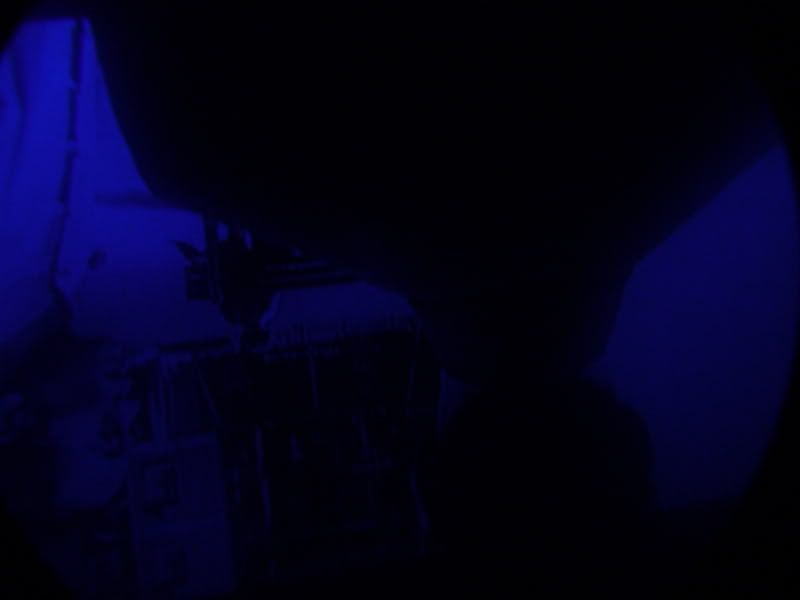

Ok, this is what I got.
Again, there's dust on the lens and it's not helping me taking pics... I'd like to clean them but I don't know what is the safest stuff to use...
When I look inside each one, they all look clean (I think). I'm no expert so what do I know...
DanRC30 is offline

post #13 of 93 Old 12-27-2007, 11:49 AM
Mr Bob's Avatar
Join Date: Jan 2000
Posts: 9,906
Quoted: 166 Post(s)
Liked: 98
I don't think the blue is out of focus, based on the full color single image of the guy with the black round glasses.
But you definitely need to get your optics fully clean - most likely including your deeper optics as well - before we will know anything for sure.
Who knows, that might just do it!

post #14 of 93 Old 12-27-2007, 11:58 AM - Thread Starter
DanRC30's Avatar
Posts: 39
Agreed. The dust on the lens does make it difficult to see inside and even more difficult to take pics. But when I look inside with the tv on or off (with a flashlight) I can honestly say that I don't see anything floating around or any buildup on the surface of the lens. Of course it's really weird looking into this thing and trying to focus my own vision in there, but from what I've been reading, it seems like if there was any algae growth in there, it should jump right out at me... am I wrong in presuming this?
I'm going to take a clean cotton ball today with some non-ammonia based windex on the cotton and carefully clean the lenses.
What makes me curious is why are the red and green guns look the same, and the blue gun looks completely different? The blue looks nothing like the other two. There's even a paper ring at the top which seems to do nothing...?
DanRC30 is offline
post #15 of 93 Old 12-27-2007, 06:59 PM - Thread Starter
DanRC30's Avatar
Posts: 39

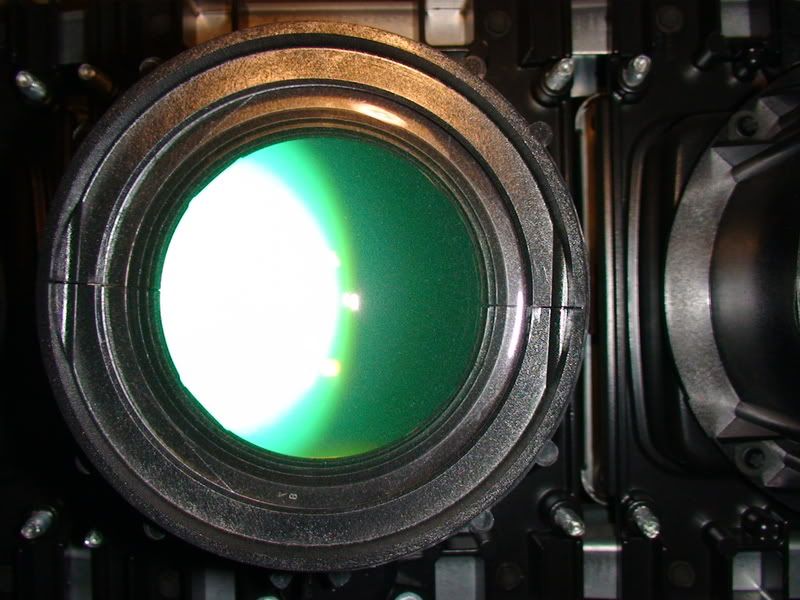

Ok, I cleaned the lenses and I must say... they look great!
So, I just snapped some pics of the guns with the same screenshot as the other day... maybe someone can tell me if I have bad fluid?
ALL CLEAN!!!
DanRC30 is offline

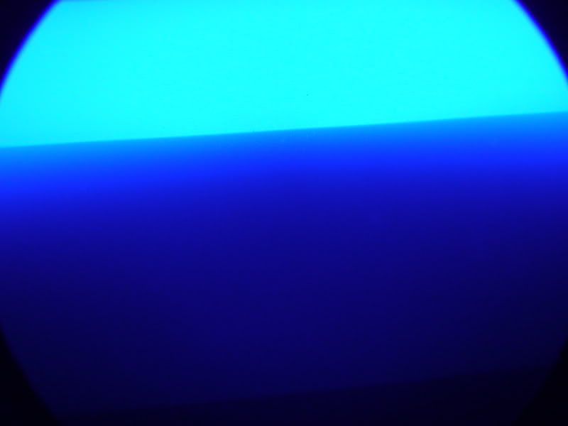

post #16 of 93 Old 12-27-2007, 08:47 PM - Thread Starter
DanRC30's Avatar
Posts: 39

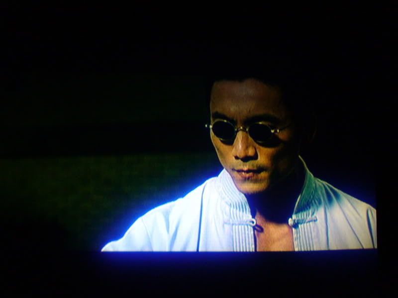

I forgot to mention that I did play a little with the focus settings on the blue gun... it only made things worse when I moved them from their spots, so I put them back.
The glow is still there, but I think everything else is a bit clearer due to the lens cleaning...
I'm baffled here... what could this be? To me, the fluid looks uncontaminated. Could it just be a little cloudy and I can't see it? Could something else be wrong?
DanRC30 is offline
post #17 of 93 Old 12-28-2007, 03:18 AM
Mr Bob's Avatar
Join Date: Jan 2000
Posts: 9,906
Quoted: 166 Post(s)
Liked: 98
Maybe it's a layer of growth on the face of the CRT itself -

post #18 of 93 Old 12-28-2007, 05:23 AM
John Mason's Avatar
Join Date: Jul 2000
Location: New York, NY
Posts: 11,182
Quoted: 76 Post(s)
Liked: 103
You've only posted that one image with a blue glow that I've seen. If the problem is some contamination or other blue CRT problem (or even the blue-only circuits), it seems every contrasty image, from every source, would have the blue glow. I may have missed confirmation of this earlier. (Your last 'graph above makes it hard to believe it's a contamination or any blue-gun problem: all those 'good' images also involve the blue signal circuits and blue CRT.) -- John
Note: With my Philips 64PH9905 I view virtually everything fed at 1080i into my YPbPr HD input. It's actually through a Zektor component switch box (4 signals in, 1 out). My SD DVD machine puts out a 480p deinterlaced signal and my SA8300HD cable STB converts everything to 1080i output as YPbPr to the Zektor. Short (2') cables connect the DVD and cable STB to the Zektor, since I found the added capacitance in 6' component cables created artifacts: flickering in image areas where high contrast existed. I'm also using the cable STB S-video output (rarely). One option there might be bypassing your current input and trying the YPbPr HD; wouldn't be possible, I believe, if your DVD only puts out 480i, but would if your set, like mine, has a 480i YPbPr DVD input (Philips' Genesis-chip 480i deinterlacing). Also, try to minimize cable hookup lengths, even if it's just temporary to see if cable lengths are a factor.
John Mason is offline

The Xbox is using the Video 3 input which is the front access port. I don't know what resolution the DVD puts out, and I'm not sure how I would find out that info. I can tell you that I'm using that 3-wire monster cable for the DVD as seen in the pic above where it shows the guts of the TV. The xbox cable came with the xbox. Just a regular 3-line RCA.
Suggest investigating input formats a bit. My Philips HD circuits objected to 480p--before the warranty board replacement--by ringing loudly and scrambling images completely; quickly switched away here. 1080i sets like ours won't accept 720p HD via component; screens might just go blank, but worse things might happen.
If I set the picture to "warm" the glow goes away. The brighter I make the picture, the bigger the glow.
Hmm. I'm sure this must suggest what to do, assuming 'warm' means the standard color temperature option for many displays! -- John

I need to become more educated so I know what some of the things you mentioned are.
In the meantime, here's 2 more pix from regular TV:
DanRC30 is offline
This is the one thing I can't get past. Are you SURE? Makes absolutely no sense, if actually true -

Can't make much sense of eliminating the blue glow around bright contrasty objects by switching to a 'warm' color setting either. My similar-vintage Philips CRT RPTV lacks color-temp settings, so can only speculate. If a switch setting, though, eliminates the bluish glow, don't change CRT/lens fluids.
Suspect the lack of glow for the Star Wars DVD plugged into YPbPr HD versus blue outlining for other 480i NTSC cable inputs is a clue. My Philips and likely this one has separate processing for 480i sources (like the RF cable-system coax used) and HD component inputs. The warm color-temp setting, AIUI, does reduce the bluish content of images and the 'cooler' switch setting is injecting too much blue. Philips factory settings, if you go over reviews of grayscale tests in these early 2000s Philips CRT RPTVs, seemed to have an excessive mid-range peak that overemphasize blues with factory settings (but not like this). There's too much on-screen color for that CNBC image and perhaps too much brightness ;(tinker with settings for a more natural looking picture or read up on basic user control settings). Or just switch to warm color temp if that eliminates the 'glow' around the number 9. Besides the color temp switch and user controls, suspect getting into the service menu would provide a wide range of additional adjustments, although changing them without knowing what you're doing, and without somehow recording the factory settings, can nearly ruin a set, requiring a costly tune-up--or long do-it-yourself calibration education. -- John

I still think there's contamination in there, it's just extemely hard to make out. I've seen such things settle on a CRT face ONLY, while the rest of the coolant, what you're looking thru to see the CRT face, is clear.
Can you get a shot of just the blue CRT face, so close that the image is inside the round lens face, rather than filling it?
And with a plain white background, then one with one of the images you've shown here, that demo it real good.
Might tell us something more -
Mr Bob
Ok, here goes...
I got as close as I could with these shots from Lord of the Rings:
And this is on an angle to show the edge of the CRT:
I wasn't as successful with the white... the camera had nothing to focus on:
And finally, the same image as before:
Did this help any?
DanRC30 is offline
