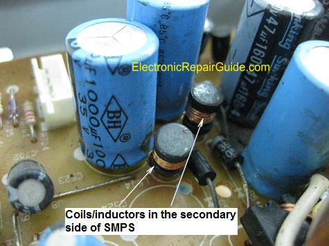

1: A transformer or coil in the circuit has a loose core and is vibrating

1: A coil or transformer will stop making sounds or change sound as soon as you touch it. Once located, silicon it (after closing the TV,) and make it solid so it should stop vibrating.
Usually look like this
