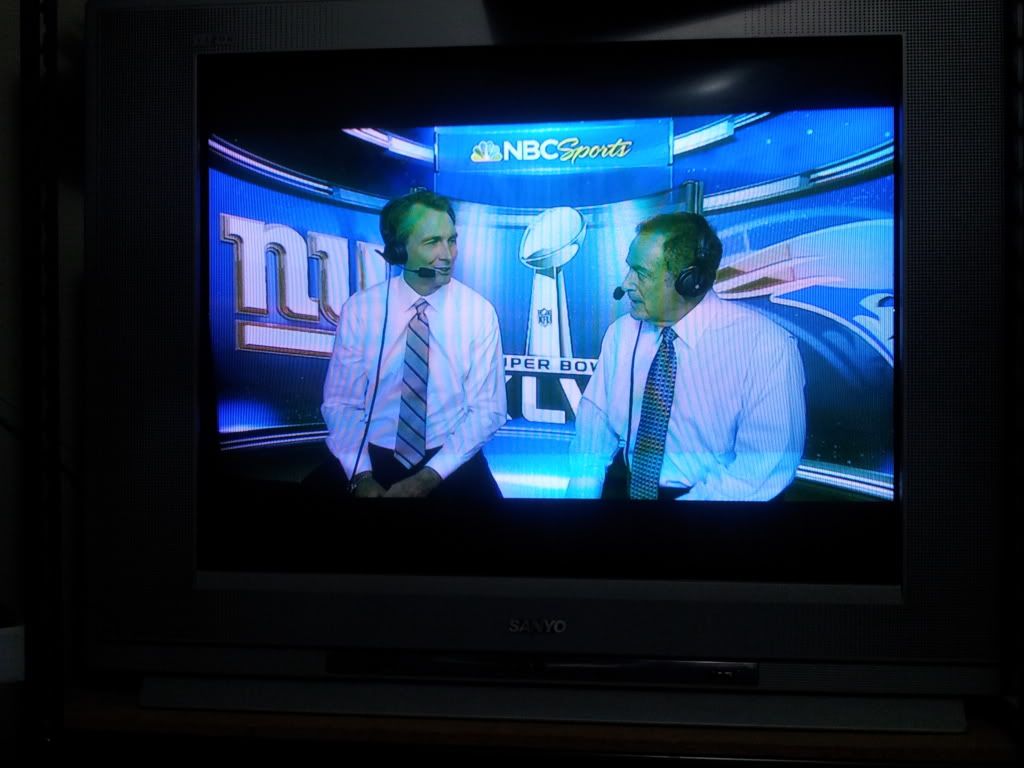

Wow! My tv screen went green during the Superbowl right before the halftime show. I know this is a common issue but I don't know what the fix is. Is the tv even worth getting serviced? I think it's the best looking hdtv set that I own even now but now that it's showing all it's common symptoms I'm not sure if I should continue to hold on to it. Then again, my budget won't allow me to get a 32" tv that looks as good as this one does.
Afroteddy is offline
post #2880 of 2897 Old 02-05-2012, 08:23 PM
Afroteddy's Avatar
Posts: 268
Quoted: 12 Post(s)
Can you seen the green tint in my picture? Also my picture slants up to the right. I have always had this problem but I'd still love to fix it.
