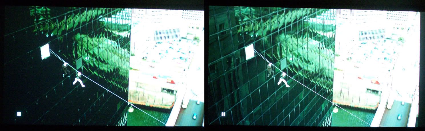

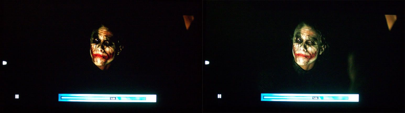

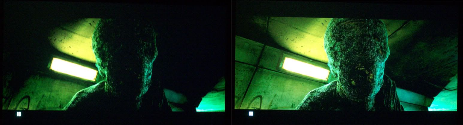

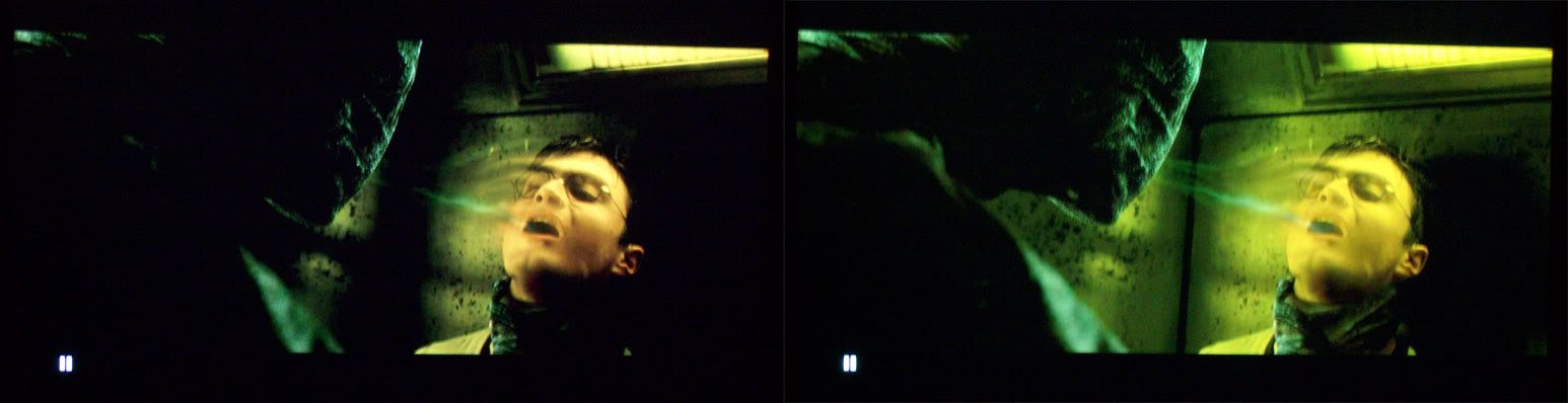

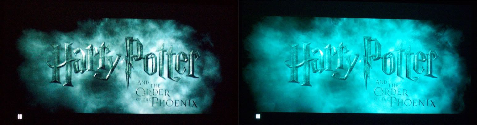

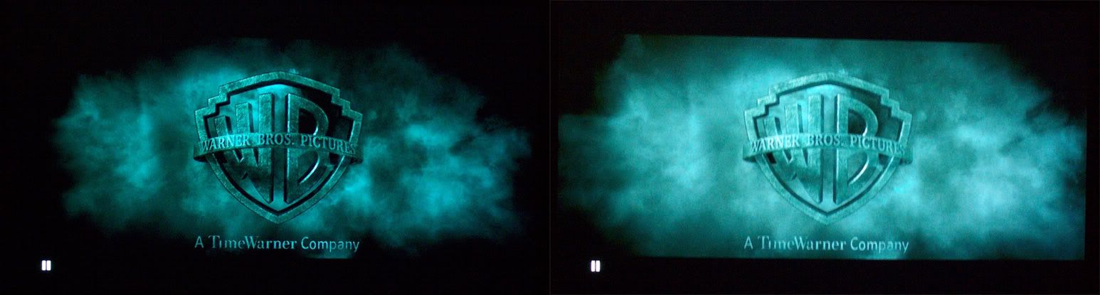

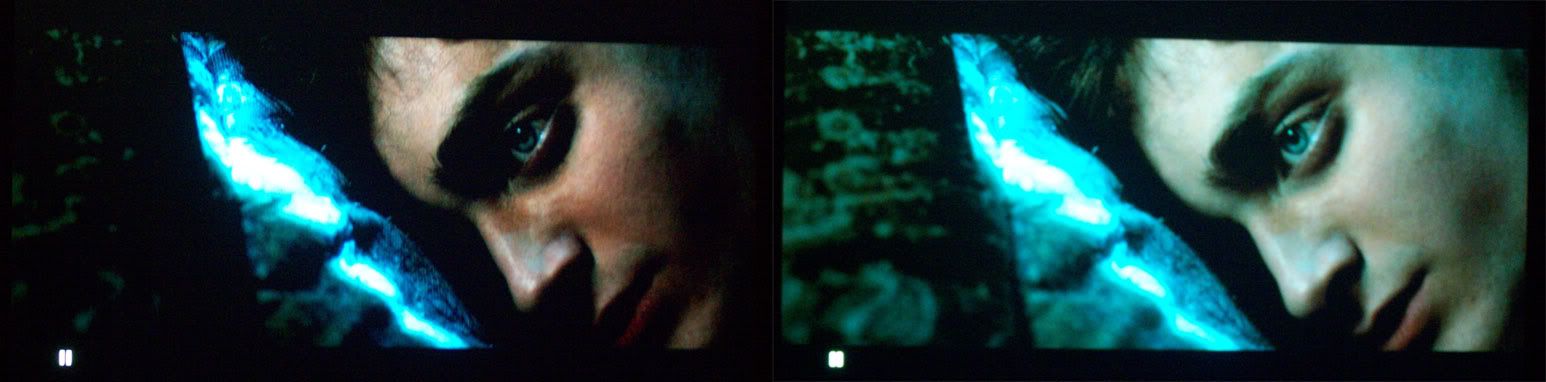

Here are some HDMI range normal vs expanded comparisons in Dynamic mode. Ignore the blue tent from my camera. The expanded range definitely has better gray detail.
NORMAL__________________________________________EXPANDED
Expanded has more detail on building windows.
More face detail with Expanded. Hard to look at Normal mode in this scene.
Normal looks better in this pic but hard to look at on screen.
Same with this pic. Easier to view with Expanded.
Expanded has more face detail and background view.
Look at the gap in the concrete wall.
More face detail.

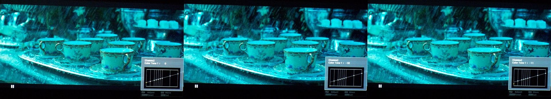

HDMI Normal Range - Dynamic
HDMI Expanded Range - Dynamic
HDMI Expanded Range - Living Room
Here is the final setting I like the most. Dynamic mode has a EE look to it. Living room removes this and adds a cooler(blue) look which makes most scenes easier to view.
HDMI Range: Expanded
Color Mode: Living Room
Brightness Control: High (Low on Cable TV input)
Auto Iris: High Speed
Gamma Tone 1: -32
Gamma Tone 2: -5
Gamma Tone 3: +1
Gamma Tone 4: -1
Gamma Tone 5-9: 0
PS3 BD/DVD Video Output (HDMI): Automatic
Bud8Chevy is offline
