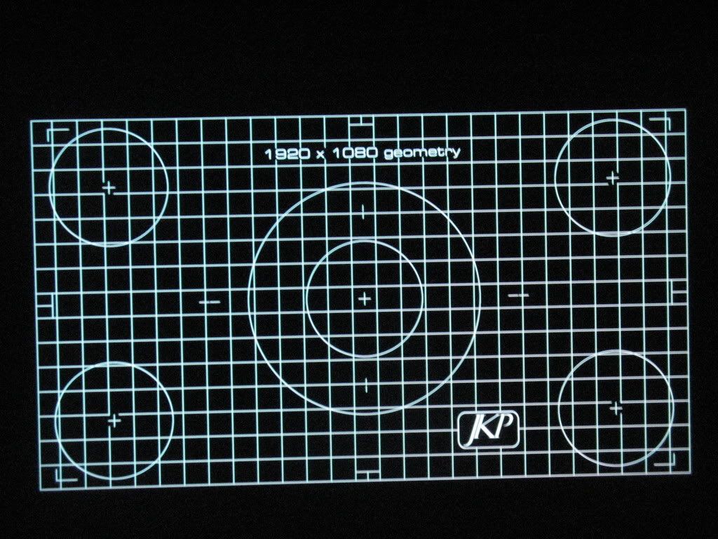

Wow does mine look blue!!!
I zoomed all the way in. Looks much worse than the ones posted before
OPINIONS???

Regarding screen uniformity, it's worth while to look at the full range of grayscale full screen IRE values, not just 100%.
Aquafire... PP are very good and you should call them to discuss your problem. I believe they will work with you.

Originally Posted by aquafire View Post
Dr A and Parksar,
Dr A Can you please post pics of your "perfect" uniformity and "decent" convergence? And Parksar your red and green all over? Parksar how many hours on yours?
I want to compare...
thanks!
You have to trust me because I mounted back at 20 feet after geting an amazing improvement in focus at 12. It was too unstable on cofee table on top of reclining seats.
I can discribe it for you. You know how sharp the middle one pixel test look on my previous post #172. All corners were identical to that. Also full screen focus test the same crispness all 4 corners. My son who is infected with this PJperfectitis sugested white crosshatch, walked closer to screen and said "this is the first time I only see white lines." Regarding uniformity I will take a picture for you today from 20'. I don't think there is a difference from 12'.
Improvise, adapt to the environment, Darwin, **** happens, I Ching.

Originally Posted by DrA View Post
Bytehoven I owe you a drink I disconnected the PJ again, moved it to the minimum distance which is 12 feet from my 120" screen and suddenly all chromatic aberrations and focus problems are gone. I did not try the maximum position because it will dim the picture more and 24 feet away will be less practical.
Interesting. I would have expected the problem to increase when you moved the projector closer and used more zoom to fill the screen.
It might be worth some testing to try the projector at various ranges and zoom settings to see how the focus issues change.
If I recall correctly, a projector position that allows for the lowest zoom setting is actually brighter, because there is less light loss thru the lens. Also chromatic aberration will also usually be less because a smaller surface area of the lens elements is being used to project the image.
However, I suppose any lens uniformity issues could be exaggerated as you move toward a lower zoom setting and expand the image with a longer throw distance.
Hmmmm, I will have to check my AE3000 a a number of throw distances.

Originally Posted by parksar View Post
Convergence/focus update:
Based on Dr. A's experiment, leaving the PJ mounted as is, I lowered zoom to min and tried to refocus. It seemed a bit better, though still off. I know this is not the same as actually moving the PJ, but candidly, I am not inclined to move my mount and rewire everything to accomodate a PJ when I am already operating well within its design limits. Plus, moving the PJ several feet in front of the back seats would bug me.
My old ax100 was much, much sharper, which shouldn't be the case, and compared to the 1080UB its not even close - the 1080 UB is razor sharp.
Zooming it back out to screen width size (approx 106") just shows how bad it is - red and green are just way off, and they are off all over the screen, not just in the corners or top, etc.
Guess I'll call PP Monday am.
Anybody else have one in the DC area yet? Would love to see what a good one looks like.
I know it's PITA to change the mounting position and agree with you that problems happen "operating well within its design limits" but unless we can get a different brand, the new AE3000s will have the same lens and may have the same focus problems at far distances. My AE 2000 had similar problems and dust blobs. I hope I am wrong. I got mine from projector point and they have 1 hour limit to return.
I would like to get response from people who have or have not the same focus problem, mounting distance and a picture of the problem.

Originally Posted by BrandonH View Post
Mine will focus razor sharp, but I'm a little worried that it doesn't seem to be holding this focus after leaving the projector off for a while, the next time I turn it back on it seems like the focus is about two "clicks" of the remote off from where I had it set. I hope I'm wrong though. I haven't tested this too many times as I don't want to keep turning the projector off and on.
Hot damn, I think i figured out my Focus problem. I didn't realize that turning that silver ring on the front of the projector affected the focus so I think when I was putting on the lens cap and taking it of that I was slightly moving that ring making my focus just slightly out of wack. I'm not going to use the lens cap anymore and will just clean it when necessary. Aquafire, could something similar be happening to you?
BrandonH is offline

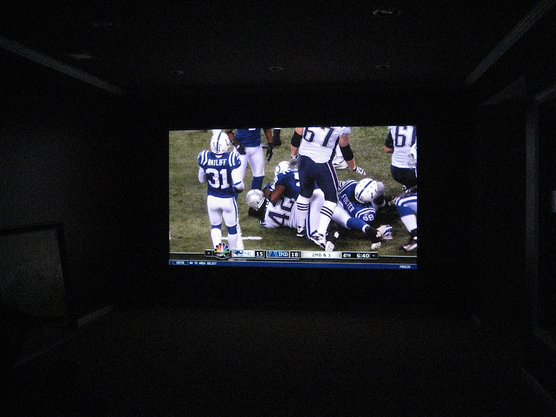

post #224 of 4860 Old 11-02-2008, 05:28 PM - Thread Starter
aquafire's Avatar
Posts: 996
Nice find! I did not realize this either. At the very least it will give me better control over the focus.
I just finished watching 60 minutes in HD and the entire show I was blown way by the image quality. Same goes for the NFL broadcasts Pre and Post game. So far Normal Mode seems to be the only one I like for all viewing.
aquafire is offline
Agreed...Normal mode is the ticket! Try these settings in a completely dark room... God I love this projector!!!
Picture Mode Normal
Contrast +10
brightness -8
Color -10
Tint 0
Sharpness +14
color Temp 0
dogone is offline

post #228 of 4860 Old 11-02-2008, 06:00 PM - Thread Starter
aquafire's Avatar
Posts: 996
Switching my settings now.
I'm always amazed at how different members settings can vary. Brightness down!!! HMMMMM let me try it
aquafire is offline
post #229 of 4860 Old 11-02-2008, 06:06 PM
dogone's Avatar
Posts: 2,296
Yeah, with the brightness down it gives it that plasma inky black look...I love it!...Watching the Colts /Pats game on Directv in HD...Looks incredible!...Try some HD local channels too.
dogone is offline
post #230 of 4860 Old 11-02-2008, 06:28 PM
jamis's Avatar
Location: Massachusetts
Posts: 1,910
A few screen shots of said game...

aquafire,
I took my uniformity picture in normal mode.
I took convergence picture when projector mounted 20' away with no lens shift. That is why it shows only bottom 2/3 of the screen. no lens shift makes it better.
Zooming out also makes focus better from 20'. off course
picture is smaller now.
Surprisingly moving the PJ to the closest limit from screen in this same Zoomed out setting makes the picture extremely better. Maybe when zoomed out picture gets bigger in the front CA artifacts get less crowded around good pixels? plus brighter light make artifacts less prominent?
