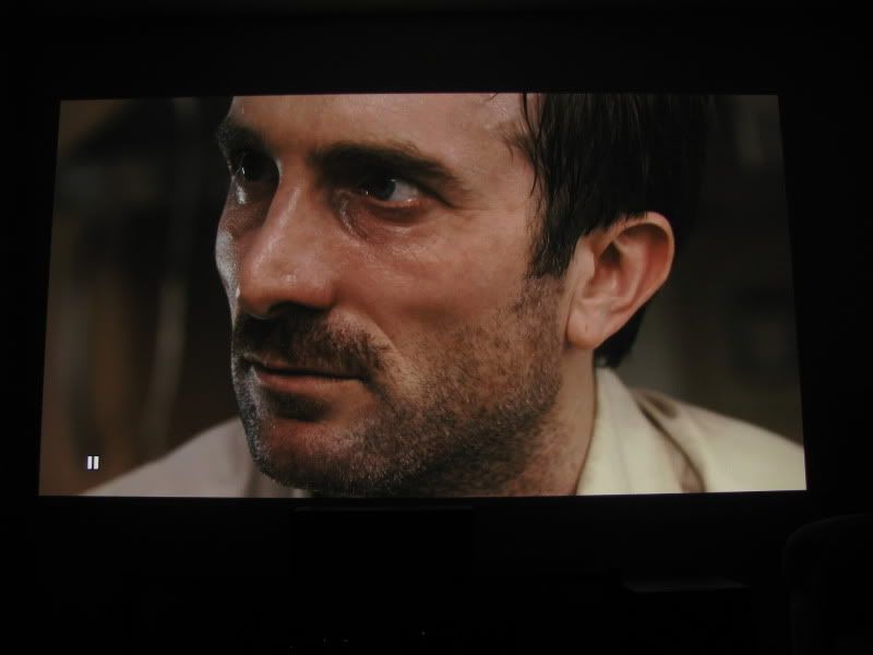

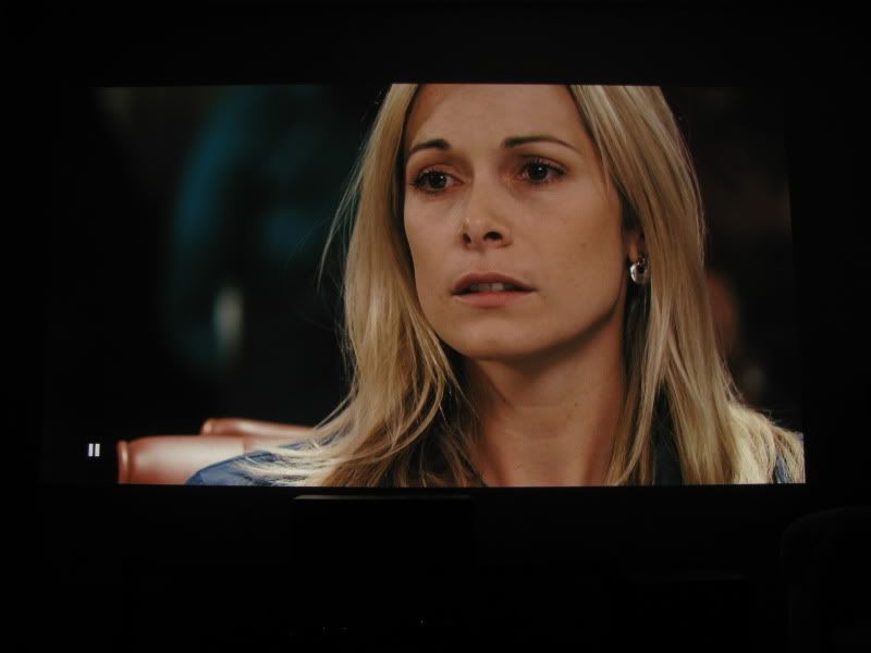

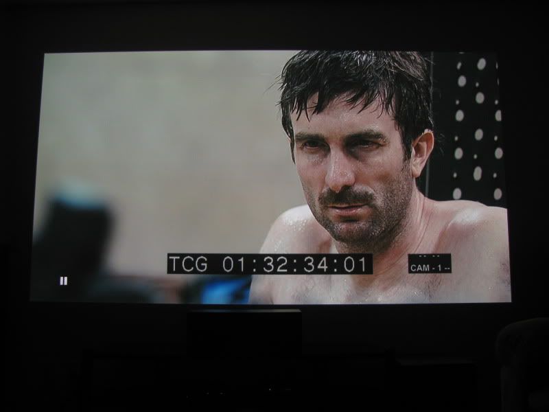

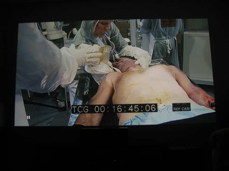

some pics I took with natural default settings
mrTAPOUT is offline
