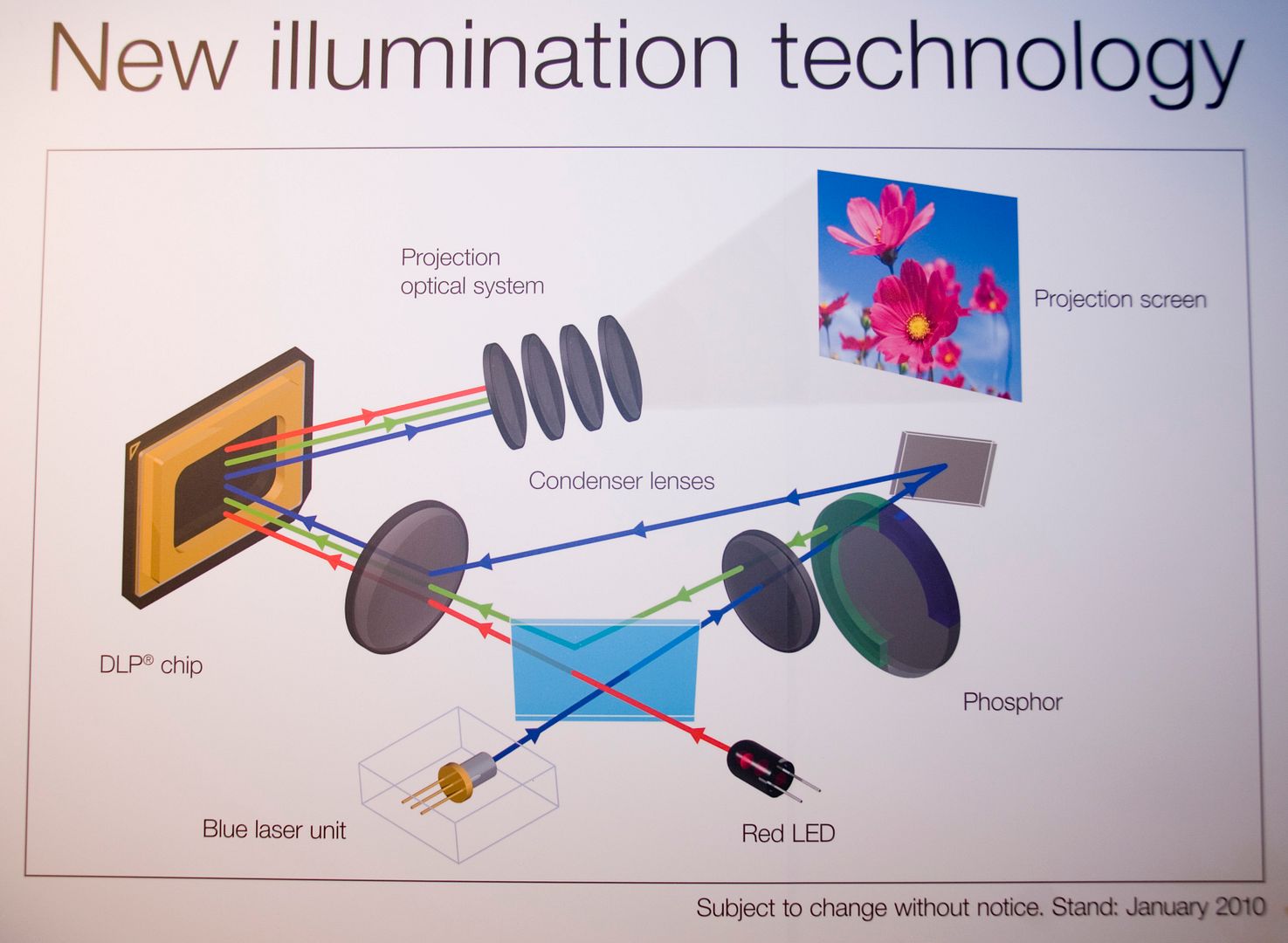

Originally Posted by vsv View Post
RED & GREEN is lasers, BLUE - LED ?
It uses a Red LED and a blue laser. Green comes from a phosphor wheel, part of which is clear to transmit the blue laser light and part is covered with a green phosphor to convert the blue to green.
link: http://displaydaily.com/2010/01/07/f...-mercury-lamp/

Here are some photos of Casio projectors from the ISE 2010 in Amsterdam
http://img.photobucket.com/albums/v1...DSC0102051.jpg
http://img.photobucket.com/albums/v1...DSC0105054.jpg
http://img.photobucket.com/albums/v1...DSC0107055.jpg
and the slide showing the optical path.
Thanks go to javierg for these photos (for the whole report from ISE 2010 in Amsterdam go to http://www.avsforum.com/avs-vb/showthread.php?t=1224478 - warning bandwidth intensive)
brbrbr1 is offline
Well, i guess i wasn't entirely wrong in advising caution (post # 66 on this thread) concerning this "mating of technologies" which now turns out to be even weirder than i imagined : LED + Laser + color wheel ? WTF, Who would have thought ?
It is understandable that Casio wanted cost savings while increasing the projector's lumen output, both commendable endeavors, but not at the price of having to include a color wheel into the mix.
If i remember correctly, TI published a paper years ago in which the company estimated the MTBF of color wheels used in DLP engines at approximately 25.000 hours of use, so Casio's estimate of 20.000 hours lifespan for this illumination source would appear to be mostly due to the color wheel being used.
However, at what cost : more control parts, ancilliary equipment, generated heat, noise, etc, etc...
