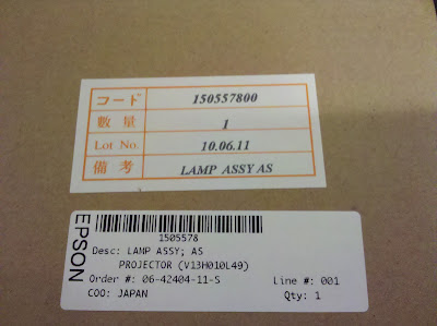

I got my projector about 3.5 months ago and have 355 hours on it. The other night my wife and I were watching a movie and the image was horribly dim in Theater Black 1, I switched to Dynamic mode and the image was still much dimmer than it typically is in Theater Black 1. We finished the movie, and then the next night, I turned the projector on and after about 60 seconds of the power light fading in and out, the lamp indicator started flashing red.
I called Epson and they are sending me a new lamp. They said if this lamp fails too, they'll send a new projector.
It's too bad that these problems seem to be common on this projector, but I'm very happy that Epson is so willing to help resolve the issue.

My replacement lamp was delivered yesterday. I installed it and the projector fired right up. I forgot how bright a new lamp is
Hopefully this lamp will last much longer.

Hi, with the replacement lamp/globe, was it made in Japan or China?
I know the original one was made in China but just want to know if the replacement lamps/globes are the same quality made in the same place as the original.
Thanks mate
My replacement bulb was made in Japan.
