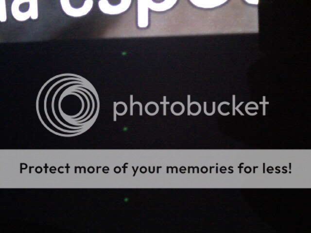

Yesterday I finally had time to test my new 8200- first thoughts:
It does offer a good image quality (at least compared to my Panasonic AX200).
To be honest, I actually had higher expectations since the 8200 is 1080p (the Pana is 720p native), but playing around with a few blurays proved only a slight improvement in terms of image clarity (at least on my 80" diag screen and sitting at a normal distance)- the viewsonic does provide the sharpest image.
I did not find the 8200 inferior in any way compared to the AX200 (even with default modes)- My first impression is positive in terms of image attributes, but I do have a problem to report...
When watching an HDMI source, I can see four annoying white dots on the bottom part of the screen- like some sort of overly sized dead pixels.
I tried 3 different HDMI cables (even the included short one), and the problem persisted on both HDMI1 and HDMI2 inputs.
I then attempted using different sources; tried an upscaling Philips DVD, Samsung Bluray, PS3 and Macbook DVI to HDMI- problem continued.
After playing around with the remote I finally found a way of making the white dots disappear:
You have to FIRST select the PC 1 input and THEN switch to HDMI.
If I'm watching a video over the composite (yellow) input and then switch to HDMI, the dots are back!
I've come to the conclusion that this is most likely a firmware glitch (since I can easily make it go away via the remote)- If anybody is having a similar issue, please report.

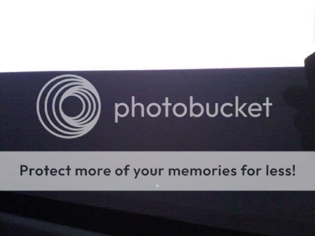

post #67 of 1111 Old 01-16-2011, 02:32 PM
ro2207's Avatar
Join Date: Jan 2011
Posts: 49
Quoted: 18 Post(s)
Thanks for the reply,
I'm also experiencing 4... They seem to appear equally spaced and at exactly the same place every time. Sometimes they are just 4 horizontal dots ( . . . . )
I've also seen this pattern:
Here are some pics I took while watching a 2.35:1 aspect ratio bluray movie (the spots are visible in the bottom black bar).
If this is an HDMI cable quality related issue, why would it happen with the 6 foot "viewsonic" labeled HDMI cable that came with the projector?
The AX200 has always worked flawlessly with my Belkin PureAV v1.3 cables.
The fact that I can make the spots go away with the remote makes this even more suspicious. I will keep informing...
-The dots are green rather than white as I originally posted.
ro2207 is offline

Those definitely aren't from a cable or source. Is it stuck in service mode or something, the projo almost has to be displaying those.
Mine were from a cable. They went away when the projector was displaying its splash screen / test modes. The problem went away as soon as I replaced the cable.
This was a ~3 year old cable that had been working perfectly with 720p signal. Spots appeared within 2 weeks of sending a 1080p signal. I know that even the old HDMI cables are rated for at least 1080p, but my experience was that replacing the cable solved the problem.
ro2207's problem is interesting, though, because it is VERY similar to what I saw, in a similar location on the screen, but mine were horizontally lined up whereas his are vertical. Strange!

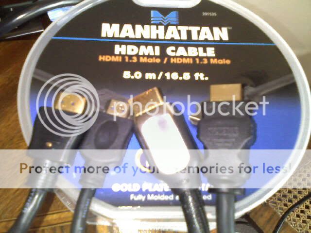

"This was a ~3 year old cable that had been working perfectly with 720p signal."
Although 720p native, the AX200 accepts 1080 60/24p (that's what it has always seen through the HDMI port via my belkin cable for the past 2 years without a hiccup).
To rule out any cable fault, I've bought a brand new HDMI cat 2, 10.2gbps certified cable- same results regarding the dots - (mine are also lined up horizontally almost all the time, the other pattern from the pictures I took only appeard once or twice the first time I used the projector).
News: The dots never appear when sending a 720p image (just with 1080/60 or 24p).
You can make them go away by pressing the PC button OR the Component button before pressing HDMI.
Once they no longer appear, they will not come back unless you press the VIDEO key or (probably) if auto detect source is set to ON.
These are 4 of the 5 HDMI cables I've tried (you can see the package of the brand new one). All of these display a 1080p image on a Sharp LCD and my older Panasonic projector without a problem.
tremor13, I was hopping a faulty cable could be the answer, but not in my case. Maybe you don't use the VIDEO input, but if you press that button and then switch to HDMI the dots might come back.. just a thought.
ro2207 is offline
