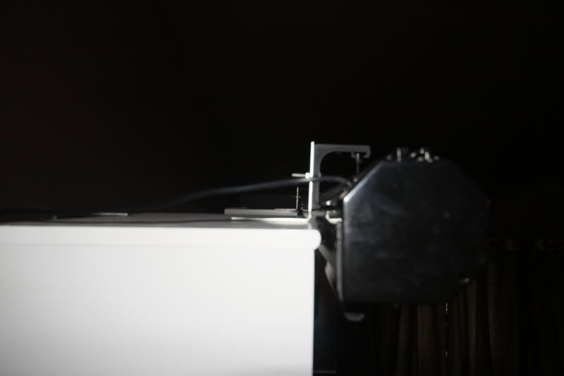

So, here are some teaser shots - pictures and build write up to come...
The glare in the second pic is in the movie. More to come.
