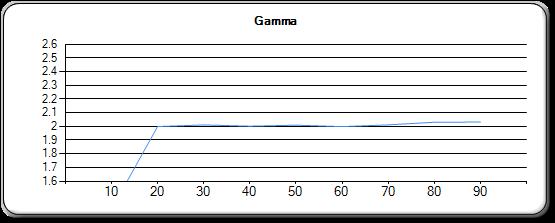

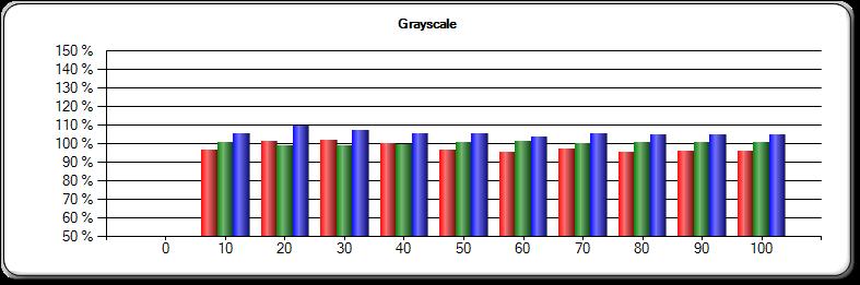

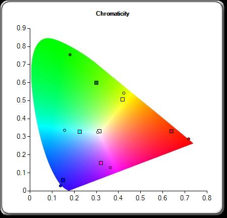

bump for those who might have missed this from the end of the previous page.
The gray scale is decent, blue is a little hot here and there depending on the IRE and red is down a bit, but overall I have seen much worse from projectors 5-10x the cost of the QUMI including my JVCRS50 where red is down 20% from blue and green and requires pulling down large amounts of blue and green to get a clean D65 calibration. This is at the cost of lumens.
If there was a way to pull down the blue a bit, red would come up and it could be near perfect.
Gamma with mode set to 'video' is a flat 2.0. Some projectors are awful at tracking gamma across the entire range.
Chromacity - Green and red are hot, the saturation needs to come down a fair amount for both. This accounts for the popping colors that some folks seem to enjoy. I don't mind it, but I do wish I could tone it down a few notches.
Notice how close the white point is to D65. Not bad at all for such an inexpensive projector. This accounts for the positive comments on the face tones.

Overall I am pleased with a relatively level gray scale. This usually requires adjustments to get this close and of course it would be nice to get it even better if it had adjustments. I would like to see a way to control the saturation of at least the primary colors. Toning down all 3 primary colors would get this closer to a Rec 709 color space.

zombie10K >>> Thanks for the great pictures showing grey scale and color points for the Qumi; Very, very informative...
On the chromaticity chart i was suprised by the huge amount of color green being displayed and yet how it manages to get the secondary color yellow so close to ideal.
Color red manages to be oversaturated and yet in the right direction of the "triangle", so i'd imagine that onscreen reds would appear "right" (not too "orangey") but capable of showing much "deeper" shades of crimson reds.
The color point for blue is pretty close to ideal and secondaries for magenta/cyan are acceptably close (mostly), so green seems to be the main "problem" here; Where's that CMS when you need it so badly, ain't it ?
As for grey scale tracking, that is a pretty good performance : all you'd need to fix it would be a surprisingly linear and small "cut" on blue from bottom to top of scale and a small boost on red mostly in the middle of the scale.
I would venture to say that even with your findings for colorimetry/grey-scale tracking for the Qumi, it still provides a rather accurate grey-scale (i've seen much/much worse) and color points that, although way oversaturated in green but less so in red, cyan , magenta, would satisfy almost anyone with the exception of "purists" who disdain any amount of color oversaturation.
Personally, as long as i can get colors for human skin to appear onscreen as close to real as possible and i don't really notice any major, obvious artifacts,
i really LOooove those oversaturated LED colors, especially crimson reds, deep purples and "Caribbean cyans"...Go ahead, flame me for my lack of "calibrationisis", ha !
Anyway, thanks again for the pics and keep them coming along with your impressions of comparisons between the JVC and the Qumi projectors.
I'm with you on the skin tones. They have to be correct before anything else in regard to image quality. The QUMI excels at skin tones for this price range. The gray scale is better than most projectors out of the box costing a considerable amount more. It would be great to pull than blue down a hair then it was be dead on, but still pretty good overall.
The color range of these LED's is impressive. During the measurements of the 3 individual primary colors are some of the deepest colors i've seen from a display. They could easily pull them back in the software to tone it down a bit.
This projector has been a lot of fun so far. Considering something this size capable of 300 lumens and 720P HD resolution in a box the size of a hard drive would have looked like science fiction 10 years ago. This is remarkable technology to allow such a nice picture from a device so small in size.
