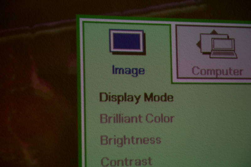

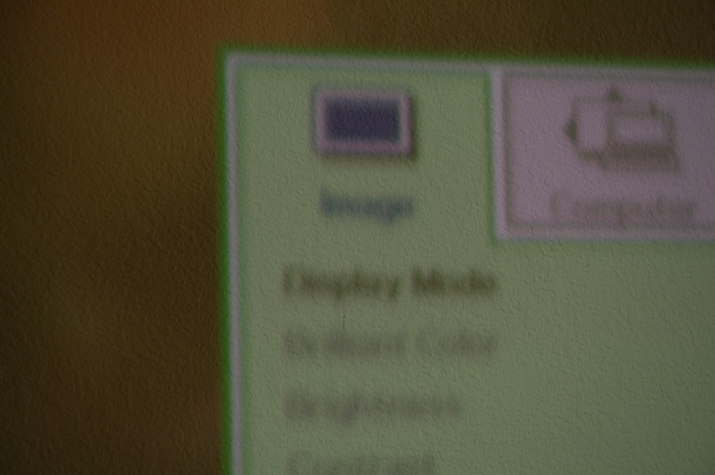

I took a couple of pictures of the focus shift issue on my Qumi. Are other users experiencing less of a shift?
Here's the focus when fully warmed up:
And here's what it looks like right after a cold start:
It takes about 20 minutes or so in my case for the focus to stabilize.

Mine is nothing like that after a cold start, the menu is clean and readable. I turn it on and I'm able to start and view a movie from USB in under 30 seconds.

I could adjust the focus so that it looks good after a cold start, but then it would go out of focus as it warms up. The question is whether others are experiencing the same degree of focus shift over the first 20 minutes or so after turning the projector on. I suppose it's also possible that it depends on the size of the projected image. Mine is about 100".
That looks a little worse than mine, here is a capture of it:
I also don't think it takes 20 minutes for the focus to snap in, but I haven't timed it.

It could be size dependent, since I'm only at 82".

I'd say mine was 80-90% of the way there at 15 minutes, but continued to improve until at least 20 minutes. At 10 minutes it was still pretty bad.
