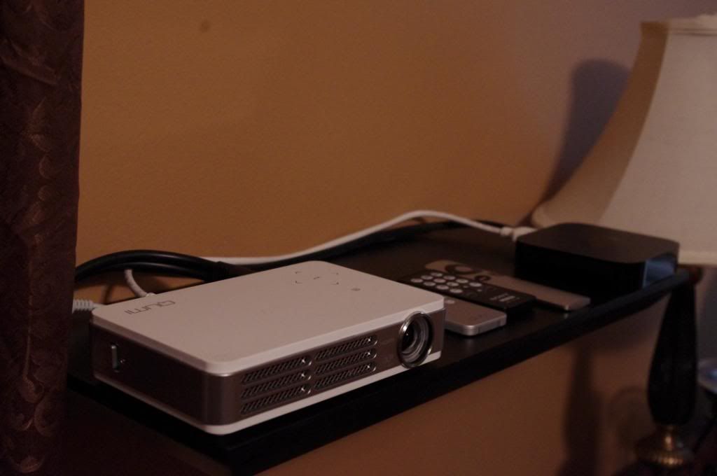

post #1875 of 2197 Old 05-10-2012, 06:39 PM
action_jackson's Avatar
Posts: 1,184
Quoted: 341 Post(s)
Liked: 128
Here is mine, a simple shelf mount with an Apple TV providing video.
