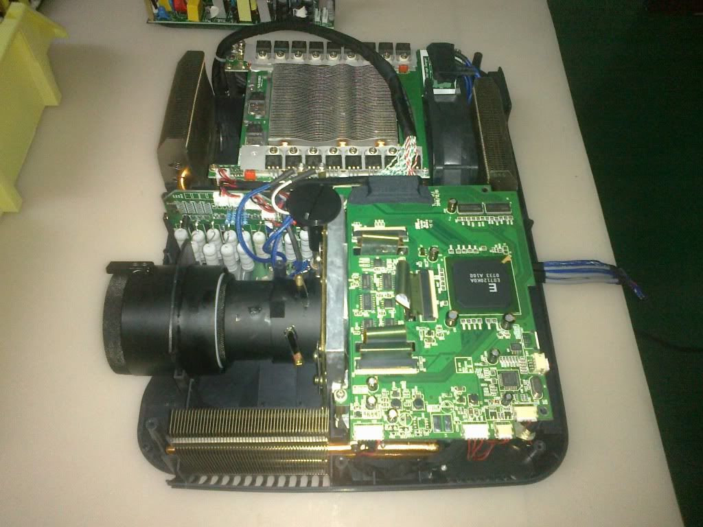

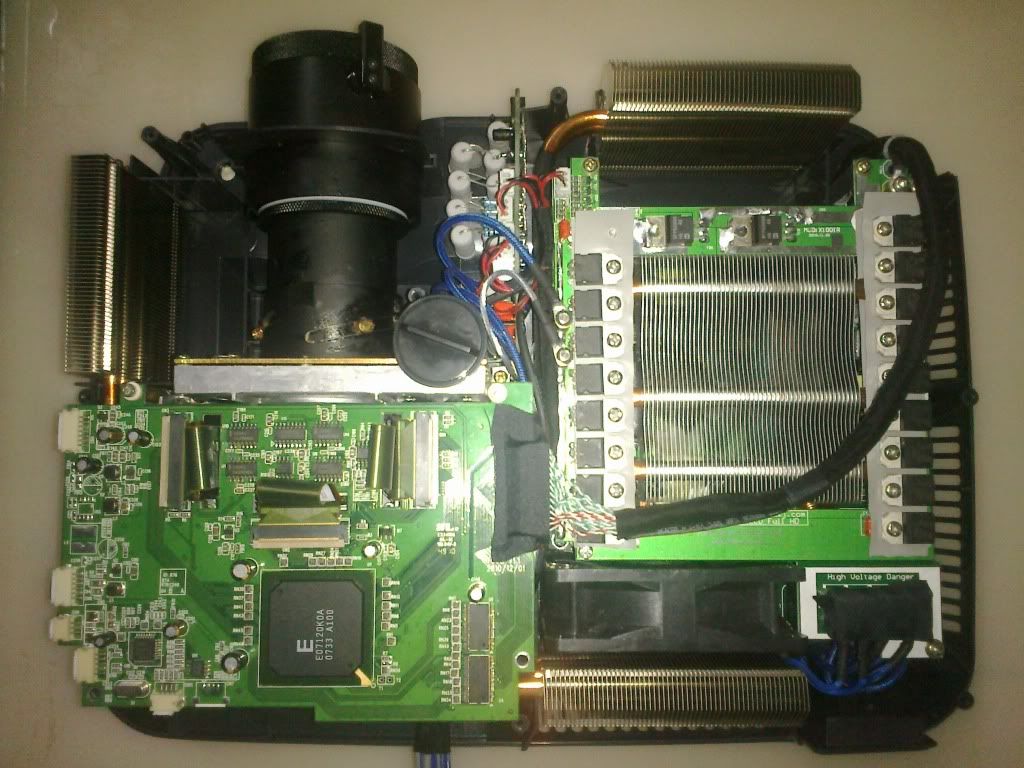

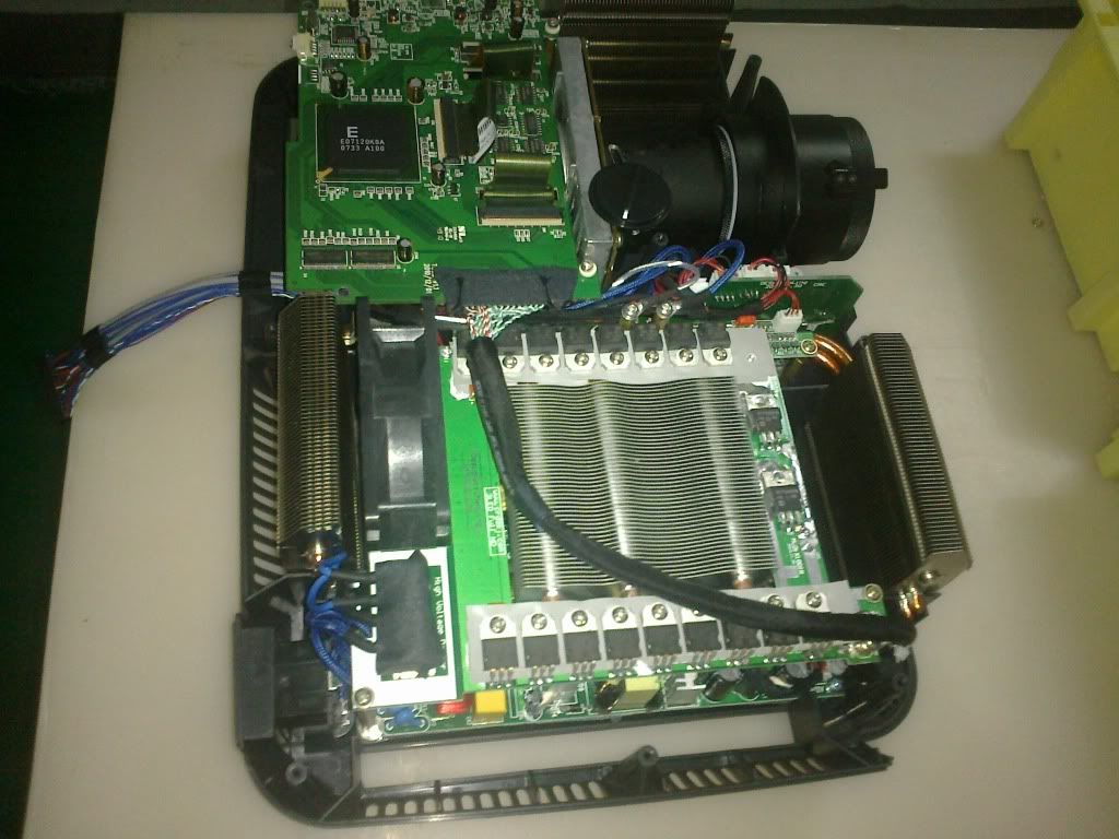

OK this is the moment all you technical nerds have been waiting for..
Pictures of inside the X1000 + our questions answered!
Click here for size 1024 x 768
They have answered our questions tho number 5 i believe got lost in translation tho we know anyways its aN organic panel.
1. Alot of people have asked for pictures of inside the X1000. please be so kind to provide.
See picture A,B,C attached.
2. Can you tell or show us if the LED s are located behind the LCDs?
Yes,LEDs are located behind the LCDs.
3. Can you show us X1000 picture of cooling heat pipe &
airflow for light path.
4. Do you use good quality transistors, capacitors, resistors
inside x1000 for long life reliability.
Yes, of couse. We use good quality transistor etc to extend the whole projectors life .
5. Do you make an non organic D7 panel version of the X1000.
D7 LCD is origin from EPSON Japan ,it is with good quality , trustable .
6. Does the x1000 filter out or produce UV (ultra Violet
light or Infrared light?
LED light doesn't produce UV and Infrared light . It is Green products.
7. Does the x1000 have a sealed light path / Optical system
Yes ,X1000 is a sealed optical system to protect all inside optical parts.
8. For 3000 lumen output,In final tests of lumen measuring,after the light has passed through the projector light system, the lumens should come down to a value of between 400 to 1000+ lumens. Do you know the actual final lumen number?
Yes .it's true , final lumens is 800 lumens on color light .
Some curious people have asked about Hollywood Studio chip.
9 Can you tell us, do you have x1000 containing the VX
class with Hollywood studio chip & GX class Pixelworks available to buy yet.
At present ,we don't have this type made yet.
Wow, well there you have it, pictures and all!
Get out the magnifying glass & Lets hear your thoughts!

I never imagined they would actually answer all your questions and send the pics you requested, AMAZING!
It appears that there is a heat pipe cooler for each color. One fan pulls the air our the rear of the case. Looks like there is room for a couple more fans, one behind each cooler. Where is the filter located again?

After studying the photos, it looks like the filter goes in on the right side of picture A, or the bottom if looking at picture C. IMO it would cool much better with a fan on each cooler blowing out as it sucked air in at the filter. With the single fan in use it appears that the unit would suck air in at three locations: the filter, the front cooler, and the side cooler. The air then exits through the rear cooler and out the rear of the case.
With the current set-up, IMO, it would be pulling in dust through the front and side coolers.

(looking at the lens straight on etc) The dust filters are located on The left and right side of the projector. The medium side filter is on the left hand side,and the smaller filter is on the right hand side.
They slot out from the bottom. I didnt see one on the front vent, but may have not looked properly.
The lens anamorphic question i`m unsure, as my PC graphics card does all the stretching. You can search the manual, ive posted it here

The question we asked to them specifically about if the LEDs were located behind the LCD was to determine the brightness of this combo technology, which fits bohannas theory that if they were alligned like that, then it would maximize lumen output.

I still have a few questions about where the LED's are actually mounted. But this thing looks to be almost hand built with some traditional components that I never thought I would see in here. Don't get me wrong I think it's a good thing as they are typically underrated and more reliable than some of the newer allinone parts. Another thing I would like to point out to you lumen fanatics is you will NEVER get high lumen output without sacrificing contrast ratio's. The brighter you make the projector the lower the contrast ratio. That is one of the reasons I prefer the Business class projectors for watching TV especially sports. If I get a chance I will try to digest what I see here and report my opinions back. Until then thanks to SMJ and all the others who have made this thread so dam interesting.

It's too bad no pictures were sent with the PCB covering the LEDs removed. The only logical place to mount the LEDs is behind the LCD, one to each of the three panels. You can see three heat pipes leading to the location of these LEDs in the pics.

As i pointed out several posts above, all 3LCD engines that use separate R/G/B LEDs for illumination, just like a standard bulb that splits the color into R/G/B and send each color to a separate LCD chip, MUST HAVE THE LIGHT SOURCE BEHIND EACH LCD PANEL ! It's known as a transmissive technology, vs. reflective which is used for LCOS and DMD chips...
According to the test of the Samsung FM10 at Cine4Home, which use a similar arrangement of 3LCD + three Luminus Devices LEDs for illumination, it measured very close to its spec of 1.000 lumens, the reason apparently being that the LEDs in a 3LCD engine have to be on a constant state of maximum output and do not possibly offer any type of "dynamic contrast" as is the case with one-chip DMD projectors from Texas Instruments, which allow for dynamic contrast as the LEDs can be dimmed at will depending on image content.
If i understood the German~English translation, that could be the reason why a 3LCD + LEDs projector such as the CRE X1000 does put out indeed 800 lumens, and after calibration it wouldn't surprise me if it measured at 650~700 lumens...
It's unfortunate that on the pictures sent by CRE they didn't think of moving aside the two circuit layer boards on top of most of the unit and turned the projector ON so that we could see that elegant arrangement of three bright R/G/B LEDs shining behind each LCD panel. Such a picture is shown for the Samsung FM10 review.
Now, as for the CRE X1000 having a contrast ratio of 100.000:1, that's another story that i doubt very much; I would expect it to be more in line with tested pjs using Epson D7 LCD chips, which consistently measure about 2.500:1 natively, without the use of any dynamic contrast feature such as dynamic iris.

Of course the LED's are mounted behind the Panels,,, What I was asking was are they filtered or Mirrored before they are shot through the prism assembly?? Put another way,,,, is there any Kind of Buffer or polarizer between the actually LED and the LCD Panel and if so is it replaceable?
The standard LCD projectors currently rely in a 65K white light that is filtered and split into three main colors like the original three gun/tube projectors. The convergence happens within the Prism assembly before its shot out the lens and on to the screen which makes pure BLACKS difficult to reproduce since you are using a WHITE source. I am assuming that the RGB LEDs produce a better level of dark colors since they are not as white as the conventional light source .
