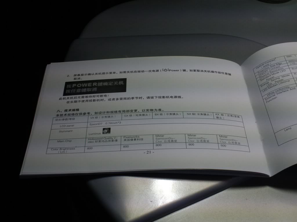

Another intresting bit info u may like is that i looked at the manual, even tho its chinese, there was some english writing on the specs page
heres what is says:
Resolution 1984*1088
There a bunch of other stuff written i`ll have to take a snapshot as i`m not sure exactly what model it is, as the chinese headings are listed as
VX, GX, BX, NX,KX, which is confusing as the cover of the manual says its a CRE X 1000-HT.
Under the various BX , VX columns is listed more info for other models i`m guessing.........
i.e For main chip info under the GX column it says Hollywood quality V-ideo.
Under GX it says Pixelworks,
Under BX, NX, KX it says Mstar Semiconductor.
What i`ll do is take a picture of the specs page from the manual; when i`m allowed to post links here and hopefully someone can make sense of it.

Thank you for your answers, sellmejunk.
You just gave us another hint of the "innards" of this pj by mentioning "Pixelworks", which is a highly respected manufacturer of video processing chips, up there with Abt, Anchor Bay, HQV Realta/Reon, Marvell, etc; So that's another very encouraging point concerning the quality of parts used.
So far i see native 1920x1080 Epson D7 LCD chips + Luminus Devices PT-120 LED chipset + Pixelworks video processor, all currently near or top-of-the-line electronics.

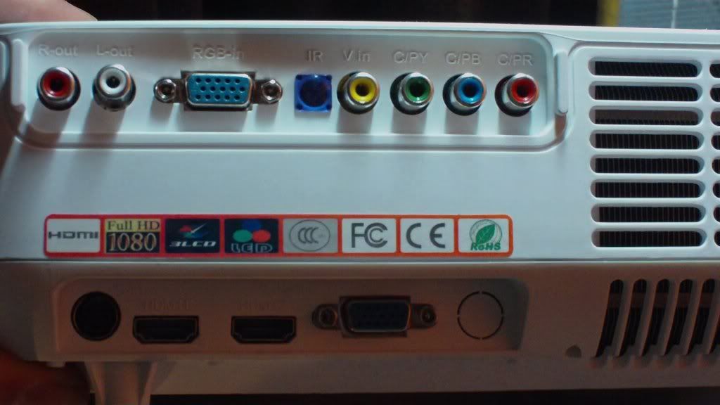

What i am most interested now is how well put together are the input/output connectors AND the pixel alignment for all three LCD chips displaying an onscreen grid test pattern, especially considering that these pjs are being sold and shipped individually from China, with all the rough handling and banging that implies.

Ok, ports + the spec page of the manual.
1stly to adress the ports, & quality of the unit, i think it looks great it isnt too bulky,looks very much like the Epson TW`s. The ports on the back around the HDMi are illuminated with green lights eminating from within the machine. the ports seem of decent build.
http://i657.photobucket.com/albums/u...X1000spec2.jpg

urm.... wouldnt let me put the 2nd spec sheet picture directly but the link to view it,is above at the bottom of the last notice

yeh, the power is off in the port picture, lol i`ll post some more pics tommorrow , it does got eerie lights!
