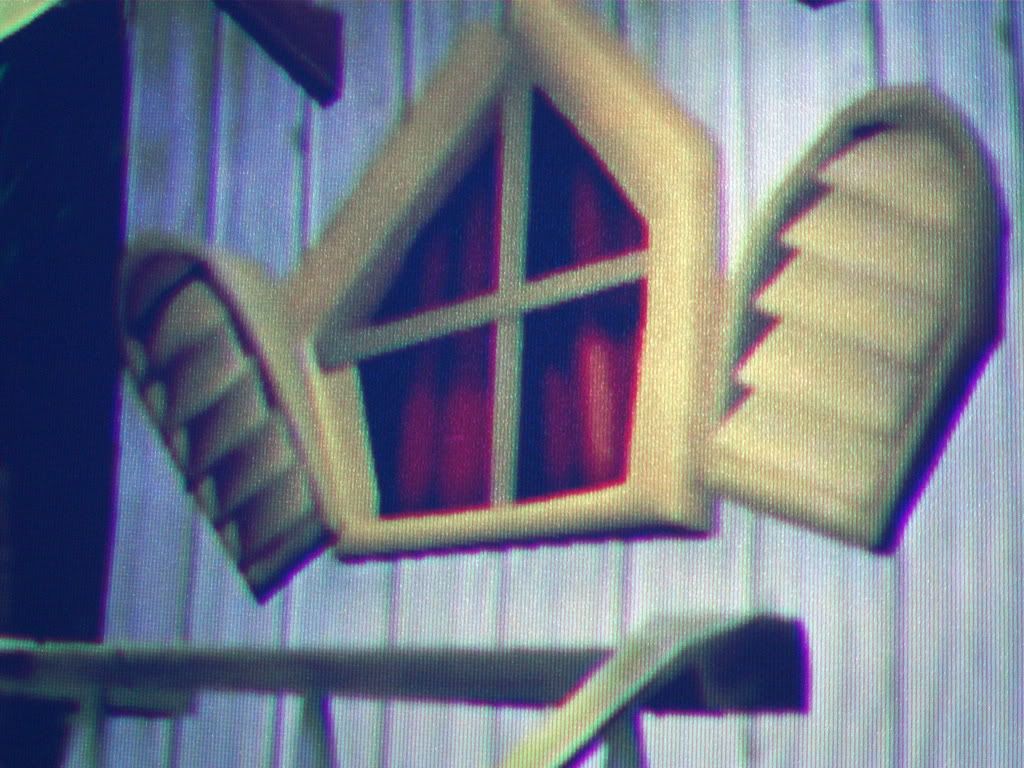

overall it pretty darn good, yeh theres some noticable lines sometimes with gradients, barring but its not noticable, anyways i`m not too techy & havent got a mitsubishi or epson to compare it too.
Heres a clip hopefully will reveal the answer your questions.
(Projector has been running for 4 hours at the time of this clip. Yes it gives out some heat i would guess just above 40 degrees Celcius )
Perhaps if i buy a decent HDMI cable it would improve the picture, i`m just using the HDMI cable that came with it, it anyone recommend an affordable one with excellent quality, or is it worth a high end cable?
Thanks for posting the video. I see some banding on the right side of the image, is this noticeable? Most around here use cables from Monoprice or Bluejean as they are good quality at reasonable prices.

But with out a BD player/disk those artifacts may be a result of your video card or the connection. IN NO WAY am I suggesting you are doing anything wrong, I'm just reminding the gallery, this is what the projector produces using SMJs set up.

just so u know monkey island does indeed look dark, as the hdmi colors were different from the VGA colors i had used from fiddling with the projectors settings, i havent found that right blend of technicolor yet.
HDMI mode grays out hue controls also.
I must fiddle with catalyist colors and the PJ.
