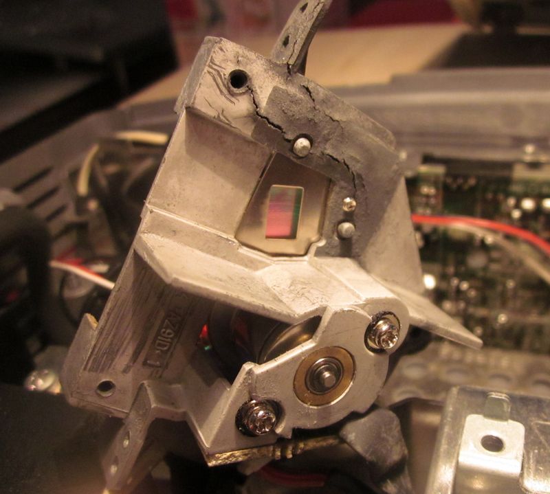

Just adding to an old thread, but the info is relevant. I have a HC3100 projector which has been good to me for some 6 years. I'm on my 5th globe now. As mentioned above the color wheel dilema arose a while back in my projector. I asked Mitsubishi the cost of a replacement - $450 + shipping. A little scary so I bought an OEM part from Ebay for $100. Decided to strip down the projector on the weekend to fit the new wheel. Bit of a task - took around 2 hours. What I found was most interesting. The noise that the wheel is producing is actually a mechanical sound. The wheel was actially hitting the wheel housing. Looks like over time, the wheel has built up enough heat to start skimming the housing, this has led to massive heating and has warped the magnesium housing and severley cracked the housing - all over. So looks as though it's not just the wheel causing the problem. I believe most of the spinning wheel failures mentioned will also require the housing to be replaced as well. I spent the time to modify my housing and then fit the new wheel. System now works like new again. I would expect that if I sent the projector to Mitsub for repair this would have cost in the region of $900 to repair - wheel , housing and labour. Just for interest the old wheel was still working perfectly, just had terrible scratches - which rendered it unuseable.

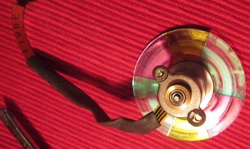

Possibly - but I reckon the color wheel had clocked up some 12,000 hours. I'll try and upload some pics tonight of the wheel housing showing damage and scratched wheel.
S4Simon is offline

Pictures as promised. One of the housing, still with colour wheel inside. You can see the cracking. But what you can't see is that the whole housing is warped due to the heat. Also all the screwss were welded in due to the heat. The other pic is the HC3100 color wheel showing the scratches.
I'd say a knowledgable electronics shop would take 45 mins to an hour to change out the wheel and housing. If I had to do it again I'd say 60 - 90 mins required.
