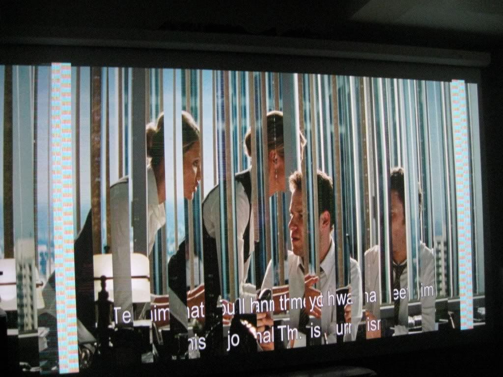

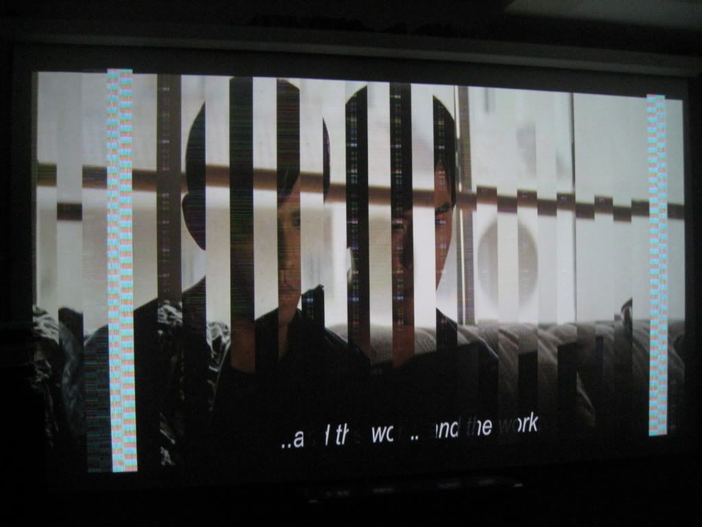

Hello guys! I'm very happy with my HC4000. It's now at 80Hrs used lamp and PQ is really great. Hope it will improve more when it run at 100hrs. However, it was the other night when I experience problem with my pj..it shows distorted video as shown on below pics. I turn it off for a while and turn it on again and its gone...back to normal.. now it happens often when I watch BD movie.
Anybody experience the same issue with thier HC4000? What would be the problem..btw, im using 35ft mono price hdmi cable.
Appreciate your inputs.

Yah, I had the same problem on mine, exactly the same.
I never tried very hard to fix my problem since I was not certain if I was keeping the PJ or not.
Access HERE from this thread

Yah, I had the same problem on mine, exactly the same. Another poster had the issue as well and he stated it was just the HDMI CABLE (get a new cable).
Basically I also think it's just the HDMI cable or the HDMI switch (usually the cable).
There is a cable length setting in the Mits menu somewhere (forgot where), and you can try adjusting that.
If I had to guess from an electronics / cabling standpoint, it might be the OHMS being just slightly off on the thinner or longer cables, or it could be the cable is picking up some interference from nearby power cables (possibly EMI). That might explain why it happens randomly, but newer HDMI cables (and ones that are thicker and newer) are better insulated and have more capacity for keeping a singnal more uniform. Make sure to get one of the newer spec'd HDMI cables.
thanks coderguy. yah I'm thinking the same..HDMI problem. What I did is I changed my HDMI cable from 25ft to 35ft HDMI mono price brand but I still have the same issue. quite annoying since you have to turn it off and on.

That's the vertical checker-board line of death screen.
With the HC3800's it was never a hdmi cable or switcher problem, it was internal to the PJ. It was one of the main teething issues the HC3800 had in the beginning and it is strange that it has popped up a couple of times here on HC4000's.
FWIR, the poster who had the same issue with the HC4000 sent the unit in for an exchange/repair.
There were some cases in which it popped up on the early HC3800's a few times, then didn't come back until weeks (or months later). In the end, it always came back to bite. Usually this problem only gets worse.
Mits support has always gone forward to fix the issue with an exchange or repair of your unit, they've never mentioned that it was a HDMI cable or switcher issue.
And BTW, one of the early HC3800's I had developed this checkerboard issue early on. It only got worse and it showed up even on the Mits internal test screens (black, white, crosshatch), so that shouldn't have anything to do with hdmi handshaking, and I believe (though can't remember exactly), that it didn't go away when the hdmi cable was disconnected. Mits CS instantly sent out a exchange unit.
You need to call Mits CS and mention the checkerboard on-screen issue, they'll know what you're talking about. And you have pics to email them anyway....

OK, I thought another poster said it was his cable. I guess this entire time I've had a bad unit as well then, figures.
Did you try changing the cable length in the service menu from 0-10m (default) to 10-20m?

Should be the same as the HC3800, and it's not in the service menu, just the regular menu accessed by the remote>>
Settings - Language - leave the cursor on your language - press Auto Position, Enter, Auto Position

I shipped my Mits back today since it had the checkerboard of death, but I might re-purchase it somewhere else later as a TV projector.
