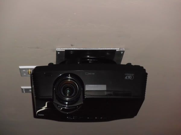

For a 8 foot ceiling what is the highest I can mount the hc4000? Is there another comparable projector will a smaller offset?
Yes I meant 8 foot ceiling .. I'm trying to figure out how large of a screen I can get w/o having the picture too low
My sorry attempt at humor was to say the highest you can mount anything in a room with an 8 foot ceiling is...8 feet.
So, if you're really asking what's the lowest profile mount you can use + what's the distance from the top of the Mits to the center of the lens; that's about 6 1/4" for me. I have 7 1/2 foot ceilings. Using the Chief RPA mount (there may be slimmer ones), I'm throwing onto a 106" 16:9 screen that's mounted 20" from the ceiling.
Read and search this thread for a shipload of info. Look at the Mits calculator on their website for help, also.
For a 8' ceiling what is the highest I can mount the hc4000? Is there another comparable projector will a smaller offset?
$mokey,
I mounted my HC4000 about 3 inches from the ceiling to accommodate a 110" screen. I don't remember the specifics as far as the height of the screen above the floor etc. but I built the mount by cannibalizing a cheap monoprice mount and sliding it into a purpose made aluminum plate I attached to the ceiling. If you respond to this post I will take a few pics to show how I did it.
Doug

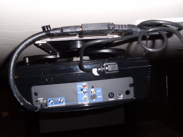

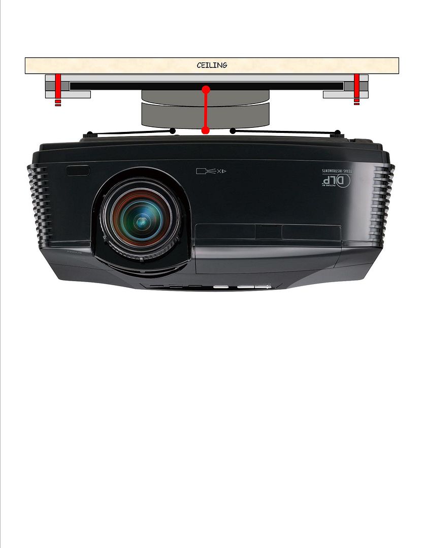

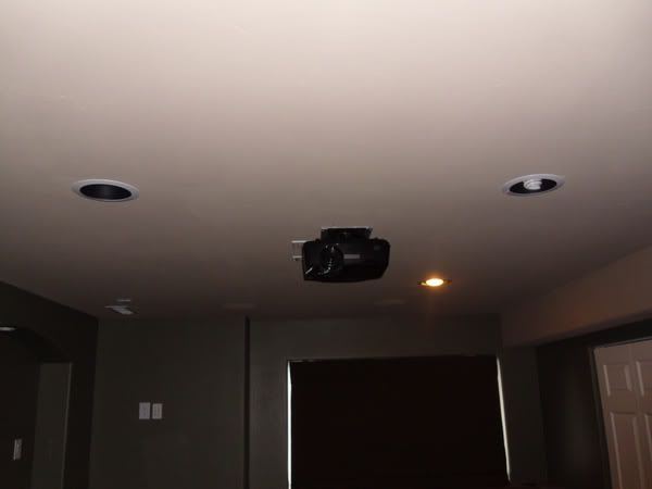

Originally Posted by boundermt View Post
$mokey,
Doug
You should post the lens center to ceiling distance for him.
$mokey: The only way to get the PJ closest to the ceiling is to mount it upside down on a shelf and not use a typical ceiling mount. If not near the back wall, you could build a platform, say a ply bottom with 4 adjustable poles at each corner. With this you could probably get the lens center to around 3.5-4" from the ceiling.
fleaman is offline
post #2363 of 2867 Old 02-26-2012, 10:56 AM
boundermt's Avatar
Posts: 25
Good advice...
Ceiling to center of lens = 5.25 inches.
Here are a couple of pics that show the basic mount I made. It will be painted black one of these days... you cannot see the mount while in the room...
boundermt is offline
