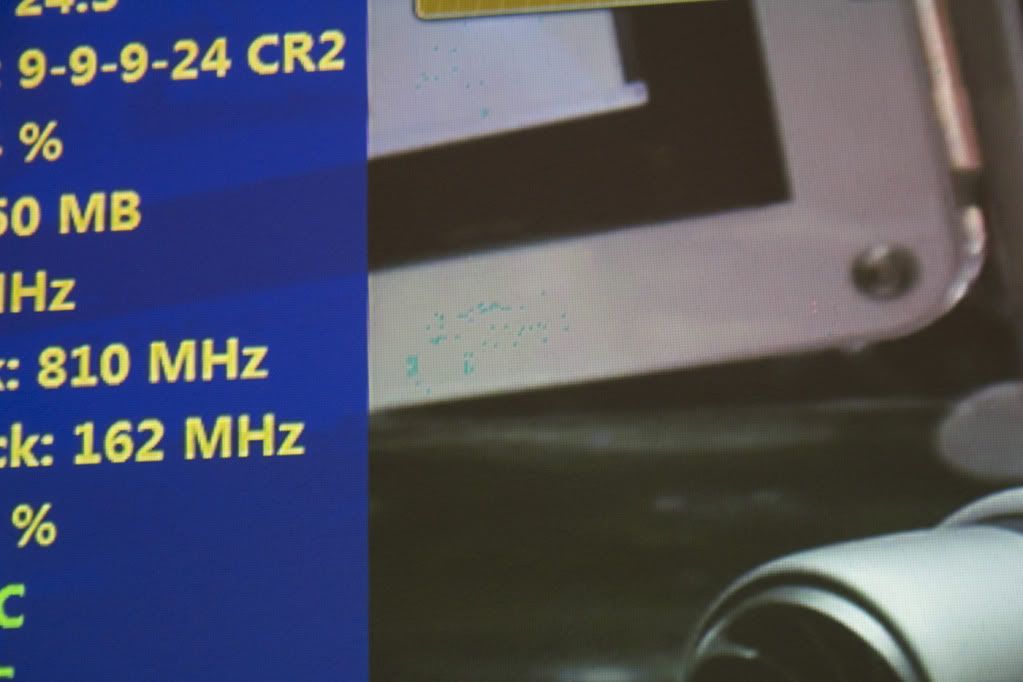

Ok. So... This is gonna be a short out of the box impression, i'll post a longer update when I have the time.
WOW... PQ wise, it's so much better and brighter than the HD20, it's definitely worth the extra $100. I've always found the HD20 to be a bit dim and always out of focus. The BenQ with the larger aperture lens does not have that problem
However, there's 1 big potential problem though. I'm using a 50 ft HDMI cable to link my desktop computer to my PJ.
There are these random red dots flickering around some scenes, and it's really annoying.
I don't know if it's the PJ's lack of ability to handle a weak signal or what, but the HD20, nor did my Samsung flat screen had this problem.
Now I might try to use a shorter, say 25 ft cable and see if the problem persists.
Or is it just that I have a defective unit?
Other than that, I'm pretty much satisfied with my first PJ.

ok so while the 25ft yield less "red dots"... it still has a significant amount of it.
anyone know the cause of this?
blue dots...? wt the?
I'm leaning towards that i've received a defective model?

That's what I'm saying. is BenQ's panel simply worse than Optoma's? cuz I thought since HDMI is digital, length don't really matter as long as the panel's good enough to receive the signals.
---edit---
ok so here's what becomes weirder..
i have a pc, a ps3/xbox hooked up to a a/v receiver, 1 25ft, 1 50 ft.
When I pair 50ft with PC, weird flickering red dots appear.
When I pair 50ft with PS3 & receiver, image jumps up and down, no flickering dots but no sound (see below)
When I pair 25ft with PC, less dot, but image would start jumping up and down too
When I pair 25ft with PS3 & receiver, perfect image, no sound (see below)
I was asking about a way to disable onboard speakers cuz... whenever I pair it with the PS3/AV receiver, no audio'd come out thru the home theater, and sound is not coming out from the pj either.
when i go into the sound settings on the ps3, it reads HDMI audio not available.
Now mind u if the same setup (ps3/av receiver) is paired with my monitor/flat screen, audio'd pass out to the home theater.
(I have already disabled hdmi audio output on the receiver)
Now I'm getting REALLY frustrated since the HD20 has none of this problems... the BenQ has really a much brighter and sharper image, but with problems like these, i might as well try the epson 8350 or the mitsu hc4000
also another problem i ran into is the pj even in economic mode is still a tad bit too bright for a relatively dark room... image does pop, but your eyes WOULD hurt a little after watching a 3 hr movie.
anyway, anyone who could help me with the situation in any way is much appreciated. the benq hotline didn't really give me anything useful.
dezau is offline

alright guys, problem just got weirder again.
red dots are gone.
but ps3 + a/v still no sound.
then again.. xbox + a/v has audio... wtf?
sth wrong with the ps3?
but ps3 + a/v works with monitor/tv.
so... urghhhh??
red dots are gone.
so... urghhhh??
I really don't know what's going with your setup. I don't have any of problems you have. I am posting my setup. Maybe it can be of some help.
My W1100 is placed on a dresser every viewing and stored away afterward.
I connect a Panasonic BDT210 bluray to a Denon receiver to the W1100
HDMI cable from bluray to receiver is 3ft long. HDMI cable from receiver to W1100 is 6ft long.
My receiver has an option to send HDMI audio to speakers or to the display. I chose the speakers option. No sound is coming out of the W1100 speakers.
As for the W1100 being too bright, you can always adjust the brightness or choose a mode that is not so bright. Or wait until the projector has about 300hrs on it.
Oh, here is a picture of my bedroom setup. You don't have to have a dedicated theater to enjoy the projector experience.

dezau,
The red and green dots are due to your hdmi cable. I also have a 50ft hdmi run and had to go through five different cables before I found one that worked. I found that the thicker the cable the less dots in general. Microcenter (if you have one near you) has some good 50ft hdmi cables at good prices (make sure you get the thickest one).
As for the audio, this is a receiver issue in how it passes through audio information to the source (some receivers pass the audio porperties of the projector and some pass the audio properties of the receiver -- it can vary for different resolutions). Make sure your receiver has the latest firmware and is set up correctly for passthru -- in your case you only want vidoe passthru).
