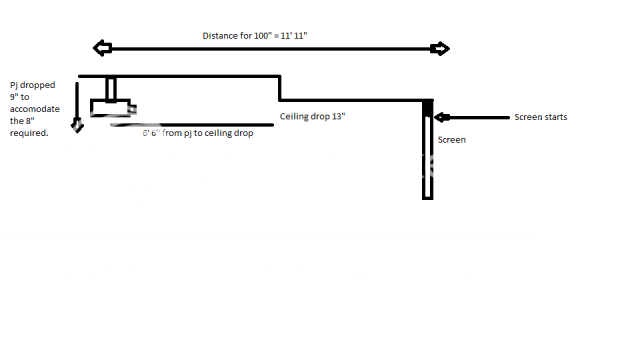

Been reading this thread since last night. I was pointed to this forum from another member on another forum. I bought this projector from Amazon and received $100 amazon card for the purchase. I have been doing research for the past week or so and decided on this one to keep my budget down and the reviews were just as good as some $200+.
Anyways, I have a question to my setup. I will be mounting this from the ceiling and I am using this site http://www.projectorcentral.com/Opto...o.htm?add=7723 to get my specs.
I got an elite electric 100" screen black case http://www.amazon.com/gp/product/B00...?ie=UTF8&psc=1.
To get 100" i need to hang the projector 11' 11" with an 8" drop, that's not a problem. However about 6' 6" in front of where I have to mount the pj, I have a 13" drop in my ceiling due to ducting.
So where i am mounting the screen would be on this drop as far back as it can go. Now I figure with the screen I should get about 4" of drop before the actual screen (this is taking into consideration the part where the screen roll up into and the couple inches of empty space before the screen), following me?, hope so. Ok so now to my screen there will be 17" drop from where the pj will be, I can extend the mount down 9" and that would put me 8" above the screen. Will the ceiling drop obstruct the pj?
maybe ms paint will work.....

Mount the projector and turn it on before mounting the screen, then you know.

I will. But reading on the screen, it says 10" of black space and my ceiling mount starts at 16". Obviously I didn't read very well lol. Anyways I think it'll work out perfect if not I can always drop the screen a bit but the pj will drop past the 13" dropped ceiling.
Yep, you'll be fine.
