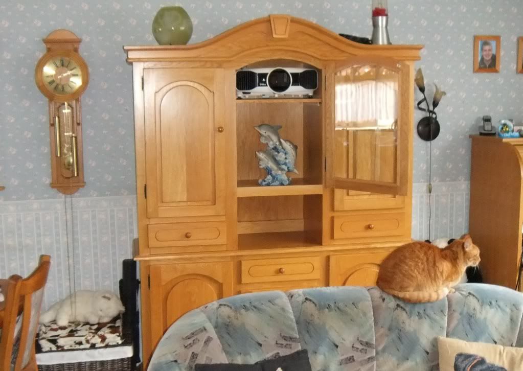

post #1662 of 3654 Old 04-21-2012, 06:35 AM
Matthieu's Avatar
Posts: 129
I'm finished with reading the whole topic YES.
I have a TW9000W (6010) White and Wireless.
I bought it in November 2011 and have Fiwmware 100
I'm on the 325 Hours on the Lamp.
Like always's my projector worked very good till I started reading this forum haha.
* About Airblowing:
Twice I had the projector Blowing air , and after a minute or so it turned on in silence.
I thought it was because the projector needed fresh air.
I have the projector standing in a closed closet, 1 meter (3Ft.) behind us in the livingroom.
When we go watch a movie, we open the closet door and lower the electrical screen.
I have two screens, 1 White 120screen (which wont work well in my livingroom, because of the white ceiling and floor, and light blue walls) and 1 HC lightgrey 106screen. (which works icredible well, and gives the picture a Plasmalook)
~ I'll keep my eye on the projectors air blowing issue now, after reading this here.

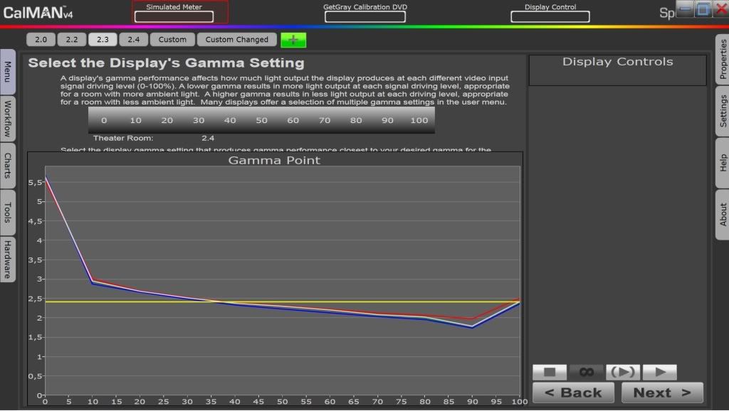

I do have an issue with calibrating this projector, and I'm hoping some of you can help me out.
I use Calman 4 and a Eye One Pro.
With a new lamp I calibrated the Natural mode, and it was pretty good.
Now, after 325 hours on the lamp, I cannot get the Primary's in place.
The Grey scale is perfect and Gamma is straight.
Watching the picture, the colors are not good for me.
Now I calibrated the Cinema mode.
The colors were death-on the triangle of Primary colors and secondary colors.
The dots right in the middle even zooming in on the triangle with Auto Zoom anabled.
The Grayscale is perfectly straight.
The colors look amazing.
(You'll never NEVER get this so good with a Calibration DVD alone.
I did use the DVE Blu-Ray in the first few hours of the lamp, and watched a few movies with that calibration in natural mode of course.
Yes, it is far better using a disk than leave it without tuning at all.
But the difference is incredible after a real calibration.
If you spend so much after for a projector, I would definitely let it calibrate by a pro, if you cannot do it yourself)
Now my problem:
Looking at the Gamma, it looks like this: \\
It only hits the target of 2.4 at the 35 IRE
I think the problem is, that we cannot choose the Gamma Color in any other mode except for Naturalmode.
Now, I tried to play with the custom Gammasetting but I have to place the slides/pointers so incredible stupid to see some good changes, but never right.
Can someone tell me how to get good Gamma on a Non Natural mode, please?
Here's a picture of my Gamma, which is the best I could get.

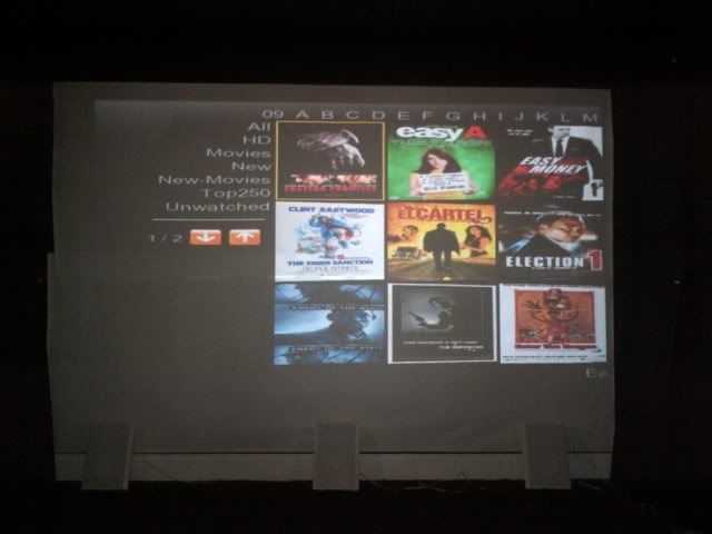

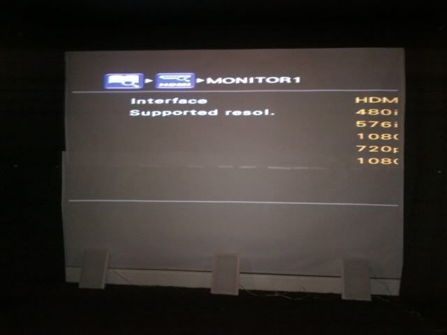

Guys, I am having some trouble with my 5010 (68 total hours on it)
Today when I turned it on, the video is displaying improperly - almost like it is stretching and only displaying the upper left quadrant of the normal picture.
Pics below - ignore the flash, crappy camera phone, temporary paper screen and the uninstalled speakers.
It also is occurring regardless of the hdmi input that I use. It does not occur when I use composite input. I did not try any other inputs.
My normal output setting is 1080p 24hz to the 5010. I tried some other resolutions and still had the problem.
Thanks for any advice.
Have you been watching any 3D content and left it in Side by Side mode after you've switched back to 2D? It will produce a similar image to yours if you have. Just check your 3D settings in the menu and make sure it's not set to Side by Side or another 3D setting
Yes, like plasma novice said, change your 3d settings back to Auto from side by side.
HAHAHA... dude. Thanks so much. That was so frustrating. Regardless of what setting the 3D was on, I don't know why it would have had any impact on 2D viewing if 3D was not active. Thanks again.
I do have an issue with calibrating this projector, .
Now my problem:
I know projector reviews mentioned an issue with the gamma when calibrating, not sure what if any information this may help you?
http://www.projectorreviews.com/epso...alibration.php http://www.projectorreviews.com/epso...erformance.php
Thsnk you for that.
I did read this a long time ago and forgot about it.
I think I have the exact same problem, and I'll hope it has something to do with the firmware.
Tuesday I will calibrate my projector again, and expecting great difference.
If not I'm going to send my unit back, since Art got a second unit send to him because of this.
Matthieu is offline
