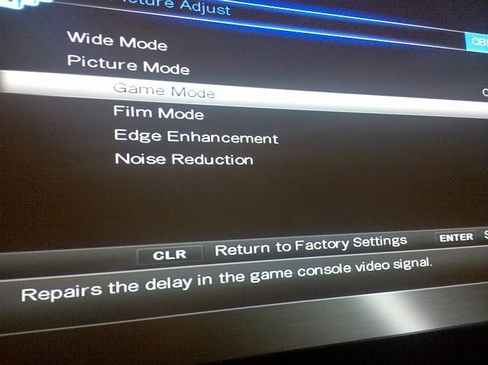

You guys say you want a scientific test and then ask that I test it with a rock band 3 guitar???? Hilarious.... All I can say is that it is improved running though the onkyo reciever vs. hdmi stright from xbox/pc to projector. The lag with a xbox to projector is horrendous. Through the onkyo with game mode enabled is very playable. I guess I was off base by saying reduced to 20ms. I stated in my original post I had no way to measure this. I do know the lag is greatly reduced. If someone will inform me of a way to test this I will be glad to do so.
Check out this image
AndyPrice44 is offline

Listen, I know you guys know alot more about this than I do. I get that. I don't know why this is working but, it is better. I agree it makes no sense that if you add something to a signal path that it could help reduce lag in any way. It SHOULD only delay it more but, it doesn't. I don't know how to explain it any better. Someone tell me how to setup a test and I will do it.

At first I thought he was nuts. But the text below his image reads:
"Repairs the delay in the game console video signal"
Voodoo? No idea, but the ONKYO states that the feature does exactly what he is saying he experiences. Removes the delay. (WTF!)

According to the manual of the Onkyo receiver you have, the Game Mode will reduce "video signal delay" but when doing this "the picture quality will become poor." Is "video signal delay" the same as input lag? It sounds like something different.
http://www.manualowl.com/m/Onkyo/TX-...220697?page=55

I believe it's just another name but is in fact the same thing.

post #266 of 330 Old 02-23-2012, 09:35 PM
AndyPrice44's Avatar
Posts: 16
After reading that in the manual, it sort of leads you to believe that after you turn the game mode on the image becomes ****. I have seen no loss in image quality here. Running 1080P PC games looks great. I am using a computer with 2 gtx 580's in SLI. Setting all games to maximum graphics and the projected image and my gaming monitor are almost identical.
Fellows, here's what must be going on. Andy's receiver would normally be doing its own video processing, adding to the total input lag.
Thus his description of it being "horrendous".
Setting the Onkyo to "Game Mode" simply removes that additional lag, and he sees just the usual Epson input lag, which by comparison, must look pretty good to him.
Count on it. This is the only explanation that makes any sense.
