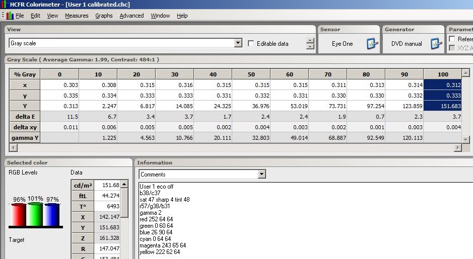

I've now got about 150 hours on the projector and I tweaked the Dark Room calibration I previously posted.
Yes it is difficult using this mode, but I like the idea of having something that has Eco on by default.
Anyway, it's not perfect, but I like the picture from it. I purposely set the color temp above D65 as i was getting a reddish tint. You could move red to 56 or 57 to lower the color temperature.
[IMG][/IMG]
[IMG][/IMG]
[IMG][/IMG]
I haven't had much luck getting red closer to the default color gamut. I can move it toward magenta, but as soon as I increase saturation, it reverts back to its original setting.

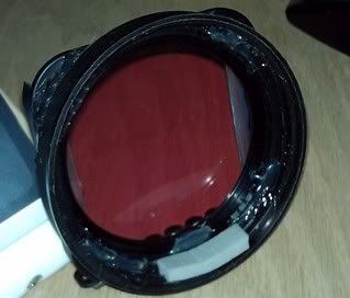

I've been working on a calibration for a red color compensating filter. It does two things-- moves red more to a true red and away from an orange red and acts as a neutral density filter, but doesn't reduce light equally across the spectrum which is an advantage over a nd filter.
I think the picture is an improvement, especially if you're looking to reduce the light output of the projector. The dark room setting with only the cc30r filter outputs about 17 fL on my 100" screen and about 20 fL using User 1.
It doesn't turn those dark scenes into black, but it does make them better, IMO.
If anyone is adventurous and wants to try it, I'll be posting the calibrations for the filter shortly. B&H photo is the only place I've found the filter and it's a special order item so it takes about 2 weeks to get it. It costs $19 so depending on the shipping you choose, you're not out a lot of money.
http://www.bhphotovideo.com/c/produc...Red_CC30R.html
I also made an attachment using a hot glue gun and this filter holder which was $5. The ring is a lid from a nut jar which I cut out the center using an xacto knife:
http://www.bhphotovideo.com/c/produc..._Requires.html
[IMG][/IMG]
This will reduce light approx 2/3 of a stop, so it isn't for anyone that needs all the light the projector throws.
bse53 is offline

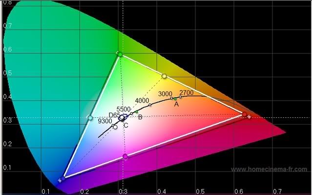

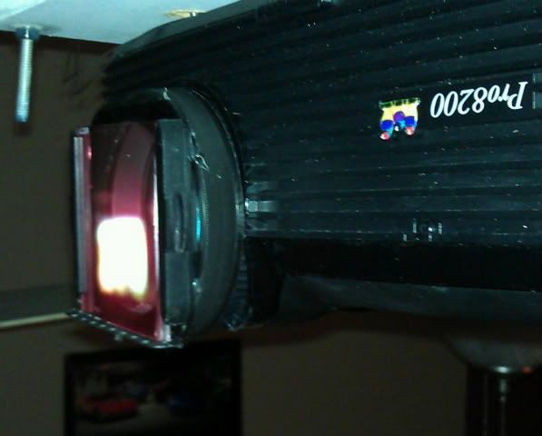

OK, here are some settings for using a CC30R filter.
The object of this is to reduce the amount of light reaching the screen with an added benefit of improving black level.
This is not a good idea to use if you're using the projector in a situation with ambient light. In my case, the room is completely light controlled, and the walls and ceilings at the screen are painted near black.
To improve the black levels before using this filter, I would:
1. control ambient light
2. paint the walls and ceilings a dark neutral color
3. control the light leakage from the projector's louvered openings (I hung black cloth near those openings to absorb the light.
The CC filter (or a ND filter) is reducing the light leakage from the lens reaching the screen by reducing the total amount of light. In the case of the CC filter, it is reducing the green and blue light while passing red, while a ND filter reduces the light equally.
Anyway, I'm no expert on this, but I do like the results and it seems like the blacks are closer to black. I would try and take some pictures of the results, but taking a photograph of black is an exercise in futility.
The colors are very vivid, but then the projector throws a nice bright image as it is. These settings are using User 1 mode. I'll post the dark room settings later.
[IMG][/IMG]
[IMG][/IMG]

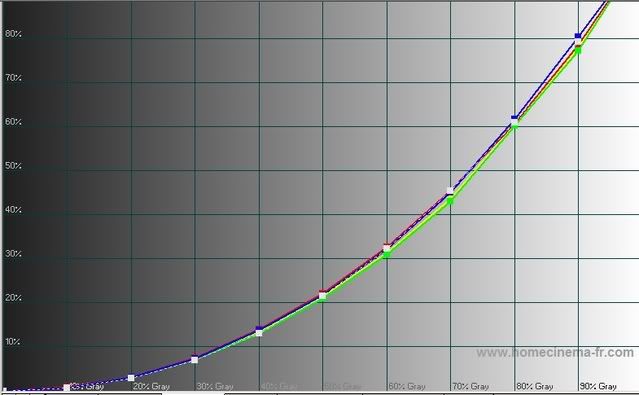

The gamma isn't exactly smooth. You might try the gamma 3 setting.

Originally Posted by KingRenz View Post
My pro8200 is brand new, should I still calibrate or wait?
It depends on what you mean by calibrate. By all means use a disc and set the contrast and brightness and you can try out some of the calibrations in this thread, but I wouldn't get too hung up on it for the first 100 hours or so. The lamp is going to change over time.
bse53 is offline
OK...so I used the settings from this post and everything looks great except dark levels...they look a lot better but how can I get more detail from dark scenes. The PJ is hooked up via HDMI to an Xbox360 and also my cable box Explorer 8642HDC. I do have the PJ and Xbox360 set to RGB but I don't have that setting for the cable box. The screen is a M100UWH Elite Screen 12-14 ft away. The room is light controlled. Roughly 1200 hrs on the lamp
irishgond is offline
