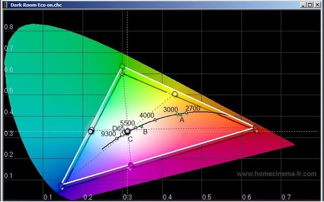

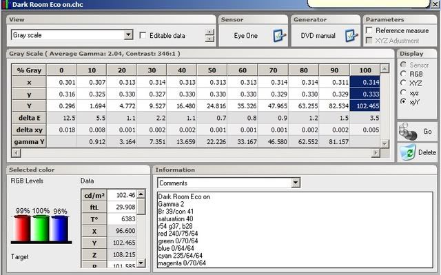

]I've been working on calibrations using the CC40R filter, since it has the benefit of increasing apparent blacks, while lowering luminance and correcting the red deficiency.
I haven't posted any calibrations until I got the grayscale issues settled and it turned out to be my dvd settings, not the projector.
Anyway, since my projector is in a completely light controlled room I need to cut overall luminance, especially for movies, so here's some settings for the Dark Room mode, with eco on.
The screen is 100", throw is about 12'6". Whether you can use these settings will depend on how on light controlled the room is, since this projector throws quite a bit of uncontrolled light.
Here's the data screen:
[IMG][/IMG]
Settings are in the comments on the first screen.
Here's the RGB graph:
[IMG][/IMG]
Here's the color temp graph:
[IMG][/IMG]
Here's the color gamut:
Whoops, the yellow setting is missing in the first screen. It's 0/64/64.
As you can see, it's about 29 ft-l on a 100" screen or approx. 700 lumens.
Add a 1 stop nd filter and you'd have 14 f-l, just about right for movies in a completely light controlled room-- but as I have hinted, using a.5 stop nd filter and the cc40R will give you better blacks and bring the lumens to about the right amount for a 100-108" screen.
I think it looks pretty good. As Coderguy has said, it's kind of tedious, since there is only one setting to adjust colors, not low and high settings like you'd find on more adjustable projectors. But at the end, the overall range is fairly close.
You're mileage may vary.

I agree 100%. I'm going to work on the dark room mode and redo the color gamut. I ended up using a rather convoluted process to get where it is, and I going to try another method I read about.
I've ordered a new color filter and a .3 f-stop nd filter and a multi-filter holder to try my idea of using a cc filter to both reduce lumens and add some red to the image. Total cost at this point $33.
The color gamut settings apply across modes, so getting that close-- bringing the secondaries in line with the primaries shouldn't drift as the color temperature is adjusted for each mode.
Everything I've tried so far is with eco on. I think the added bulb life and reduced light output is important, since the projector has plenty of light output and there is way too much stray light coming from the projector.
I bought some black fabric and tacked it up on the ceiling right in front of the projector and to the exhaust side, since there is quite a bit of light there. When I painted my room, I painted the screen wall and only the first 6' of the ceiling and side walls charcoal- since that's where the strongest reflections are. The rest of the ceiling is white, and I probably should darken it-- but that means scraping off the popcorn ceiling, which is a really messy task.
Anyway, even though the CMS is somewhat limited, I think you can get a pretty good looking image-- the real limitation and what I think is causing the somewhat gray deep blacks is the stray light. Still very watchable and better than or at least equal to the higher end previous generation projectors (at least my old pjtx100.

I input your values and ran HCFR. Here are the results. The picture looked pretty good, though skintones were toward the green, as my results show.
