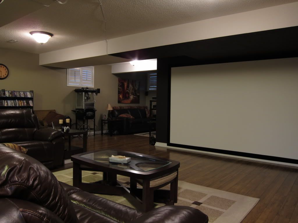

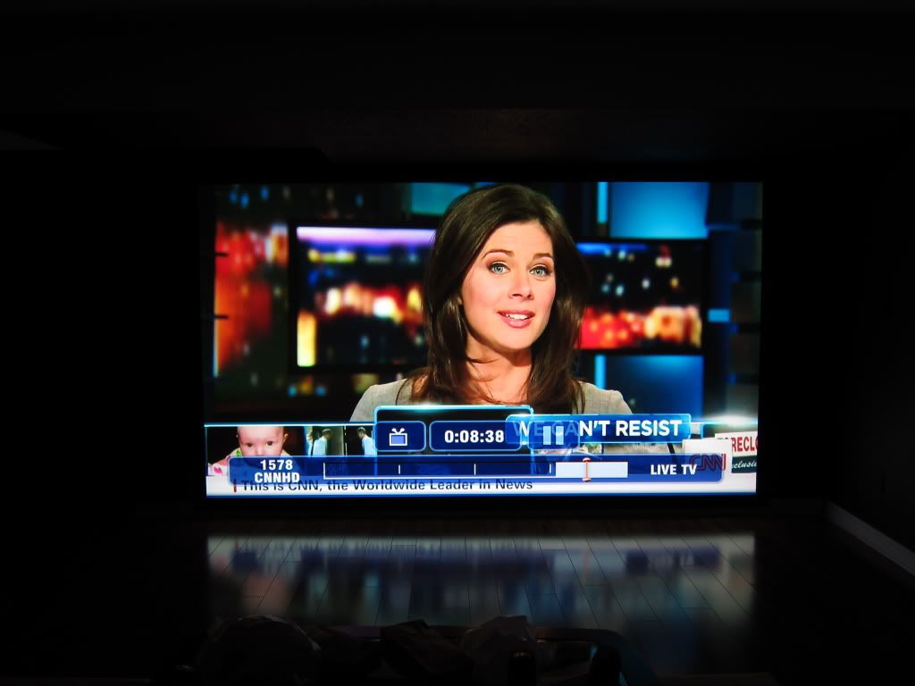

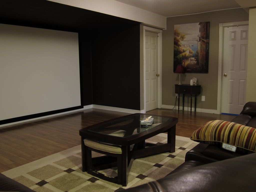

I have an Epson 8500Ub projected onto a Seymour A/T screen at 153" and sit 14-15' from the screen. The Seymour is 1.2??????? gain.
I believe the 5010 is brighter than the 8500Ub. Don't let others tell you it's too big........it's not.
To give perspective, I'm 6'4" and weigh 270Lb
This is by far my favorite investment I've done to my home and I still smile.....every time I watch something.
I would highly recommend an A/T screen if you can swing it. Seymour screens are not that expensive (especially if you buy the seymour xD material and build the screen yourself.....like I did) and having the speakers behind the screen where they should be.......awesome! Having all three front speakers the same make for a really smooth sounding front stage.
I started off with a 130" screen because others were warning me about pushing the projector to its limit. After seeing how nice it looked at 130" I took the plunge, and further warnings, and built my now 153" screen and couldn't be happier.
Of course this is only my opinion. I am by no means an expert......I'm just an enthusiast. Oh yea I forgot, my wife was not very happy with my ambitions and rolled her eyes at every stage..........but when everything was completed, she loves our projector and our room as much as I do....maybe more. The only down side to this is............ now I have to watch Greys Anatomy and CSI and all that crap. I guess it turned out bitter sweet.
That looks great!
I like how you painted that area black! Really helps with reflections a lot better then I thought!
Whats A/T Screen? T=Tensioned?
Thank you very much for the photos.... btw, how far back are you projecting?

Thanks. It's actually a brown colour but yea it helps with the contrast and light leakage (reflections).
There is some reflection from the hardwood though but it doesn't really bother me nor anyone else watching.
A/T is 'acoustically transparent'. Having an acoustically transparent screen is absolutely AMAZING! Highly recommended. Seymour AV have very reasonably priced screens and they are an excellent company to deal with; Chris is awesome. I built my screen myself and I think I paid somewhere around $300 for the material shipped and built my screen wall (including the Seymore xD material) for under a grand. That wall that the screen is on is the screen wall that I'm talking about. It's actually a false wall built 3-4' out from the back wall (framed like a giant window) so the speakers can go behind the acoustically transparent screen and the brown wall is actually fabric wrapped around the framing......sorry, I'm rambling on.
http://seymourav.com/
My projector is 15' from the screen, same as the seating area. The projector is ceiling mounted above the couch......and no the fan isn't very noticeable.

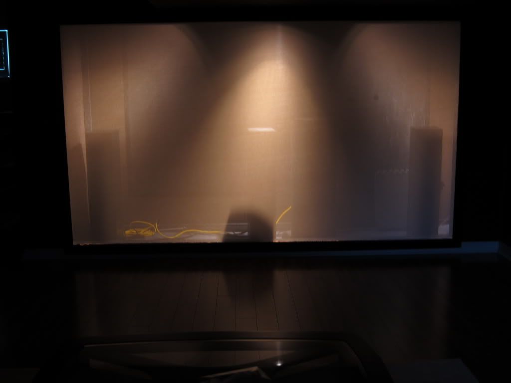

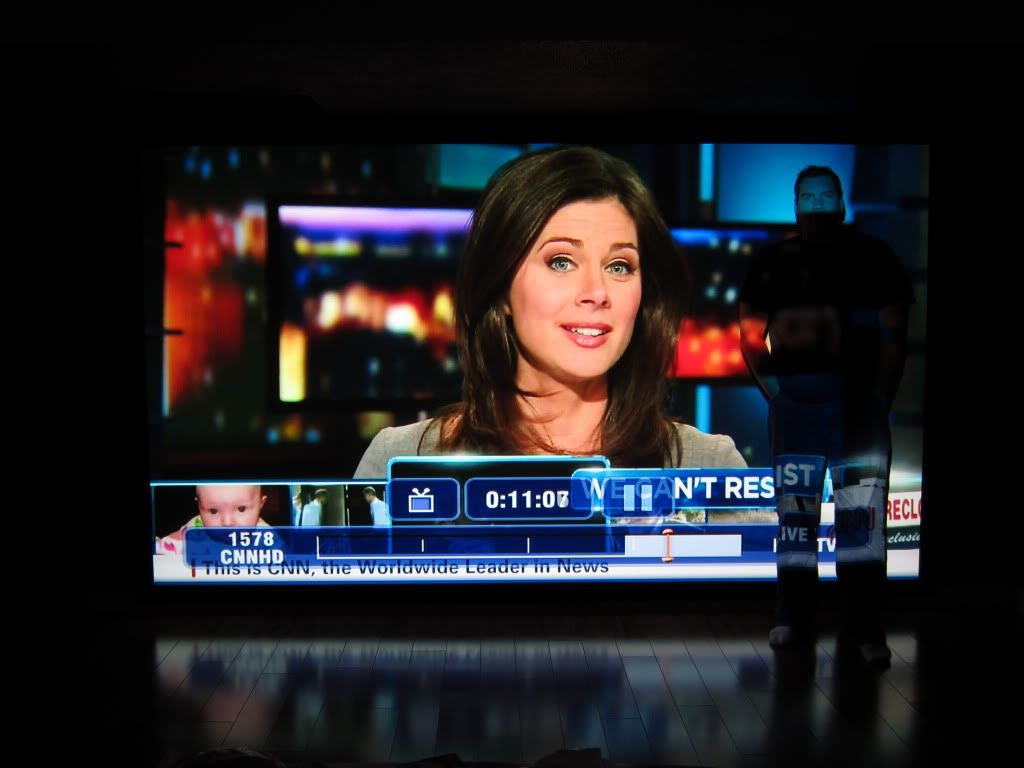

Here's a picture of the screen back-lit. I've cleaned up behind the screen since I took the pictures and it now looks really cool.
You can see my old 130" screen painted black on the back wall.

Very "Total immersion".capable. Big can be better if done correctly. And you had an advantage many just don't have with that "hidden room" behind. Shucks, you almost could have gone Rear projection back there!
But that Floor is getting in the way of perfection! The Black Shadowboxed area is 75% there...but the very proximity of the bottom of the screen to that glossy floor kinda give you another screen. A Black or Dark Brown Throw Rug, Anti-Skid type, and viola....no vestige of being in a room, in the Dark.
Bonus: Improved Contrast on screen during brighter content.
Should be an easy thing to test out a justify. Just smooch a dark Blanket under the screen and let "The Boss" see the difference. Funny how after the Wives come on Board, they gain official "First Mate" status. (...if indeed not Captain when they have something to watch... )
So basically, that's it. The rest is a great example of DIY Right. The Seymour material is an excellent alternative to the pricier Stewart / SMX offerings, and virtually performs just as good in every aspect....for less......and you went "Jetson's Wall TV" size.
What not to love?
