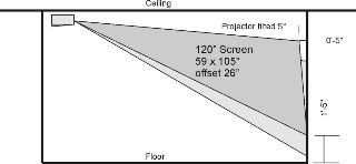

post #16 of 23 Old 03-22-2012, 10:44 AM
bse53's Avatar
Location: Moses Lake, WA
Posts: 337
Originally Posted by DrNegative View Post
With the Viewsonic's steep 33% offset, it will be difficult to go with larger screen sizes with an 8' ceiling. Keystone would almost be unavoidable on many.
Here's a way to get the mount to about 1-1/2" to 2". Take two pieces of particle board or plywood, approximately 18-20" wide and the depth of the projector. Drill four 1/4" holes on the corner and mount carriage bolts to one of the pieces of wood using a nut to secure it. Screw that board to the ceiling with four drywall screws, attaching it to the rafters or bottom chord of the truss. If the placement of the projector is between joists or the joists run the wrong way, use to strips of wood to the joist. Then screw the plywood to those strips.
Mount the projector to the other plywood, drilling three holes that line up with the projector mounts (which I believe are 5 mm). Make these holes oversize and use a fender washer (that way you can make minor alignment adjustments to the projector after it's mounted). Snugly fasten the projector to the wood, but not so tight you can't move it around.
Then just fasten that board using the protruding carriage bolts. You can adjust the board to be perpendicular to the screen.
Pretty simple and very adjustable.
[IMG][/IMG]
You are right though that the offset does pose a problem in a room with an 8' or shorter ceiling height. The offset of the Viewsonic is the same as the HC4000 and several other projectors.
bse53 is offline

With a 8ft cieling and about 12ft to work with whats the biggest screen can I go with? Does keystoning mess up the image?
kingme425 is offline
post #18 of 23 Old 03-22-2012, 01:35 PM
bse53's Avatar
Posts: 337
The limitation to the screen size is 14' dimension of the room.
Using the mount that I described which places the projector very close to the ceiling you could use a 120" screen. The offset would be approx. 26" and it would put the bottom of the screen at the floor.
Tilt the projector up 5° and tilt the screen out 4" and you would raise the bottom of the screen approx. 1.5' from the floor without using keystone.
[IMG][/IMG]
bse53 is offline

post #21 of 23 Old 03-22-2012, 02:49 PM
bse53's Avatar
Posts: 337
Originally Posted by kingme425 View Post
Serious thanks so much for all the help, Now i know I could use a 120" screen, but from 8-9ft viewing distance what is the recommended screen size you would recommend? Also I was gonna purchase a electric screen that went up and down, can you angle those??
You would have to use a rigid screen to angle it like that. Practically, the bottom of a 100" screen would be approx. 2' off the floor, assuming you used a mount something like I drew.
A 110" screen would be about 1.5' off the floor.
IMO, both those are too close to the ground, but then I use a recliner when using the projector. I prefer to be looking slightly up.
The measurements I used assume only 2" between the bottom of the projector and ceiling. A normal mount would increase that by 6" or so and move the bottom of the screen down by that amount.
bse53 is offline
