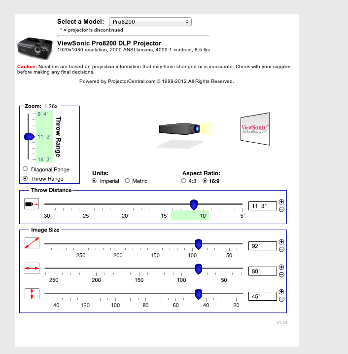

Ok so I used the calculator linked below after my above post and punched in 16:9 92" screen with the PRO8200 and it gave me a throw range of 11'3".... so what exactly does that mean? That I need to mount the projector at 11'3" for a 92" screen or is that the minimum distance required for the projector to output a 92" screen?
http://www.viewsonic.com/viewschool/...ce-calculator/

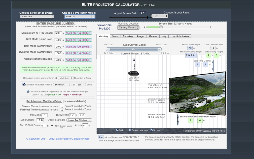

I think you entered one of the numbers incorrectly (you probably entered width instead of diag size). For a 92" screen, that calculator and the calculator I programmed in my signature agree within a couple inches.
It is the minimum distance from the projector's lens to the screen.
For a 92" screen, the minimum mounting distance is 9 feet 6 inches from the screen to the projector's lens (could be 9 feet 4 inches, but I measured it myself and play it safe on the numbers). The mounting bracket would be drilled a few inches back from that. However, I would mount it as far back to the wall as you can go. Since the Viewsonic fans are on the side, you don't need much room behind the projector, only 2-4 inches or so for the cables. I'd say mount it 4 inches from the back of the projector to the wall to be safe, but the actual mounting bracket would be drilled a few inches forward from the back of the projector since the mount generally goes in the middle of the projector (there are exact measurements in one of the VS manuals if you need it, or just measure the holes yourself when you get the mount and the PJ).

Thanks again for the post but Im getting conflicting info from the two calculators now. The calculator in your sig is saying 9'4". The Viewsonic one is still giving me 11'4".
I put in 92" diagonally on both for 16:9 screen.... what gives? Perhaps I am reading the output from the calculator's incorrectly ?
Either way I guess its not that big of an issue now that I understand what exactly throw distance is. I will leave 4-6 inches behind the projector from the back wall and just ceiling mount it there.

Yeah, you're reading it wrong. The viewsonic is giving you a range. The shortest throw is 9' 4". Coderguy's calc is showing 9' 6".

I'm in a similar situation as well, but have a longer room to work with. That's why I'm highly considering the Viewsonic.
Projector Central has a calculator and also is giving a drop distance.
http://www.projectorcentral.com/View...ulator-pro.htm

Yeah I hear you. It can get confusing quick with projector choices out there. From what I can tell the Acer has only 1 year warranty in comparison to the 3 years of the Viewsonic and its rated about 1000 hours less on the lamp if this concerns you at all.
As for as better blacks... the Acer has a 1000:1 contrast rations whereas the Viewsonic is 4000:1... so the Viewsonic looks better on paper at least. Also the Viewsonic can zoom 1.5x (twice as much) whereas the Acer is only 1.2x.
Also don't quote me on it but Im pretty sure the 5 segment colour wheel on the Viewsonic is better then the Acer's... but again Im not sure.
Not putting the Acer down but on paper I think the Viewsonic is better. Might be a different story in real life.
